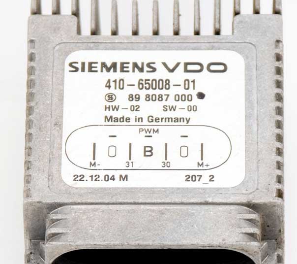

100 hz control. 600watt
http://www.frankencis.com/Forum/aft/32
Re: Output Current Limits
That looks identical to the GM fan controller.

Still think a decent SSR would do exactly the same...and that's probably all the Siemens unit is (but, crucially, it does have a heatsink!).
TimH wrote:Still think a decent SSR would do exactly the same...and that's probably all the Siemens unit is (but, crucially, it does have a heatsink!).
That unit may receive a 100Hz input signal, but fairly sure it will not be outputting a 100Hz signal.
That's probably a key difference

yes, i think it is around 15khz.
inside the unit has alot of capacitors/inductors/diodes etc etc. 3 or 4 big mosfets. when i get it il pop it apart to see.
