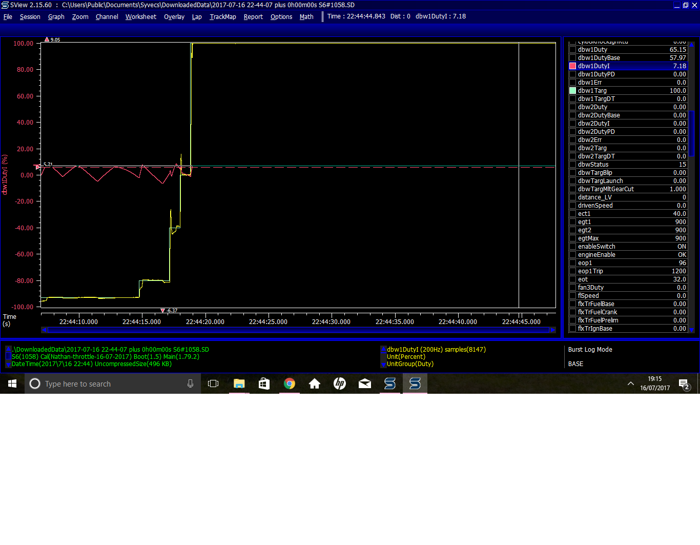

So I plugged in SCAL and watched the throttle position error readings. Slowly depressing I get 0-10%. If I rapidly depress I can get around 20% spike. It used to oscillate aswell, but reducing the kick open duty I got this down.

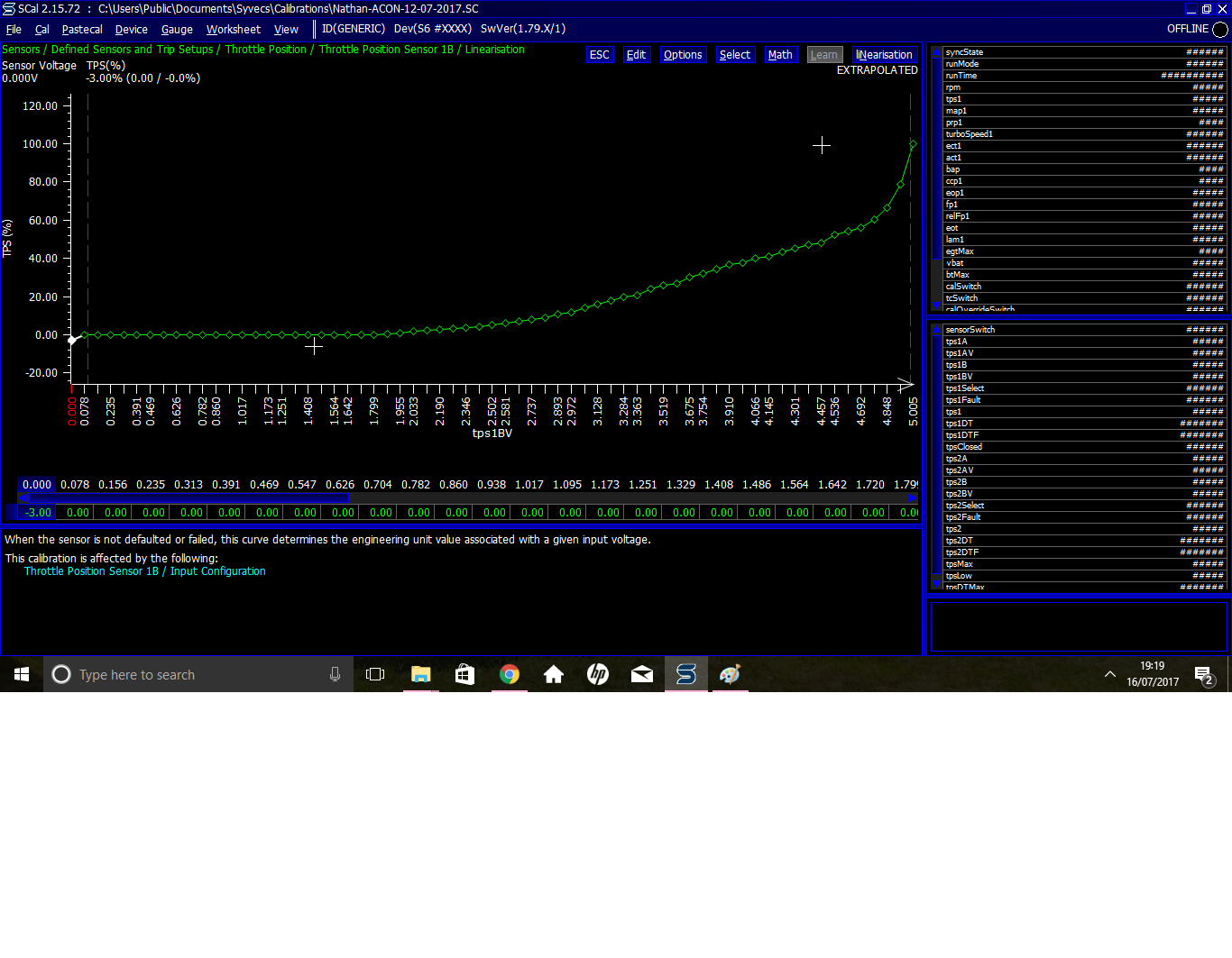

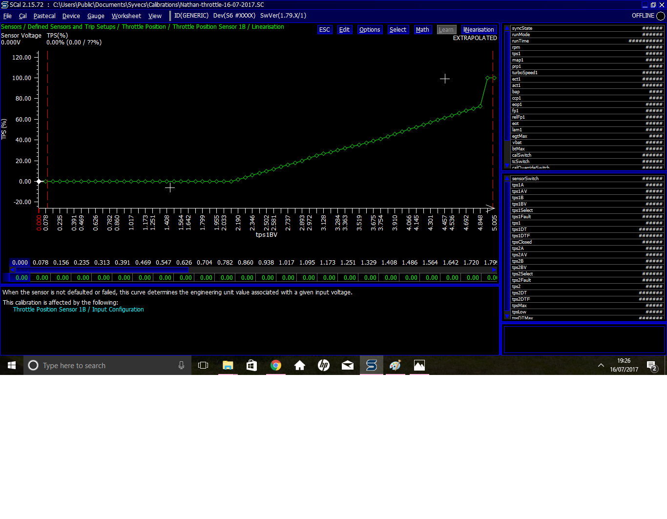

I followed the video as I went and found a few things that dont seem right. And ive attatched some of the before and after graphs. Ive stuck up a picture of tpsB which changest size by the largest amount.
This was the thottle steps after. And as bad as they are, so much better.

The settings you've shown there relate to blade position on only the second track.. Was this what you were calibrating ?
A/B validation should be a low value. You havent even shown A. Nor indeed what the pedal inputs are set like ( same process though )
The blade should have two tracks, both of these need calibrated, and pretty much at all times both should read identical % values ( this doesnt mean identical voltage values, hence you need to calibrate )
Some tracks may be linear, some may not
The fact the "before" graph was not linear would suggest either it was wrong, or that track on the blade sensor was indeed not linear and each point was calibrated manually.
Either way, do what needs to be done so the % value of both tracks for any given blade position read the same. That way A/B validation can be a low number.
Cant really see much worthwhile from a screenshot. But as long as DBWTarget and TPS are doing what they should be, then it should be fairly good. The video explains it all fairly well.

The Supra VVTI is another of the Toyota DBW throttles which should of been recalled. The internal design and also pot B output from the sensors was only useful up to 40%, above that there is no way to validate and hence the A/B Validation is ignored above that in the VVTI Base maps. After 40% tps it doesn't matter what you have in the linearisation.
