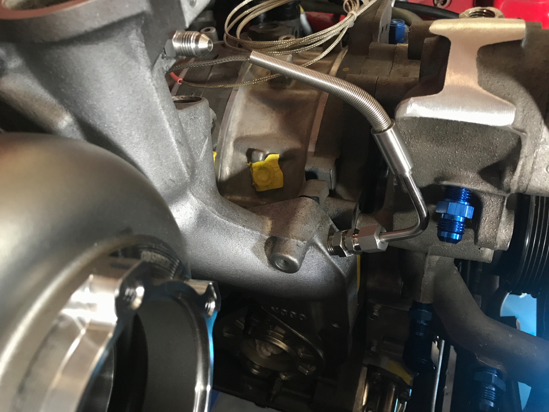

Need to put up some more real world long term reports on these, got a few who have recycled them from old turbo/manifold set ups over to new hardware, some even by mistake melted through the wires and simply cut out offending section and re spliced/insulated extension wire and they are good to go again :) the response on the probes is as posted before, we can read to a higher level of precision the actual EGT even in a super fast transient condition like 1st gear acceleration in a 4WD car. It opens up a world of per cylinder optimization and true high level durability of the sensor that you just cant get any other way especially comparing to inferior/fragile lambda probes for example.

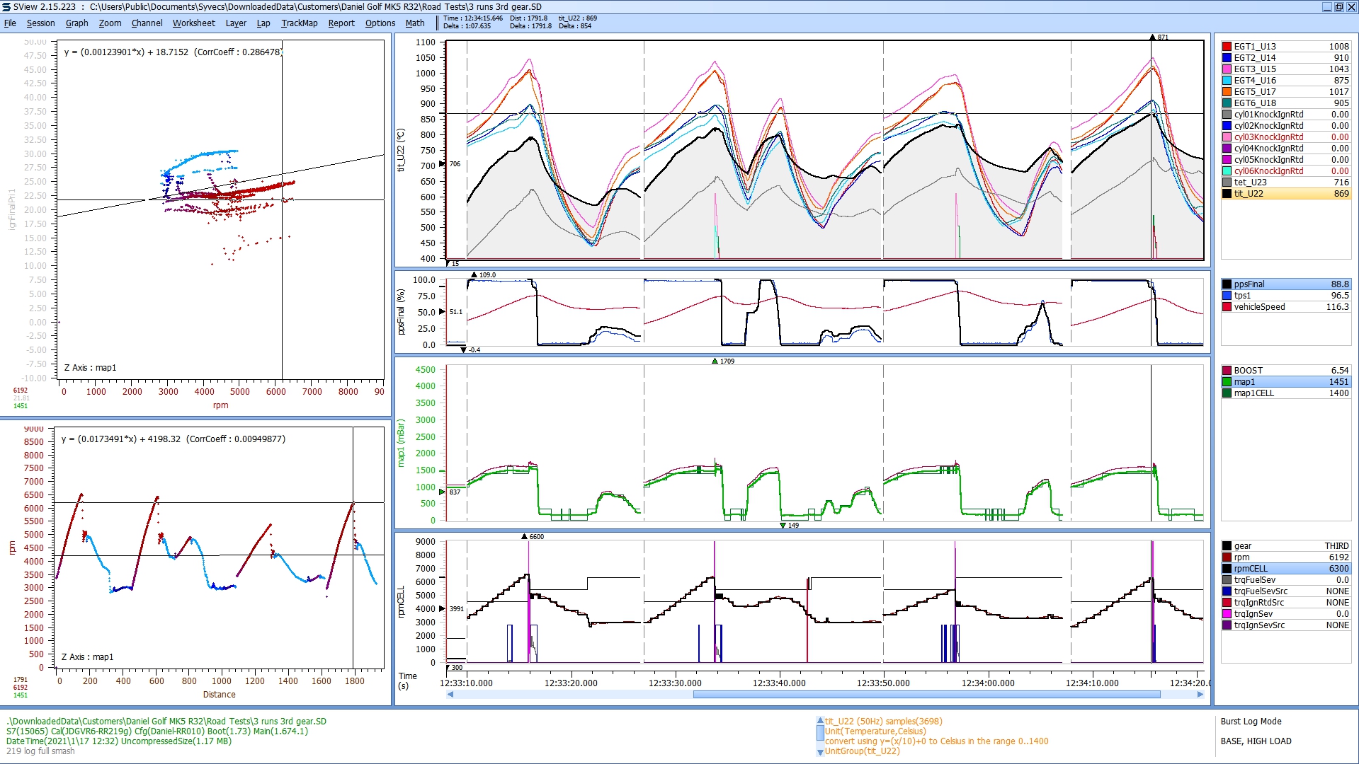

Here is an example
6 x donmega probes on each cylinder (VR6 engine) you can see effect of longer path in cylinder head how it effects readings).
Also it has the inferior previous suppliers 'fast acting open element' probes fitted to the turbine inlet and turbine exit just before where the oxygen sensors are mounted.
Picture tells it all, how good are your probes can you trust them? :lol:
A turbine inlet probe is effected allot by the heat sink effect of the housing/turbo as can be seen, the donmega probe for same rpm/load, will always return a much more realistic figures.

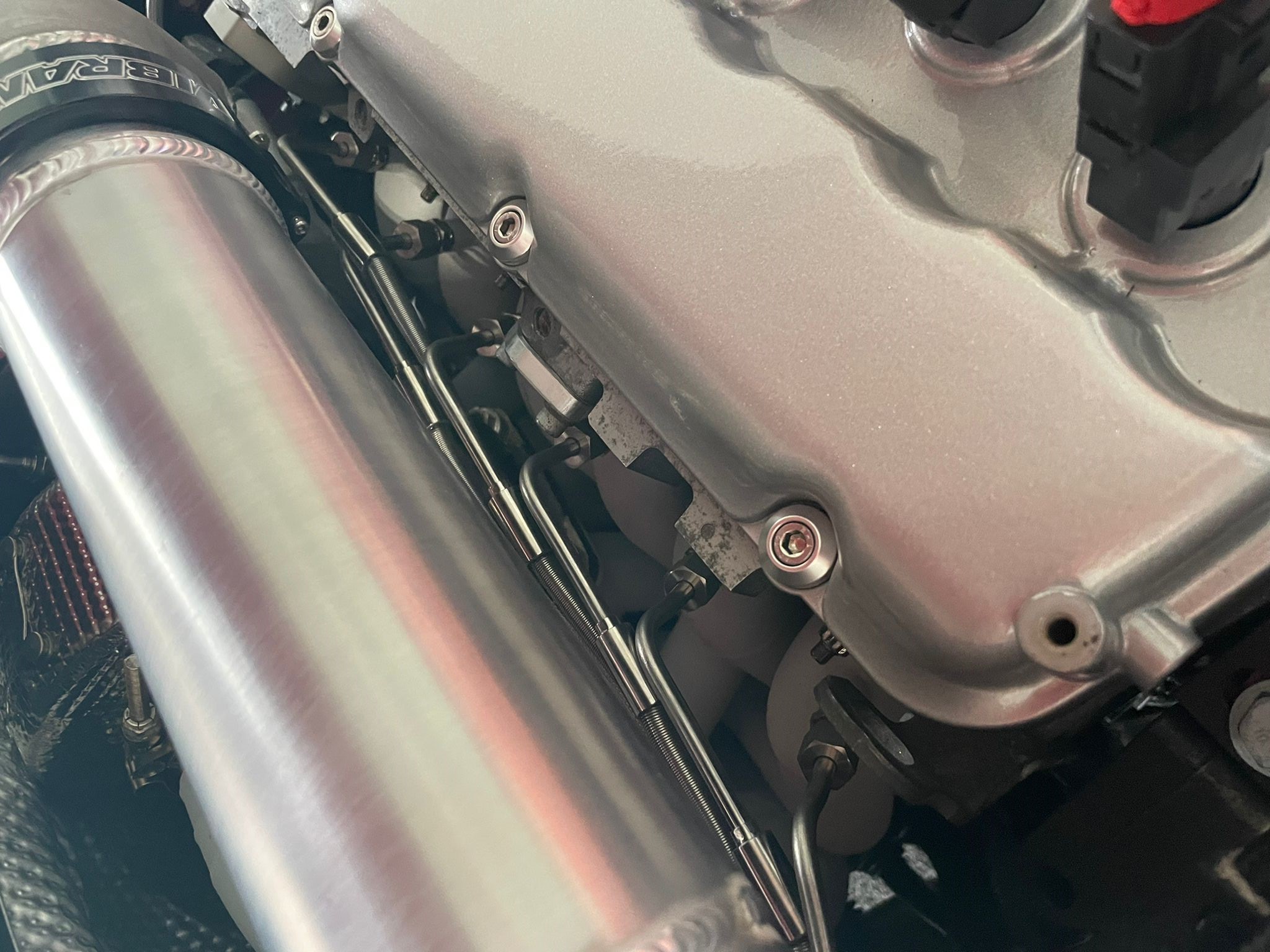

Another nice instal of the donmega probes

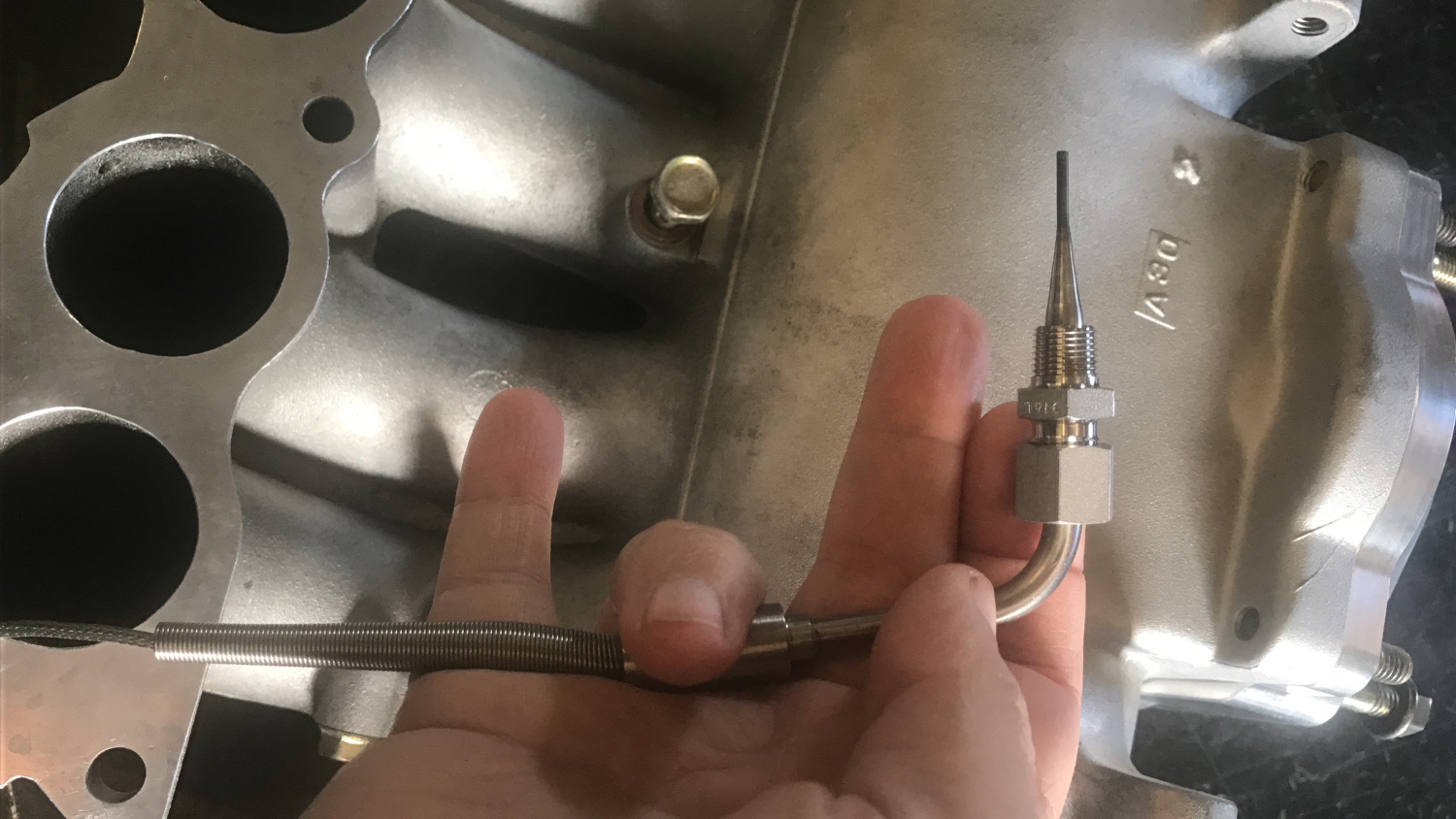

Here is fitment of a donmega probe to read true Air Charge Temperature.
One probe any application :)
Video showing fitment and flexibility of placement, uses a 316SS sleeve to isolate conductive effects and large volume around tip when recessed to sample air in runner.

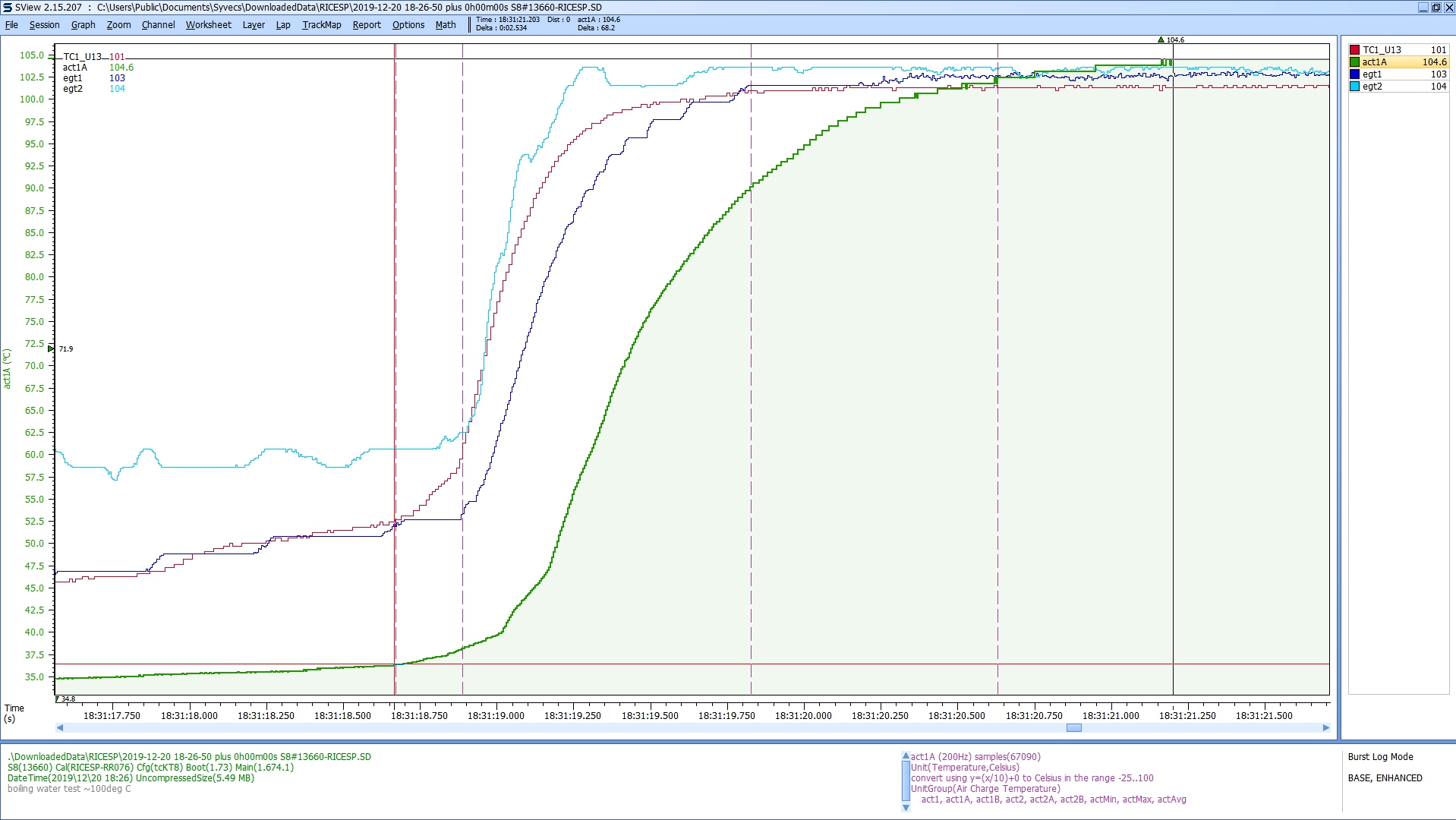

As a refresher here is how much faster they are than a 'fast acting air temp sensor' :mrgreen:
