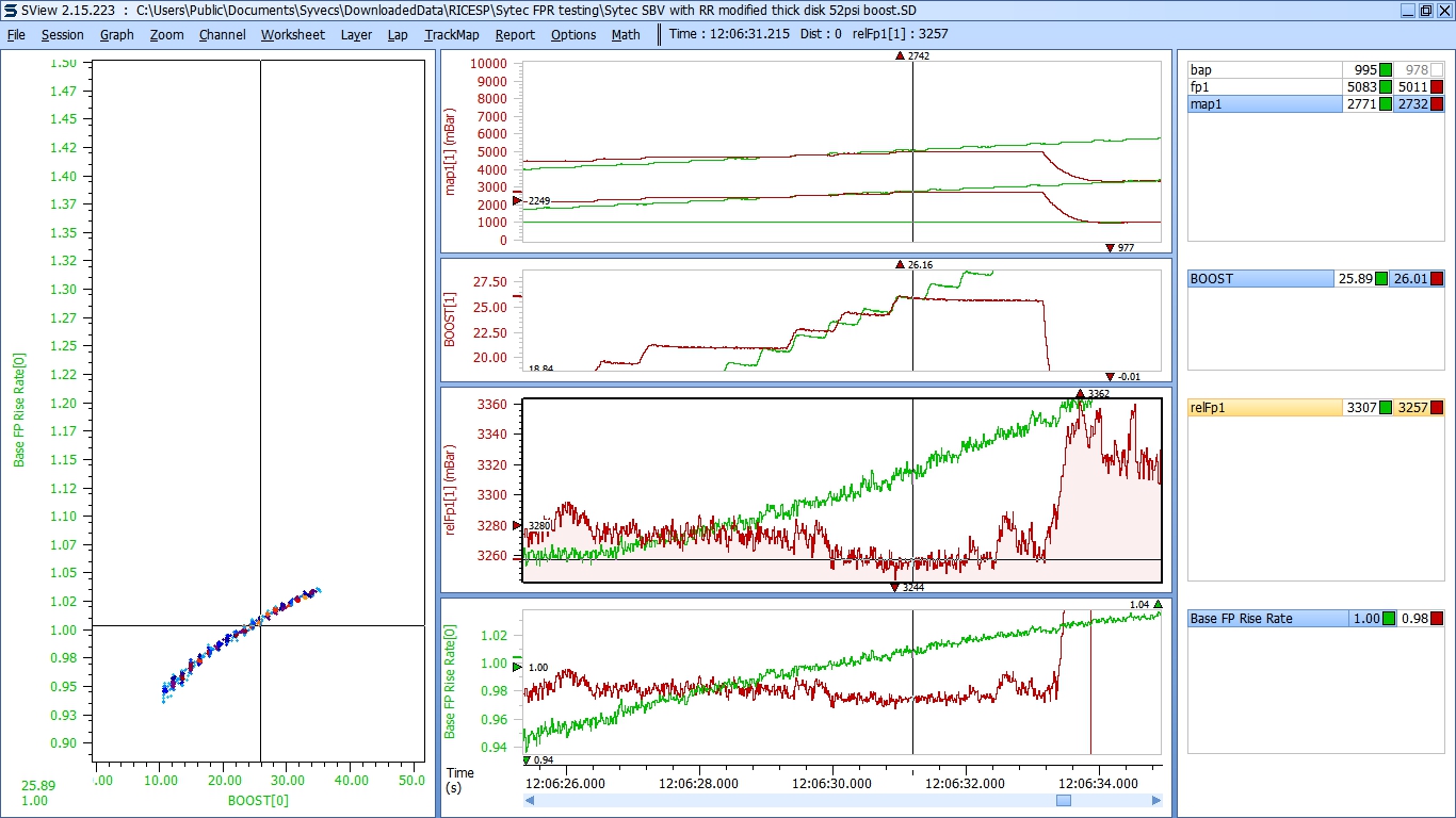

Here is the final solution https://www.youtube.com/watch?v=Nnk8kmJAyjM
Fixing the non existent 'rising rate' on boost side (as delivered out of box) to what I needed it to be.
Just need to update fp trip to a table (same as on lambda) to fully implement this new regulator properly. NOTE: same needs to be done for cars fitted with mechanical fuel pumps as they have a rising rate as well ;)

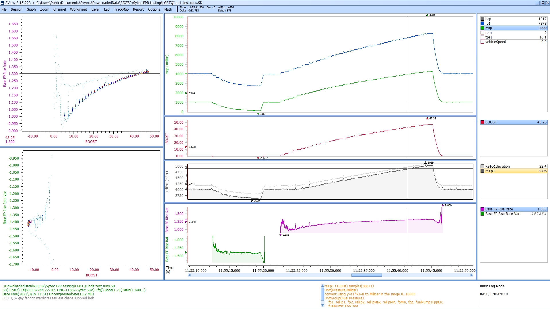

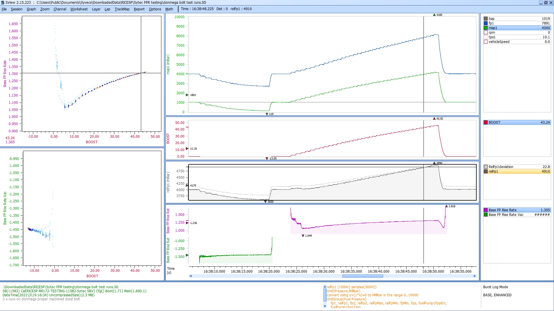

As delivered in red (below 1:1 rate), V mild clean up of disk once I understood the problem of why it did not work as claimed.
below 1:1 rate at ~2700mB map
RR disk mod v stock.jpg (452.96 KiB) Viewed 63034 times

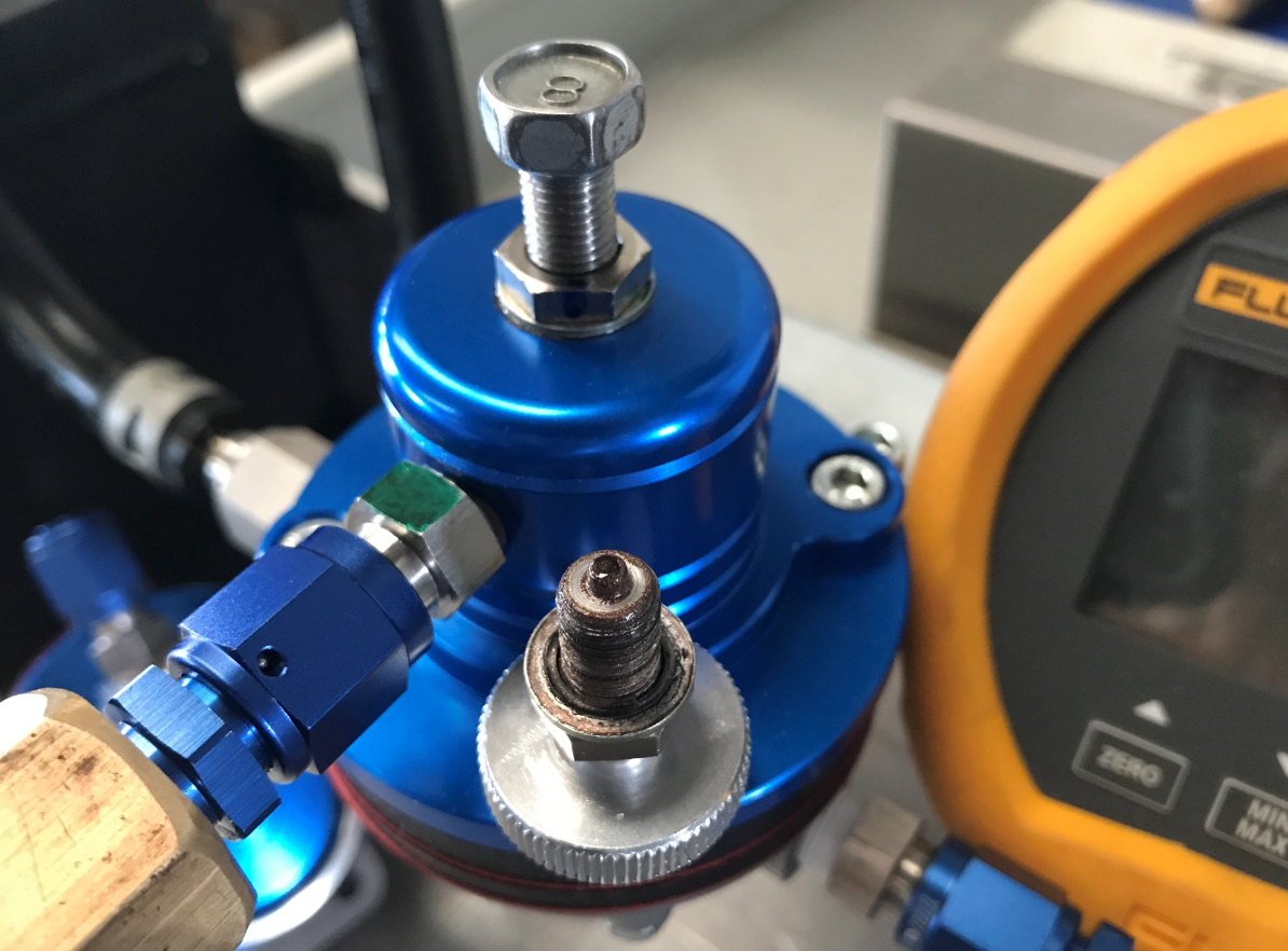

These are pictures for those who don't like video (everyone is different).
Amazing to see that a 'bolt' can have this much effect !
I changed the material and profile specifications of the nipple on end, its all these little details and ability to test effects that add up.
pretty shit.jpg (657.95 KiB) Viewed 63007 times
proper not shit.jpg (633.53 KiB) Viewed 63007 times
