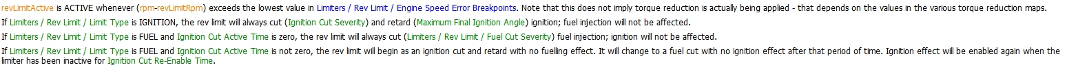

i fixed it, nice and smooth now.
the issue: rev limit set to fuel. but the ignition cut was still being used. i by mistake by not looking at the "ignition cut active time" it was st to 2 secs put it to zero. and all of a sudden the engine was really happy and smooth with no knock being recorded.
so even with the limiter set to fuel type, it still references the ignition cut.

don't sweat it old cock, F1 key is your best friend
- F1 key kent.jpg (150.04 KiB) Viewed 76793 times
