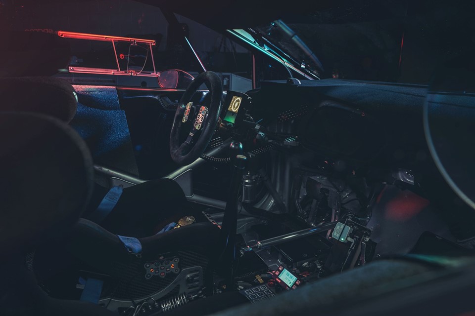

as used by real professional racers ........
best 3.jpg (243.51 KiB) Viewed 391339 times
best 1.jpg (77.89 KiB) Viewed 391339 times
best 2.jpg (50.16 KiB) Viewed 391339 times

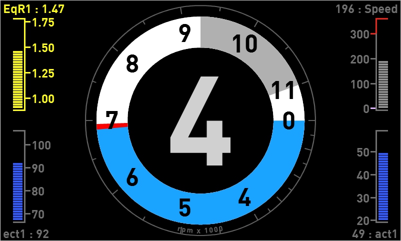

Re: Syvecs Dash Examples
I have had a few requests by end users to do some alternate dash configurations and after some development time here are a few sample screen shots.

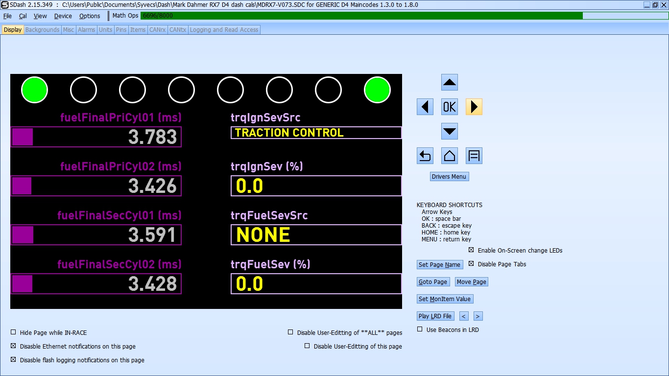

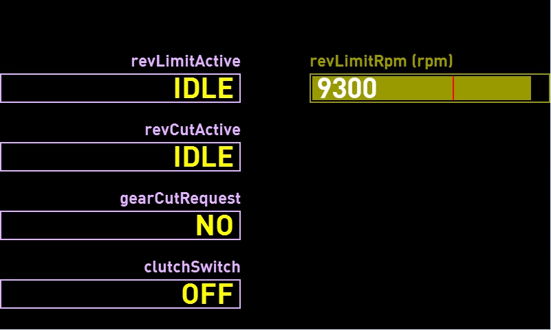

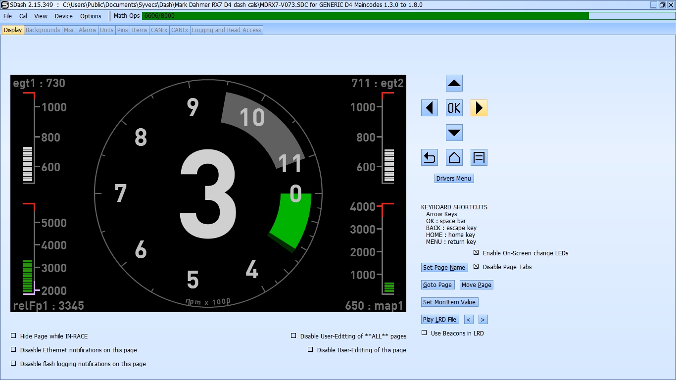

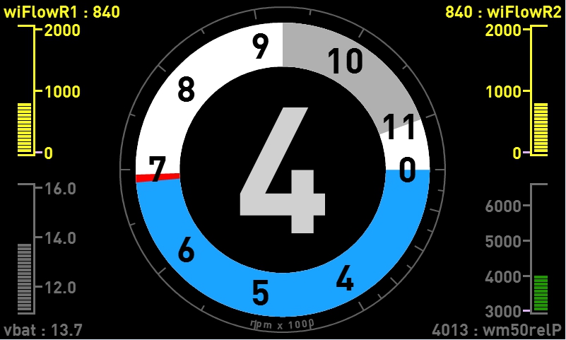

a few more

As always the objective is peripheral vision compatibility while using instant positional recognition along with colour banding of set categories. This is born from nearly 10 years of running LR/Syvecs dash units of which I look after a few, while the pictures are one side the bit that cant be fully given due respect is the 'race function' of these, that comes from the screens but more so the alarms sections and maths, I have in most applications over 70 such in just alarms alone which handle:
  • messages
  • change page
  • warnings
  • alarms
While most in other inferior brands have this as a tick sheet and claim to work these rather actually are of use and not an annoyance as can be regularly seen quite comically with rivals 'race dashes'.
It is not an exaggeration to say that many 100's of hours have been put into these, It is not uncommon to spend many days playing back actual files to review and check all functions as they can be in cases rather complex. The dash's as a result are the most useful units out in actual use of any I have seen, the cost is fair for what you get an unlike a bullshit *Harvey Norman* 80 inch plazma screen TV kuntz fit to cars these days (with bullshit graphics that are nothing more than a borderline bad joke) this works.

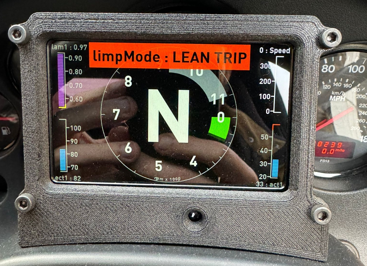

live action shot of one set up
don dark.jpg (950.55 KiB) Viewed 382510 times

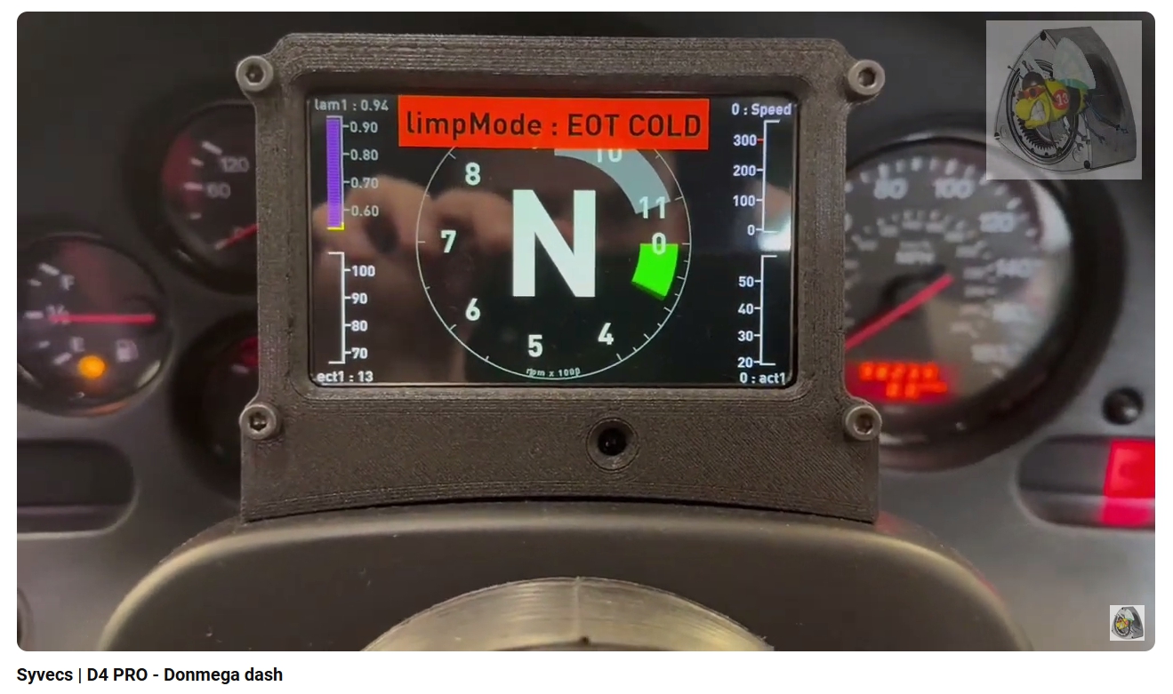

GagTube link for live action > https://www.youtube.com/watch?v=3cwuhcq0mrU
donvisz yo.jpg (460.41 KiB) Viewed 381800 times

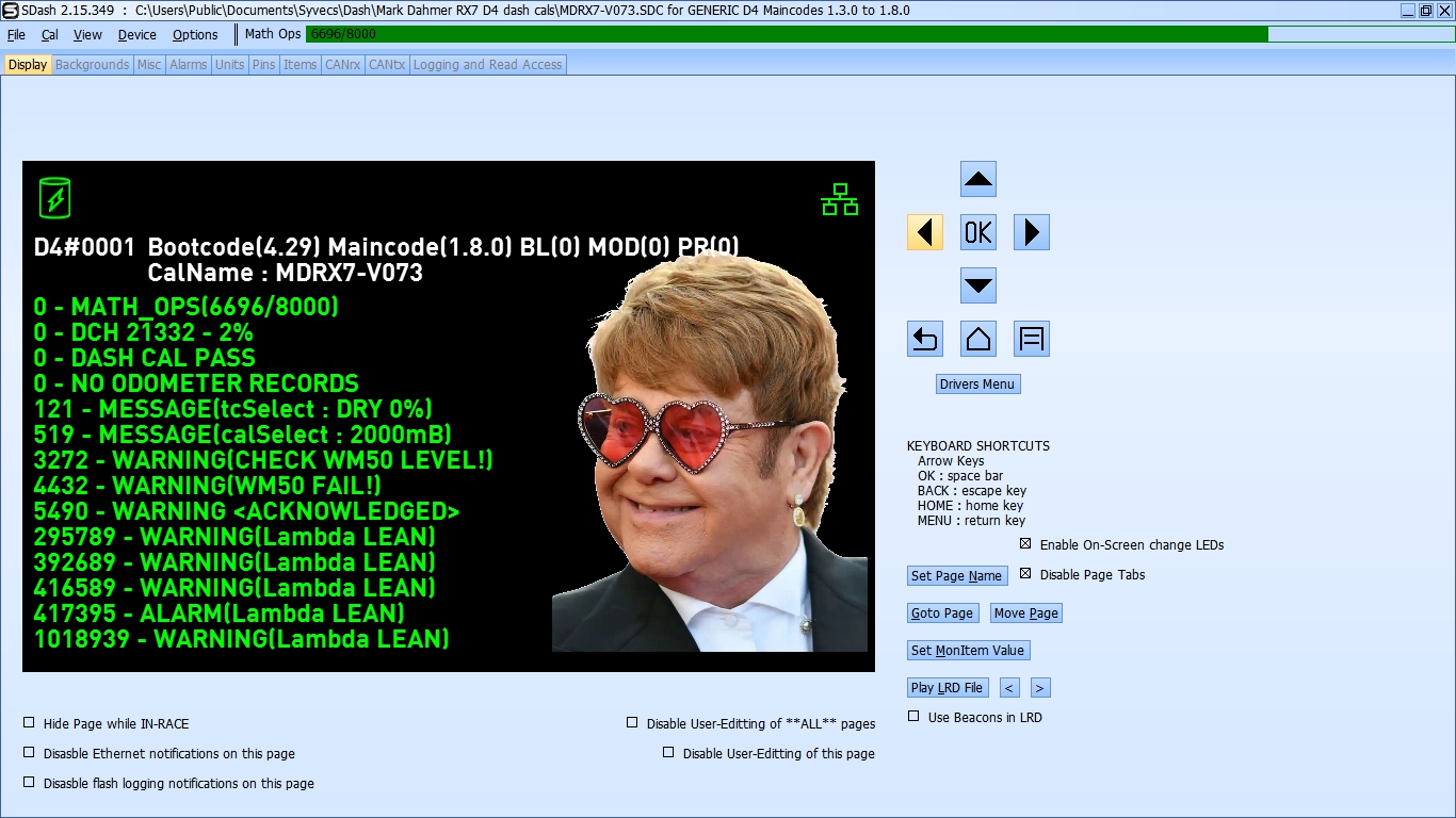

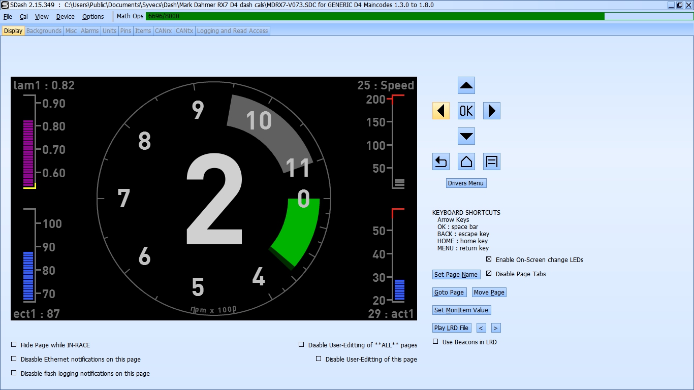

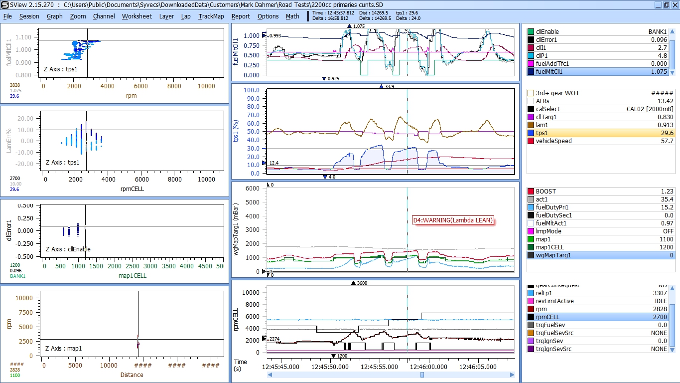

Here is playing back a log in the SDASH software, events are time stamped in microseconds so really easy to see back in your log too, the events in this case dash warnings are automatically recorded into the data log file and can be seen in SVIEW

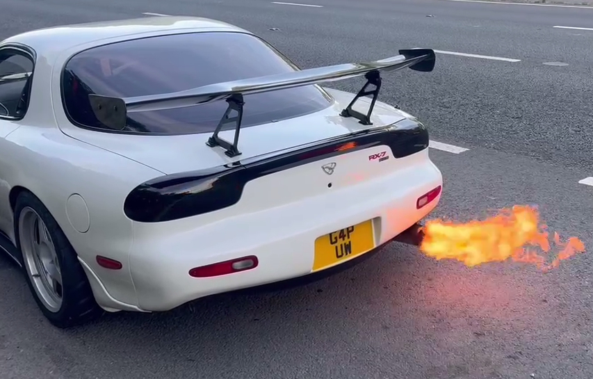

A bit of live action shots of the dash set up here and showing a full implementation of the D4PRO working with PDUX2 and S8 > https://youtu.be/z2WSDRkDTks
mad cunt.jpg (299.26 KiB) Viewed 343632 times
Nice shift light...seen that a few days ago lol
