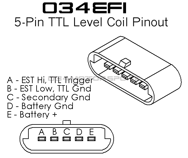

Now I have only coils and camshaft hall-sensors to be connect so couple question from them:
Coils are IGN-1A and here is pinout:
A - Ignition signal from ECU
B - Logic ground, connect to ECU ground
C - Spark wire ground, connect to cylinder head
D - Power ground, connect to battery negative
E - 12 volt power
And some Info:
These coils are designed to put out 103 mJ per spark, with a longer spark duration (2.9 ms) than what you'd see with a capacitive discharge. They can be driven with a 5 volt logic level output - we recommend a 270 to 330 ohm pullup if you're building a MegaSquirt to drive them, and they can fully charge with as low as 2.5 ms of dwell.
The coil charges when a 5 volt signal is applied to pin A, and fires when the voltage drops to zero. The signal is similar to an LSx coil, although it does need a bit more current than what is needed to make an LSx coil charge.
Questions:
1. Pin A => +5vout or ign pins on S6 ?
2. Pin B => Inj or aux (or Ign pins if pin A is +5vout) on S6 ?
3. Is there some other things what should I know about these coils connections ?

vayne wrote: And some Info:
Questions:
-Mikko-
Pin A => IGN-pins on S6 (ign outputs configured to 5V)
Pin B => ECU ground
This 2,5ms dwell is not really "full charge". It is wery low charge, something under 4A primary current.
Useful Dwell ~4 to 6ms (5ms is very normal).
Primary charge current/Dwell time (RED curve) on the next picture...
http://picasaweb.google.com/jaritlaine/ ... 8387374802
Attachment picture with little different text for coil pins.

Re: S6 GP wiring to beginner ?
Thanks !
And that ecu ground is ANGND or PWRGND ?

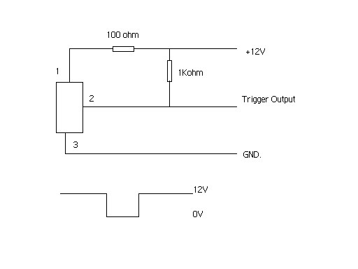

Cam Hall-sensors:
4. Is trigger active high or low ?
-Mikko-
And
Cam Hall-sensors:
-Mikko-
- 306 S16 (XU10J4RS) - Camshaft Position sensor (Current Limiting and Pull UP Schematic) - sensor_wiring.jpg (8.26 KiB) Viewed 61084 times
Peugeot MI16 -89 Tic
Audi S4 B5 Stage 3++
ScoobyDuck
- Posts: 49
- Joined: Mon Aug 17, 2009 4:24 pm
- Location: South Uk
as its got a pull up, its low, which the wave form shows

You need PWRGND since it's a power device and not a sensorAnd that ecu ground is ANGND or PWRGND ?
