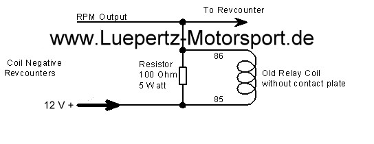

Most of the older Toyota Rev Counters are Coil negative Rev Counters which may not work with the above connetions because they need a voltage spike rather then a ground signal. My solution is the following circuit, which generates a voltage spike and works in most cases.
If it still does not work some Rev Counter may need a 220Ohm 5Watt Resistor instead.

I now put in a circuit Heinz suggested and I now have close to 4000rpm in idle ;) but at least I have some reaction and I am pretty sure, the rest can be sorted out with adjusting the signal pulses coming from the S6
