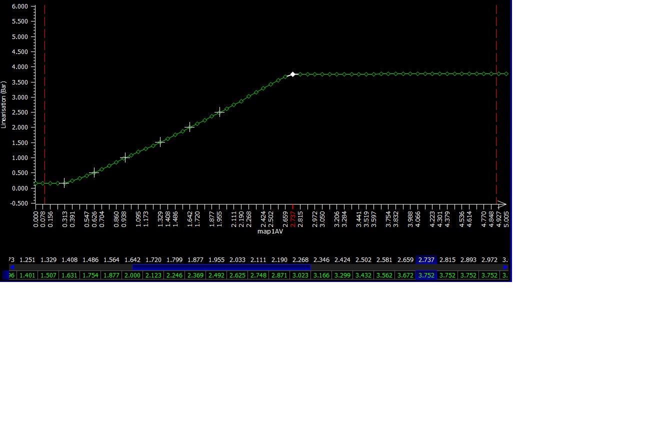

Ive attached a file of the map linearisation.
He supplied the sensor, and as far as Im aware, they all come with a certificate with the information and details of the sensor. These must have been wrong if the sensor is sold to run on 5volts and are a scaled down version.
Ill know just how far out. Ill apply a range of pressures with a gauge and see what SCAL says the readings the syvecs have. Will be interesting..

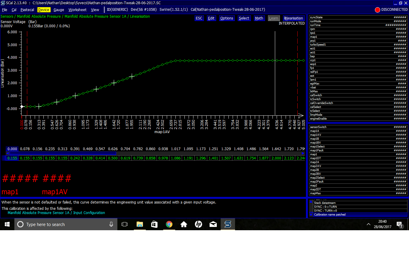

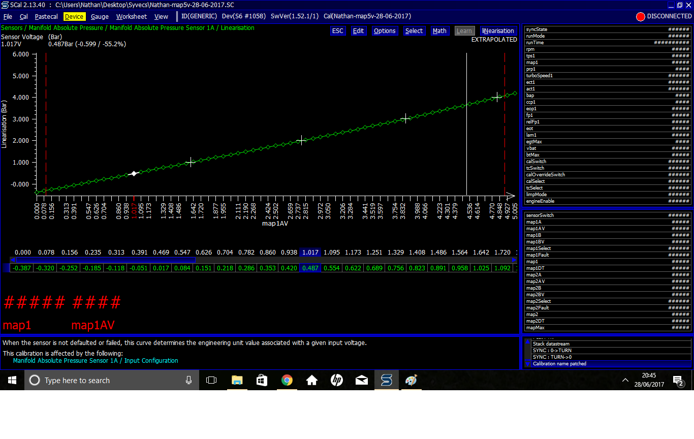

Re: Can anybody identify this MAP sensor?
]Im still learning, so not sure what you mean. But here are screen shots of before and after. The cars quite loud so can only idle. But its running and idling with it off the 5v rail.
Tommorow Ill take it for a drive.
Idle was sitting at 0.4bar with the new sensor. Engine off was 1bar on the dot.
