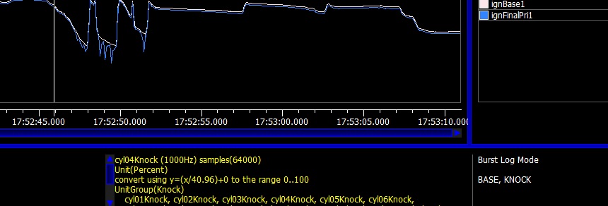

Knock base will log as CYlXknockthresh
Logging rate shows at bottom of screen

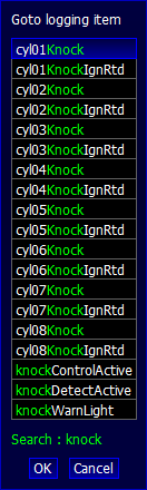

I've tried CYLxKnockthresh and its not there for the S6 v1.74.2 using a new config, not my own. So i guess there is a bug there somewhere (or i need a new cfg file?)
ok to upgrade - i idnt think it would be free :p
thanks
Steve
thanks
Steve
- knocklist.png (10.4 KiB) Viewed 62197 times

send me your email.

Thanks Stevie
Knockthreshold now on scfg, Areas at low knockbase raised slightly. More logging needed to see whats going on.
Also lowered the Hz of knock as that was wiping out my logging memory a bit.
Steve
