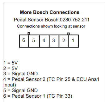

I have ended up buying a Audi 225 TT pedal, got it with a plug, £12 posted, hopefully that works
The number on the pedal is BOSCH 0280 752 234 , the STC wiring diagram has a Bosch 0280 752 211, which has the same connector on it so im assuming its the same and the difference in part number is down to the pedal material on the TT being alloy/rubber and not all plastic like what the other number is.
- ped.PNG (29.95 KiB) Viewed 89679 times
