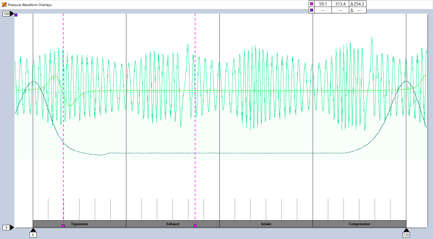

Make life easy for anyone trying to decypher what you need through all the vagueness.
Stick a pressure sensor in cylinder 1, and log raw crank, cam and the pressure sensor at 1000Hz during cranking, and it will make it easy to sort the crank/cam setup.
ie. you can easily see crank cam and where all teeth are in relation to cyl 1 TDC
goc crank cam overlay 720 chart.png (82.4 KiB) Viewed 85764 times
