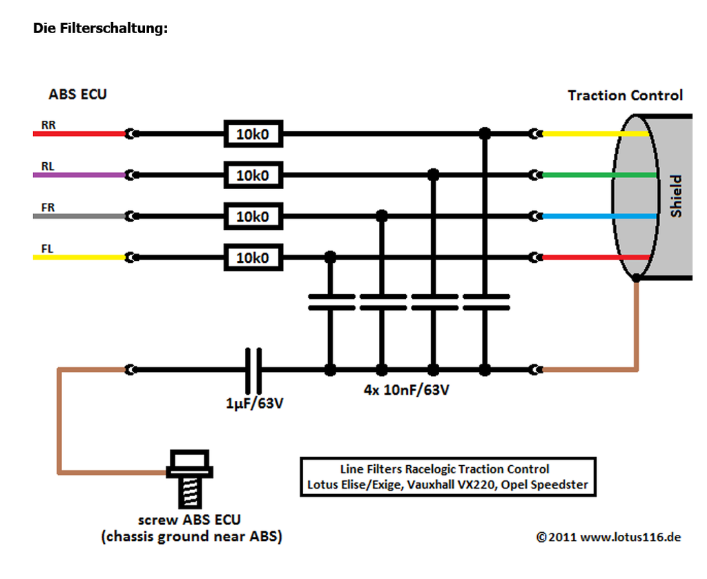

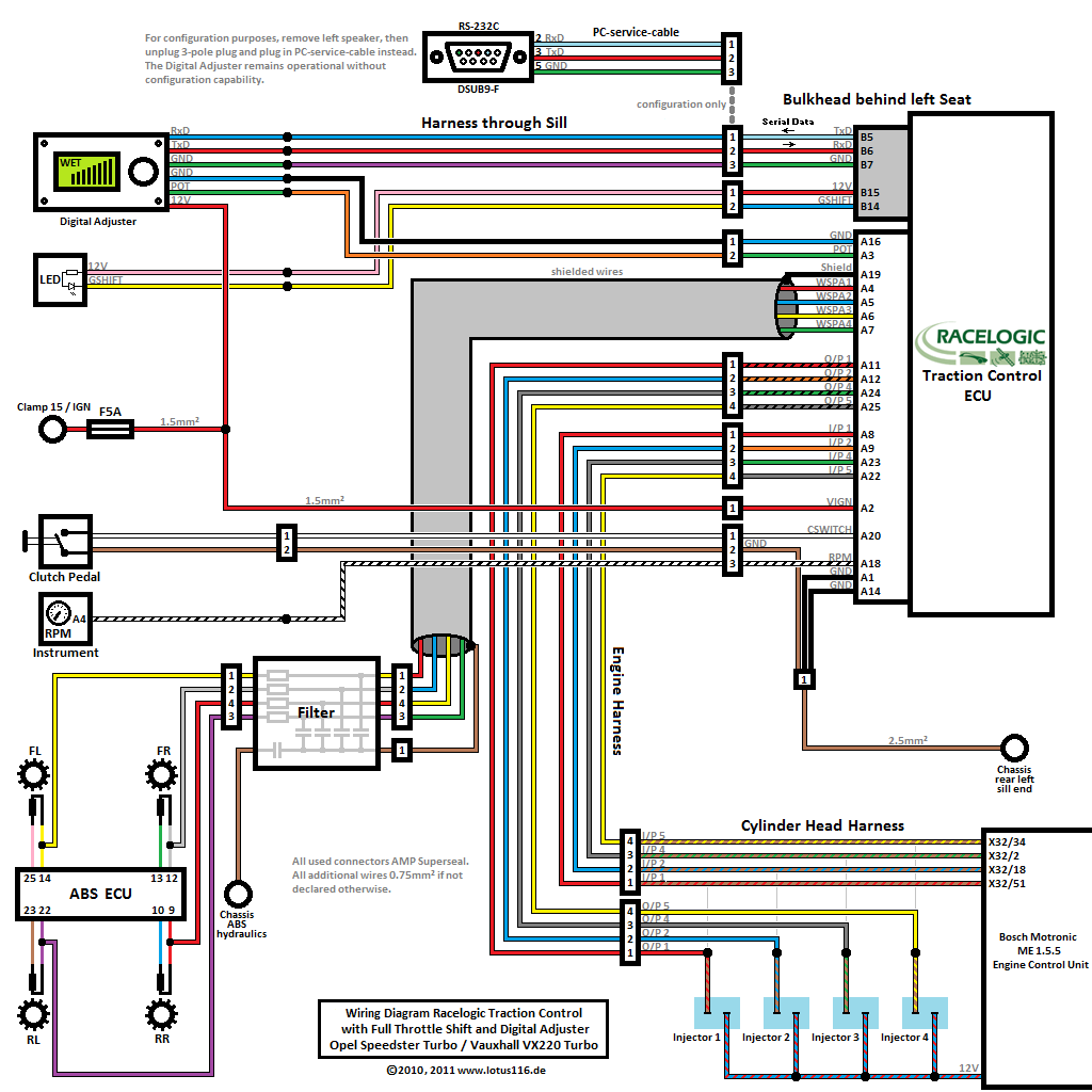

Wheel speeds will be one I need to deal with. X4 seems like an option....but almost a waste of an expander to get only 4 inputs and outputs ( although I think it's kinda 4+4 )
I see though lots of people seem to retrofit a Bosch MK60 ABS unit, which seems similar to the Bosch Motorsport, I wonder if the CAN stream on both are the same to get wheel speeds from that, as that might be an option, as the OE ABS on my other car is crap and this might not be horrendous to change.
Or I see many in the past who've fitted Racelogics TCS, they do wire the OE VR wheel inputs to the RL system, but with some DIY filtering added. I'm a good way off doing either at the minute though
But the filter might be a way of wiring direct the the ecu, and keeping the ABS itself happy. Although if the Bosch system could talk to the ecu via CAN, that sounds like a good upgrade all round.
Or the X4, although it mostly mentions MR, not VR sensors. I assume both would be ok.
