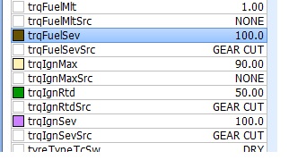

Il hopefully get the car out this weekend Stevie, is the screenshot you have attached what I should be looking to set up and log?
log all the sevsrc parameters and it will tell what reduction is active.
Again, no idea how their coding works for the box, but that should identify why any torque reductions are happening

Ok so did some logging today with i think all the sevsrc parameters logged.
Iv had a look but it doesnt really make any sense to me, says its hitting the engine torque limit and then anti lag on another

Not seeing any cuts or actions you'd think should go with gear changes.
I see the anti-lag fuel reduction...I assume you have anti-lag enabled and active ? You are not logging any ALS parameters to see.
Turn it off and try.
But unless their coding does actions you cannot see with the normal logging parameters, then it would seem something is missing.
