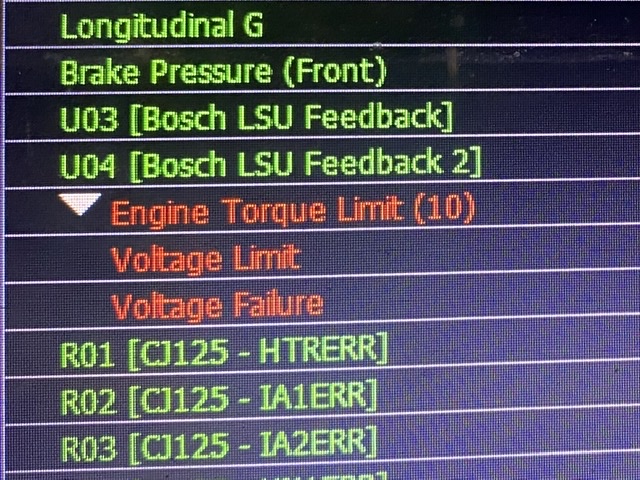

Still getting the trans limp mode message on dash, even with KOEO. Also still have the same “Engine torque limit” error message on Syvecs. Based on this error message also saying “voltage limit” and “voltage failure”, it must not be receiving an input signal either from a pinout/connection issue, or a software setting. I need to email Syvecs and find out what trips that message. Wish I could get an actual normal engine code for this error, I’d have it figured out already.

by Nitrorocket
Re: 996 turbo fuel map??

Nitrorocket wrote: Sun Mar 29, 2020 4:07 pm Yes, the car coding is per the manual, even though it doesn’t make sense as to how the software labels it for 01 and 02. Did not try reversing them.
I would try putting the numbers in as per the named fields for Coding 01 and 02 then, even if it isnt quite "correct" as per the manual.
Any lack of signal relating to that item...will cause the trip. A generic OBD code would do nothing regardless because that is not how CAN works.
