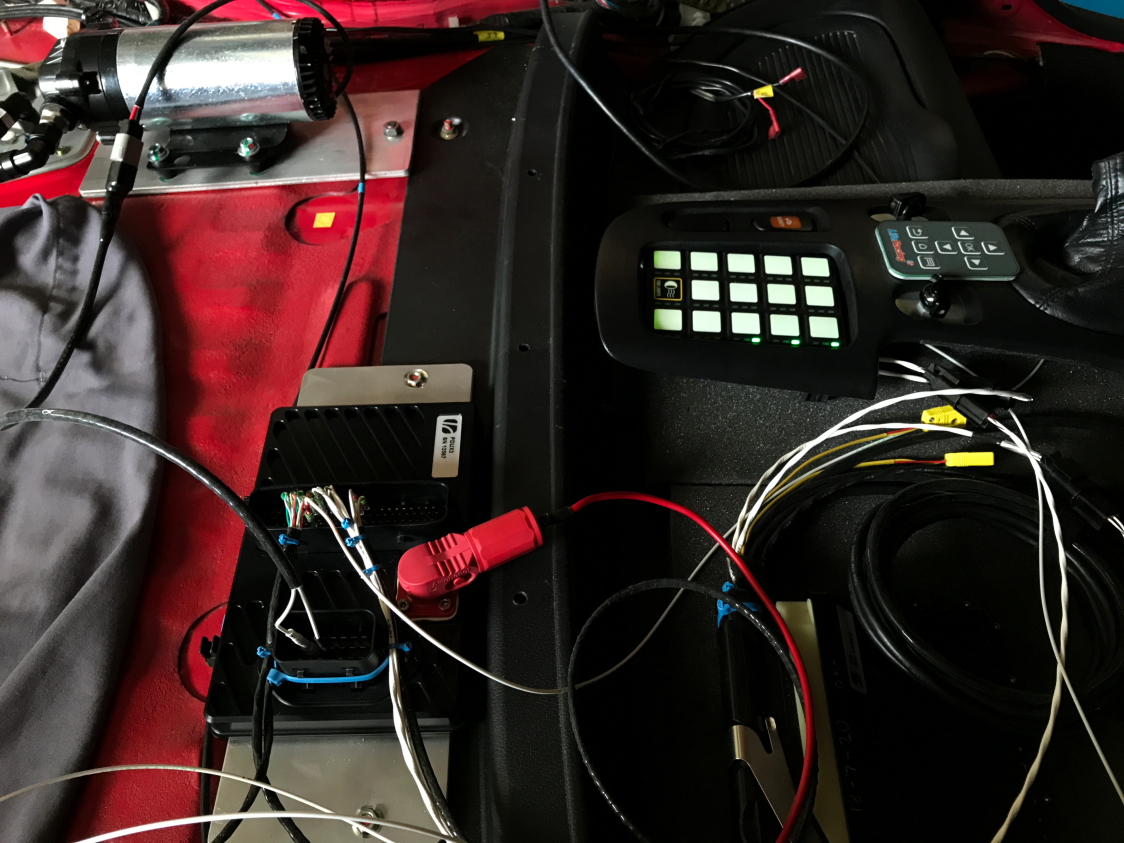

Last little while I have been working on the latest generation of Syvecs water injection implementation.
Deviates from the above in that its fully sequential, and is tied in 100% the fuel related strategies of the engine control, this results in lower fluid use and otherwise normal operation regarding delivery (it is not a patched on system you need to work around). You have to use a LR/Syvecs D4/D5/D8 dash and as well as a PDU to get the full benefit but its worth doing. A few tests were conducted and new external software developed to simulate all of the permutations to gain the right set up. Some compatibility in hardware parts and mixtures (basics) to cover off parts that can go together to make it all happen.
Once I get onto the next stage of advancement I will happily put up this when it becomes 'old hat' but for now I can say its what WI should and can be as a fully functional part of the controls running the engine.

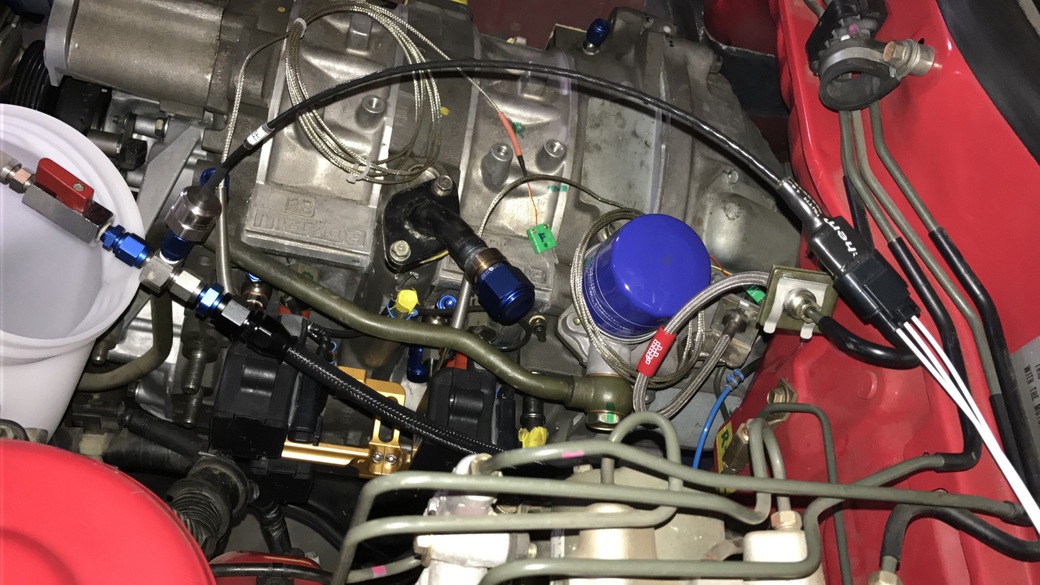

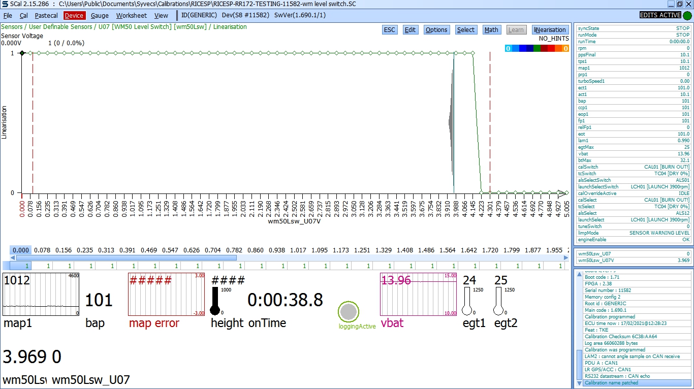

Current system parts, remainder is 'conventional' and brains is controlled by Syvecs/LR no 3rd party controllers or 'Telephone cables' to be seen :lol:
System low level and content sensor
WM50 voltage.jpg (535.8 KiB) Viewed 275180 times

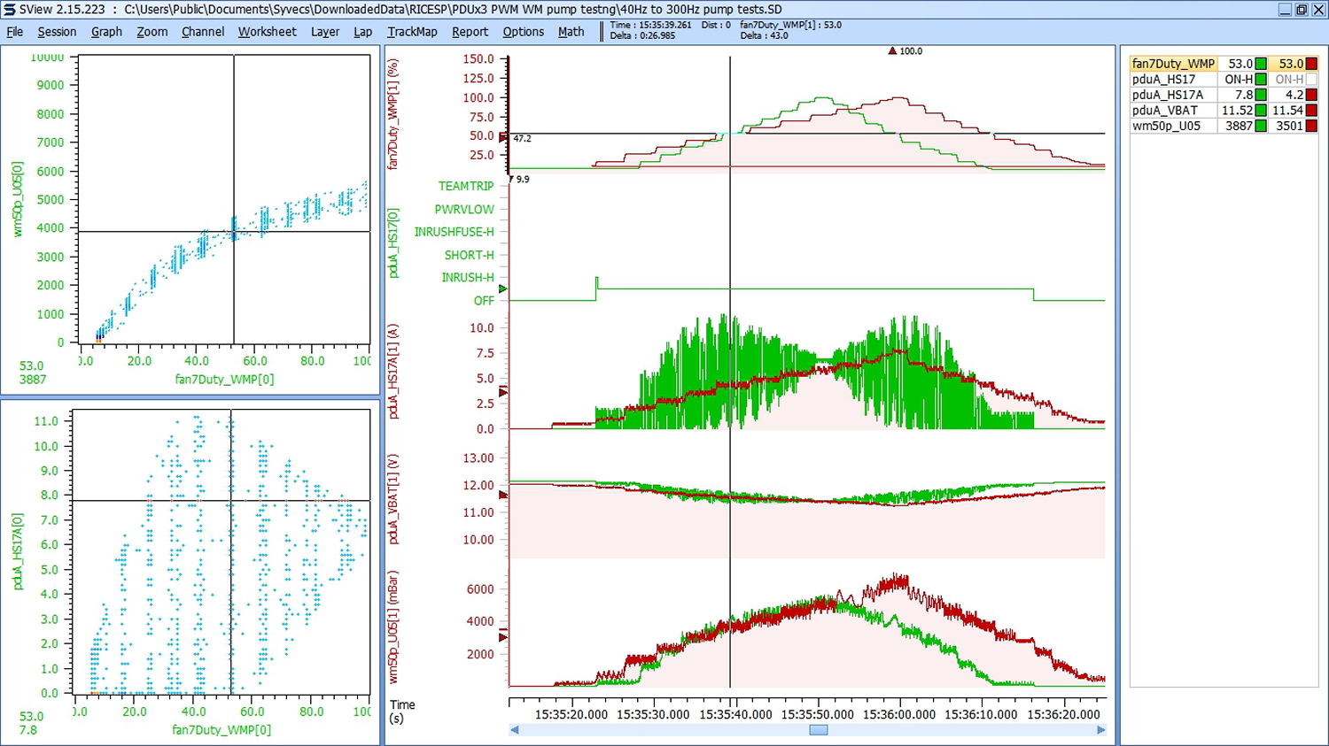

Here is the Aquatec (large pump) being PWM driven directly from the S8 and PDUx3.
Tested from 0% to 100% and works ~3% duty onwards

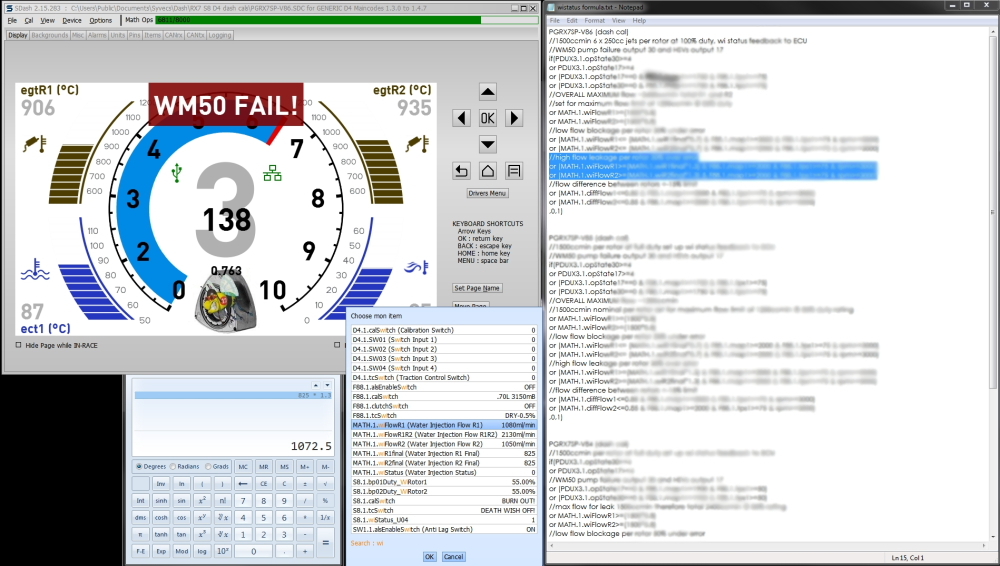

For those who want to program it all themselves this is how I do it (you will have to work out your own maths though).
The dash math items have a raft of inputs/outputs from the PDU and ECU for example to show things like if the WM injectors are at fault or pump to name but two items. There is a stack of basics like trip values for the associated sensors in the system which I have not shown to not bore you all !
To do it fully without going mental I also added to the calibration sheet to test run all combinations to allow quick narrowing down of what parts would work to give desired system fit this takes into account basics like injector type/characteristics, scheduling (360 or 720), pressure heads, varying rates of rise to map, ratios of fluids used,

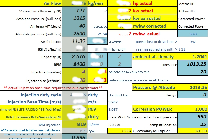

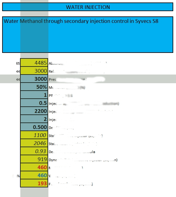

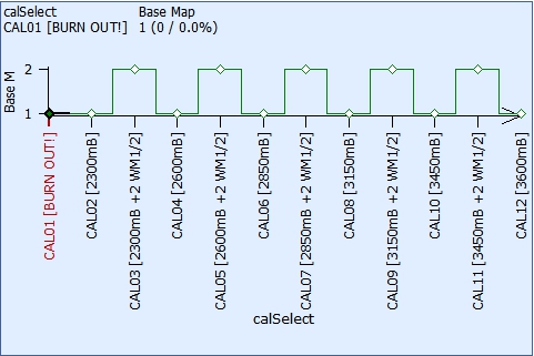

Here are a couple of shots of parts of the calibration sheet that allows different permutations of set up variables to be tested prior to selection.
There is more to the sheets than above, some of it is ability to look at pump flows/duty correctly (both main and WM) these obviously interact depending on split and fluid specifics like pressures for example. Very important to be able to this as there is really no way to do this efficiently without a shit load of guess work *good luck* trial error tuna time.
Tied all back in to calibration settings like below: Have ability to quickly change based on driver selection, to max WM flow rates to min (economical) ones. It changes pump PWM and CM fuel corrections automagically :ugeek:
Hopefully gives enough insight for what I would call an advanced WM integration.
Did some more set up work on this, now looking at the three chamber pump head and motor to optimize the current draw and linearity to duty cycle applied, there are some interesting spots of frequency applied to the motor where it is not as happy (big effect on pressure variance). Did over 30 tests over a day from 40Hz to 500Hz some pics below... Have the Grayhill keypad integrated in there too.
