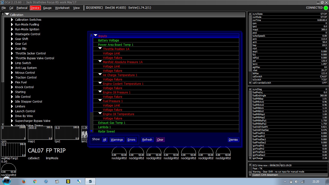

well bit of an update , got the car mapped finally and all was well , have done about 200 miles on the syvecs.
was away with work but when i came home i had some bits and bobs to do on the car , one of which was welding. just to keep my mind at ease i removed the ECU and the battery to stop them getting fried. went to plug it all back in tonight and boom , everything's shit the bed. im absolutely gutted. it might be something iv done , it might be the ECU or it might the list of sensors it says is at fault , but im thinking its the ECU , the ecu thinks theres 20 volts ? unless im missing something ( battery with a volt meter says 12 volts or so) so im thinking somethings went pop

Clear and dismiss the errors.
Or do they keep coming back ?
Are you sure all your wiring is plugged in, correct and undamaged ?
And presumably there is not actually 20v at the car ?
If you key off and on again, does it always return to same errors ?
Jackstrath
- Posts: 160
They return instantly ie don't clear at all
Yeh Iv had a look at the wirering and can't see anything obvious, intital thought was a earth off somewhere
The ignition module relay (what ever that is in the fuse box) is clicking half a dozen times and then stopping but I can't mind if it did that before or not. Unplug it and it's still the same
Ignition on/off and it says the same
It did say the RTC had been lost when I plugged the laptop in so set that and assumed it was because I had the ecu out
It would take a considerable time unplugged for it to lose the clock, so that's odd.
Can you re-load the calibration and program it ?
And again...I'd be checking all wiring, especially where any work was carried out in case something is shorted out somewhere or plugged in the wrong place.
Or just unplug as much of the loom as possible from the car, but still connected to the ecu so you can view what is going on
Or make up a test connector for the ecu and power it up on the bench and see what it says when you connect to it.
Jackstrath
- Posts: 160
Aye it was out the car for about 4 days,
Iv found the issue , few burnt wires where the head from the sill repair has melted the coating , gutted after all the preparation I did, hope the ecu is ok
Hopefully..but only time will tell
Jackstrath
- Posts: 160
2 wires damaged , a ground and a signal had shorted , thankfully once I repaired them the car fired right up and everything is back to normal ! Thank god!, road test tomorow to confirm but all signs are looking good !
