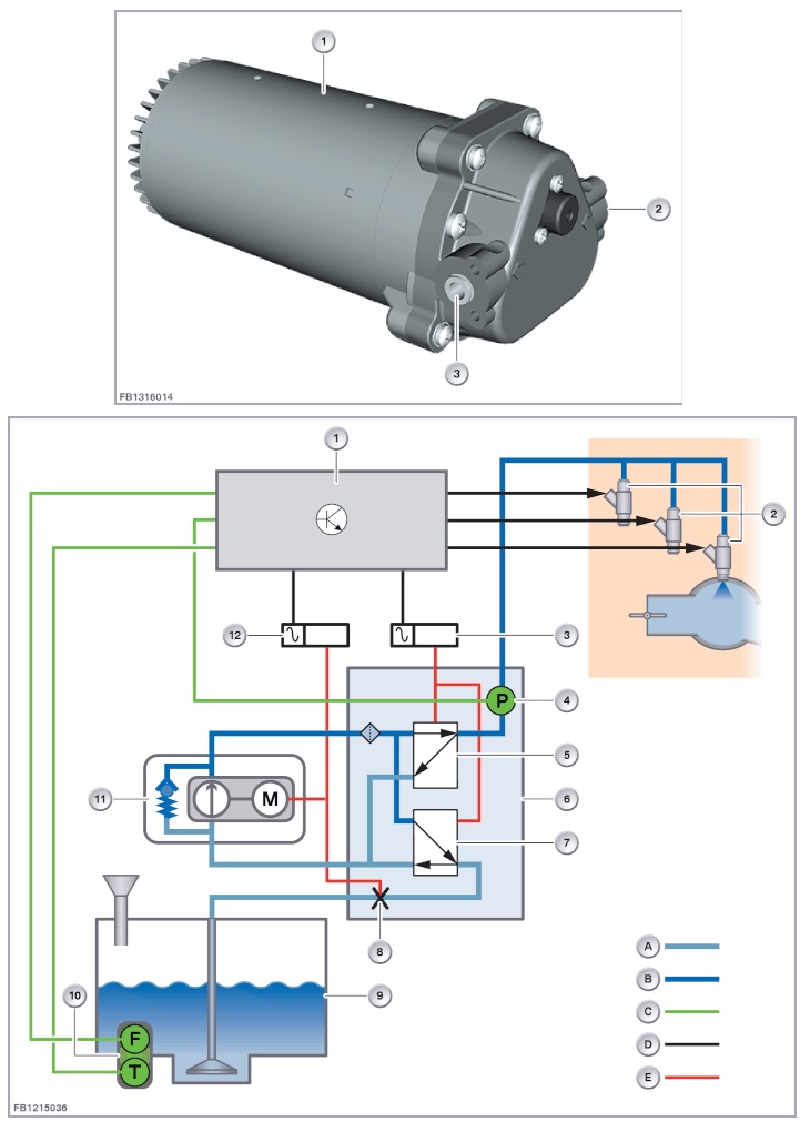

I've attached a picture of the pump, and the diagram from the body of text before, if it is of any interest

It may only be an outline, but sure looks like the common standard DDP5800 pump or a variant of it.
- Posts: 538
100% that is the same three chamber 'toilet water' RV pump from hell

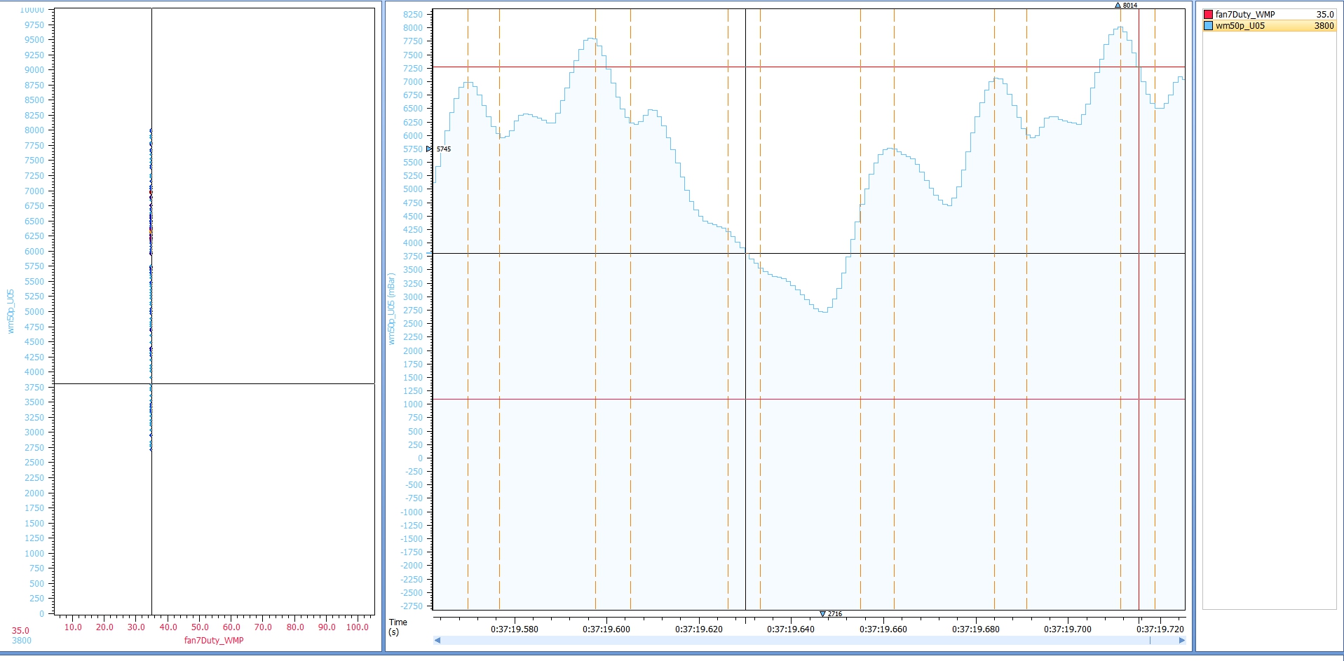

May as well share this for others benefit.
This is showing 6 cycles of an injector combined with the 'toilet water' pump. Center of ~7ms pressure log, you can all see this issue of this clear as day, you have a pump head at (in this example) 85.7Hz, injector at 34.75Hz you have a timing overlay shift dep on run time at fixed operation points where the amount delivered can vary allot! so sometimes the oscillation looks acceptable then other times its not. The 'toilet water' pump head has a three chamber design that the inlet on the left feeds the head and as the wobbler goes around the chamber work in sequence and each one of them has a pressure drop the furthest away is worst repeated every revolution. Pump speed and thus frequency of this pressure drop varies but is worse the higher the base pressure requested. Compound this with PWM speed settings from 300rpm to 2100rpm (open flow) or around 1700rpm at high pressure and you can start to get an idea of the problem.
Overlay on top the function of the injector (size/flow-number of them) then it gets more complex, very easy to see how kuntz blow shit up on a 'conservative tune' when they have zero idea of how the volume can change cycle to cycle per cylinder, you may think you have X amount of percentage of WM but what actually happens is another matter.

Have you experimented with any sort of an accumulator / pulsation damper type arrangement Peter?
Do you use the internal regulator in the pump, or an external one? Are the injectors at a "dead head" with a single line feed to them after the regulation?
I've had trouble with pulsation in a conventional petrol fuel system when running a dead head system before, there seems to be something good in having the injectors in between the regulator and the pump in smoothing out pulsations, I guess the regulator acts as a sort of damper and dissipates the reflections of the injectors pulsations, maybe it would help with the pumps pulsations too?
- Posts: 538
There are pulses with nothing in the system (just the 'toilet water' RV bilge) pump fittedMReilly wrote: Sat May 01, 2021 11:09 am Now that's a money saving part number to know Stevie, thanks for that!
