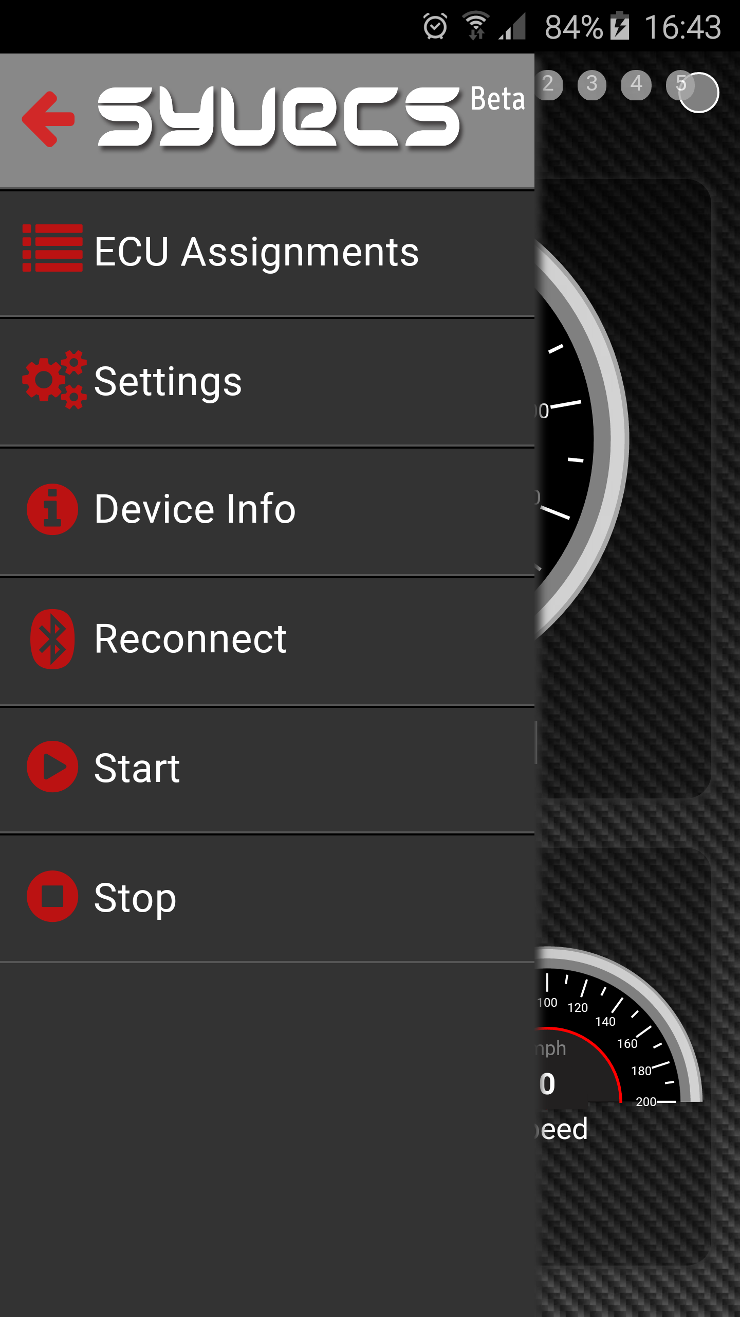

So had a chat with pat and we had a look at what's going on.
First thing there seems to be a glitch with the menu staying open, only way we found to close it was to reset the whole software so loosing all the settings.

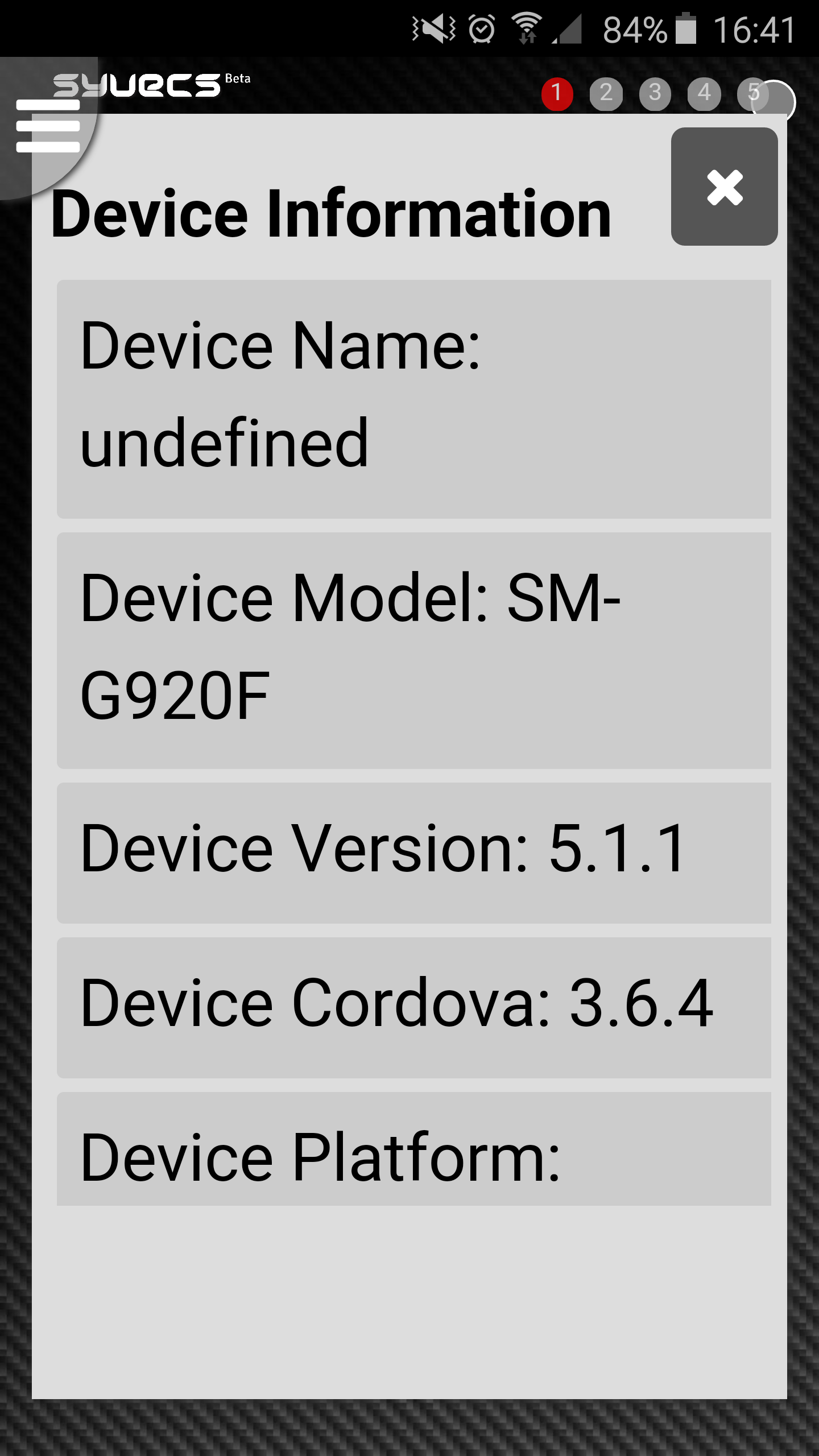

Any chance you can send me a screenshot of the menu staying open issue, thats a new one to me.
Glad you got the assignments sorted, obviously having to reset is not going to work though.

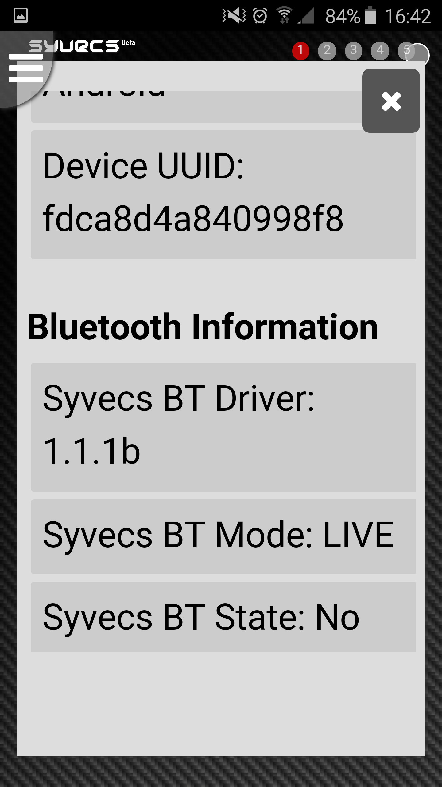

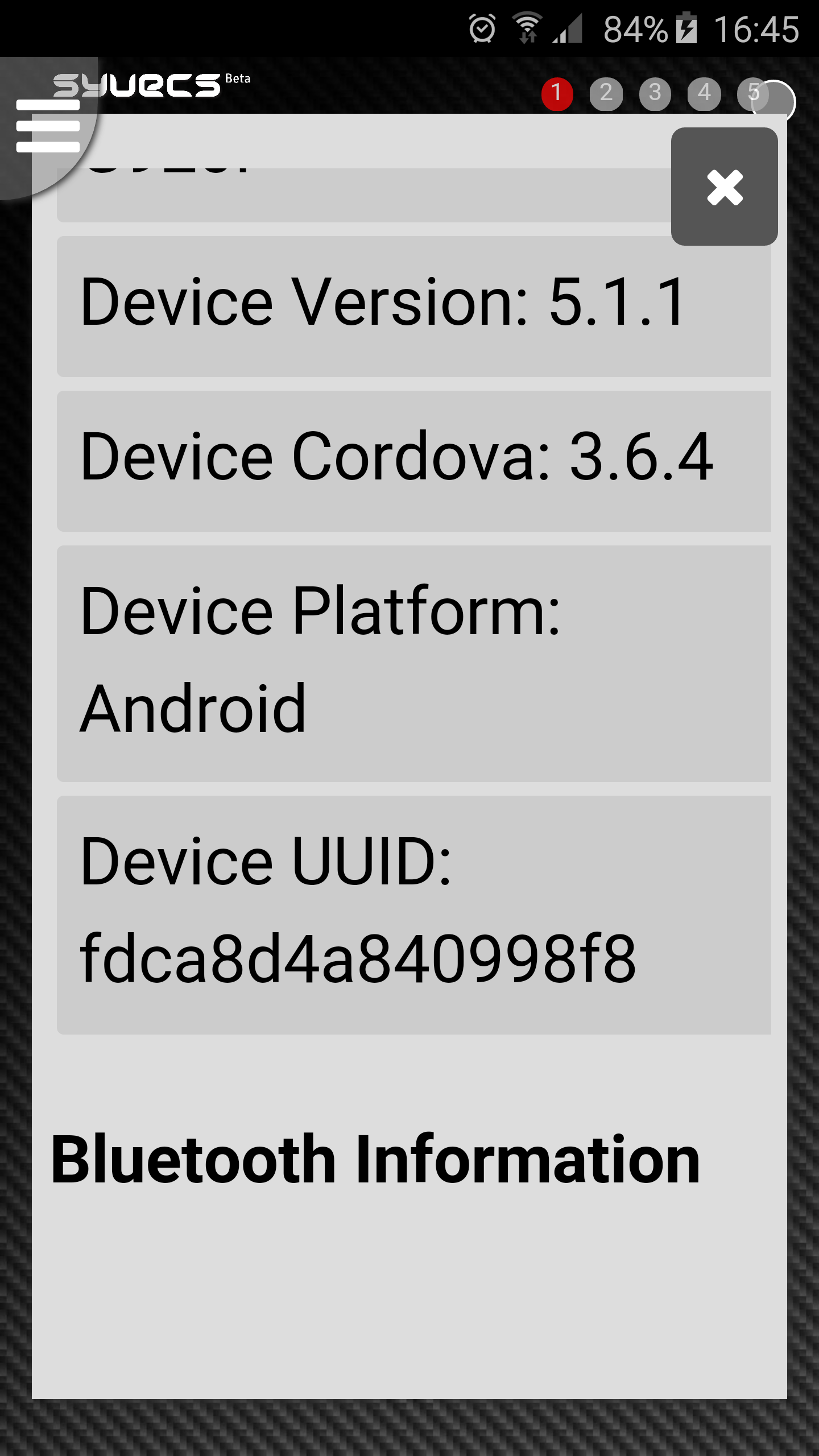

Can you also take a screenshot from the device information screen within the app, should be under settings.
Thanks

Wez wrote:Any chance you can send me a screenshot of the menu staying open issue, thats a new one to me.
Thanks
should be attached.

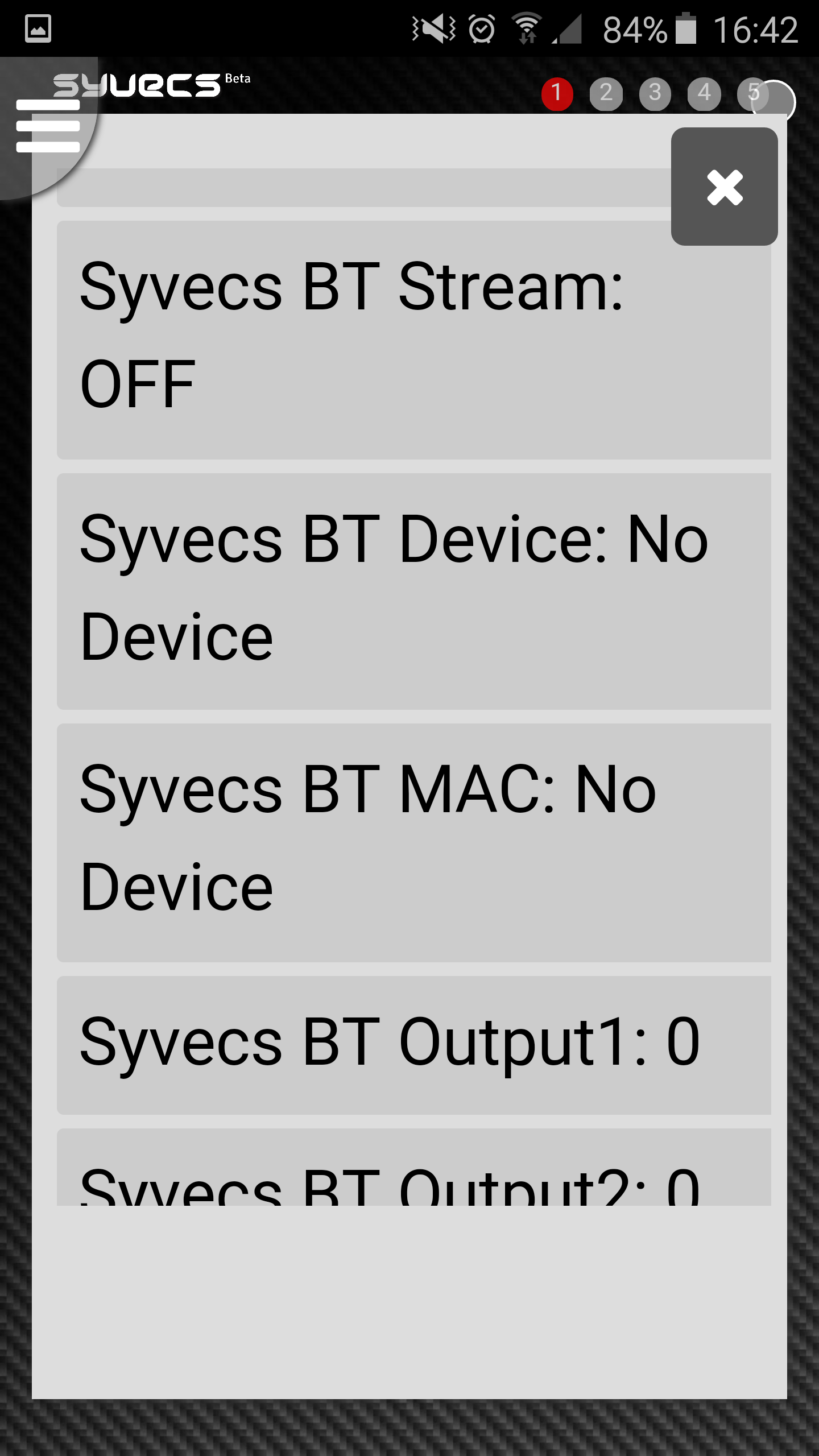

Tidgy
Posts: 22
Joined: Sun Nov 30, 2008 3:16 pm
Re: Syvecs Android App Chat - BETA Now Available!!!
Post by Tidgy »
other settings

Thanks.
I see it says live, do you get data if you enable the stream?

Post by Tidgy »
Data is coming through when the right setup is on there.
