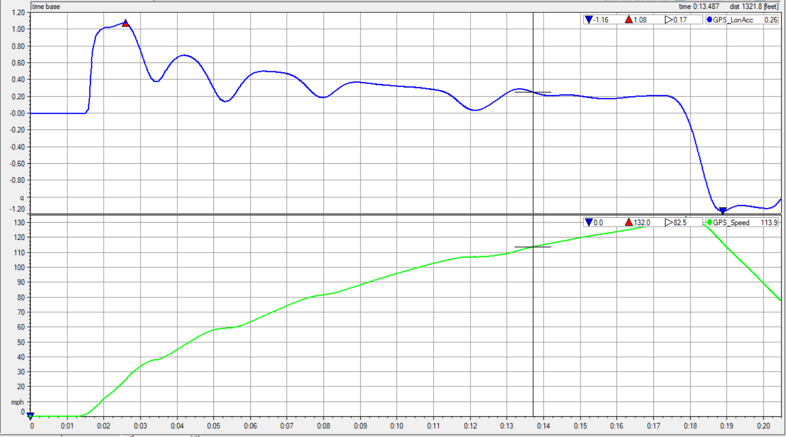

I'm using an organic clutch as it's my daily driver, so don't launch the car with huge torque, only 1 BAR boost, but it's spinning up all 4 tyres and pulling 1.1G on road tyres on normal tarmac now. It could be quicker if i had a better clutch and was prepared to risk the drivetrain. It's quite impressive for a full weight road car with stock transmition and an organic clutch. 0-60 is 3.7s and 1/4 mile is 12.1s, anyone who knows how slow my shifts are would see that as pretty good for a proper road car, with me onboard it's weighing 1560Kg and has about 460BHP/lbft on pump fuel. Tyres are 235/40x17 Michelin Pilot Sport 4, just a decent normal road tyre.
The trace below is from my AIM Solo GPS logging doing a standing 1/4 mile on average grip tarmac and then straight into a flying 250 metres. The most I've seen is 1.19G on a fairly rough tarmac surface. I've not launched the car on a high grip surface, but limit is my clutch anyway.
