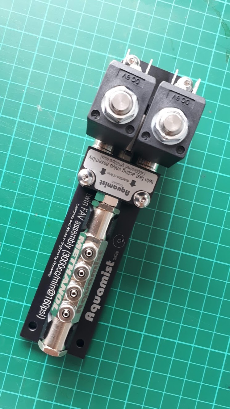

Ah only thing I can contribute is have 4 different cars on longer term test *running since ~2017* using the Aquamist combine twin HSV and flow meter manifold unit. I cant vouch for accuracy of the flow meter but they seem repeatable,reliable, and durable so far.Lqqk wrote: Tue Feb 01, 2022 12:02 am Any recommendations on a flow sensor. I’ve been researching and currently haven’t found anything that looks perfect

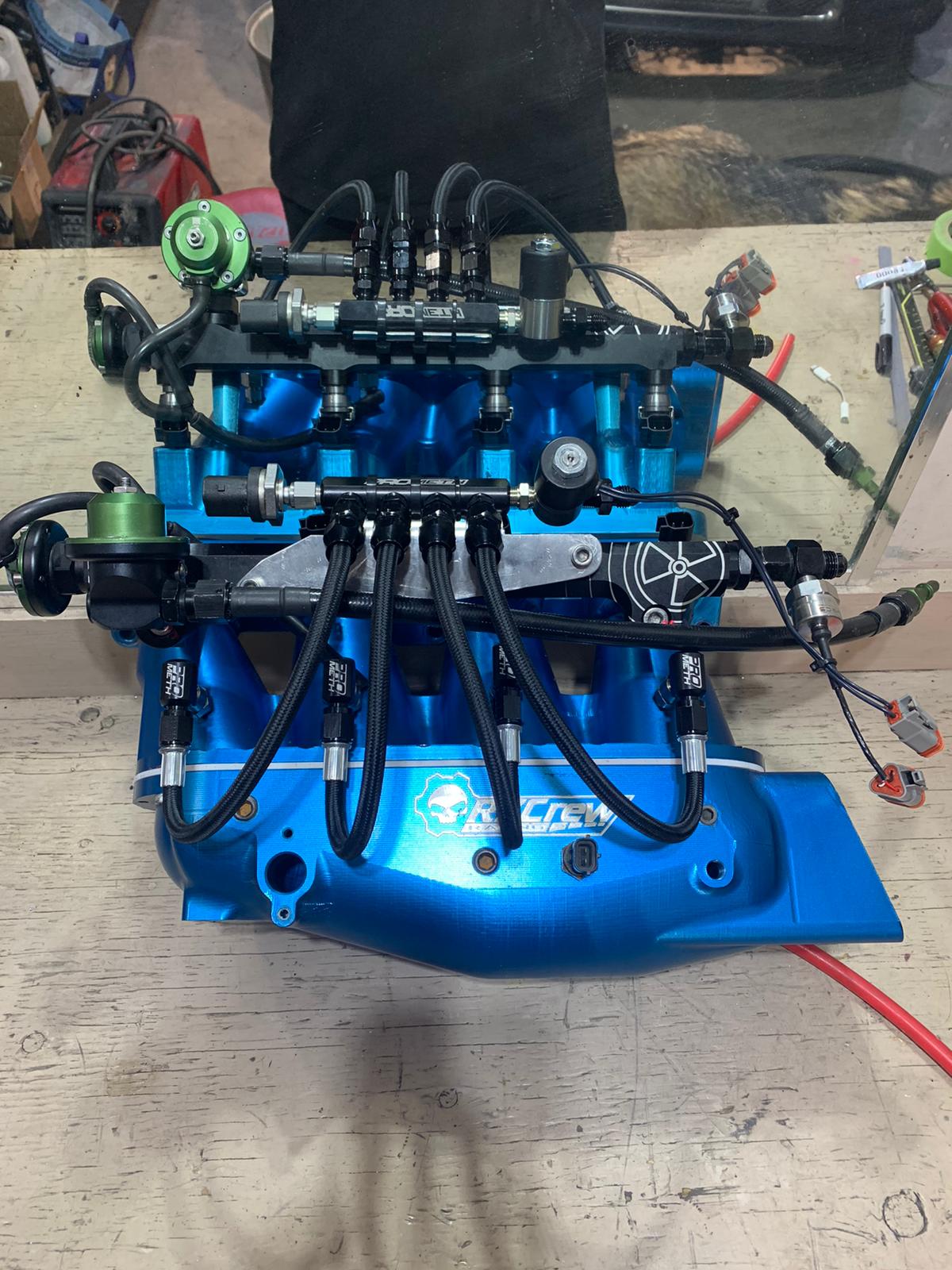

Here is a 'ghetto' set up doing with just control by Syvecs S7 ECU.
There are many ways to do WMI so if anyone is interested and does not want to do it themselves etc hit up the squirting specialist
