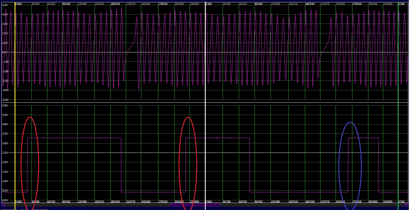

For the basic trigger...the width of the teeth dont matter as much....as where the rising or falling edges are, and which you choose to use.
You could just open manual cam checklist and open a small window in one phase that sees one edge only that is unique to that phase, and ignore the rest. That would get you into 720 in a very basic sense. Doubt it would be any use for the VVT aspects though, and even if it was you'd need to make that window wide enough so it's always seen in the chosen location with VVT movements taken into account.
But it looks like a 36-2 crank, fairly common with Toyotas, cam as below.
This screenshot shows a full 720 cycle, from where you've told it TDC cyl1 ( and whatever cyl it pairs with too ) in relation to the missing tooth.. If we assume for now first half is 0-360, and second 360-720
In the first phase, we have 2 distinct rising edges. But in the second phase only 1 rising edge. So you could do two cam checklist windows just like that. 0-360 and 360-720, expecting to see 2 teeth in first, and 1 tooth in the second. ( with cam sensor configured for rising edge etc )
Or if you chose falling edge, it would be the other way around, with only 1 in 0-360, and 2 in 360-720.
If you did it like that and it wouldnt start as it's 180 out...you could just change from rising edge to falling edge instead of swapping the checklist.
0-360 yellow bar to white bar, 360-720 white bar to green bar. ( assumed as I do not know where your actual cyl 1 is )
toyota cam trigger.jpg (342.57 KiB) Viewed 73478 times
Or email Syvecs support....they'll be better at it than me lol.

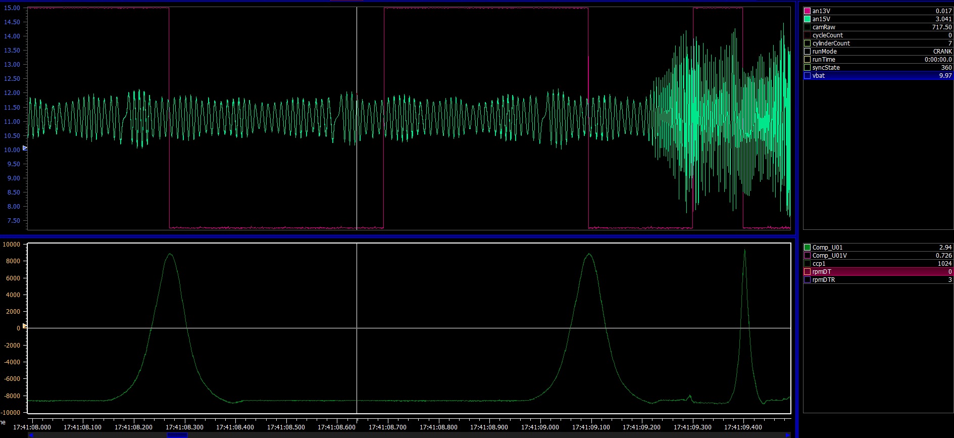

or to find cyl 1 TDC relative to the crank teeth on a log ( if you cant see the trigger to do it manually or something )
green line at bottom is a pressure sensor hooked up to cyl1. Top graph is the raw AN crank/cam, in my case 36-1 with just a large single tooth for phase.
Here TDC cyl 1 can clearly be seen at the falling edge of the cam tooth, and you could count teeth or scale to get a starting crank ref tooth angle ( in my case 301deg ATDC )
Would be nice to be able to overlay a 720 cycle between chosen points in SView.
cyl1 pressure.jpg (282.3 KiB) Viewed 73476 times
