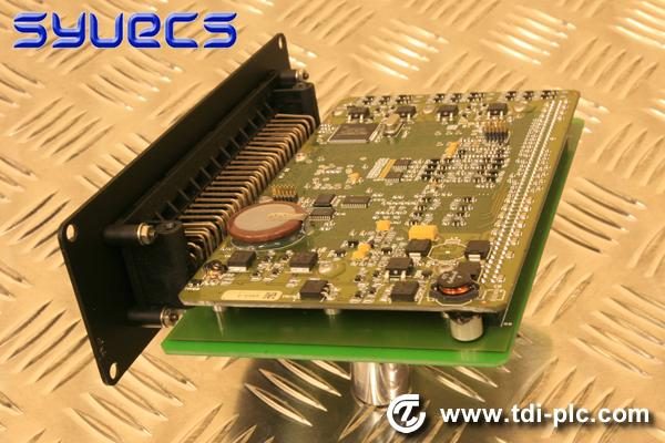

There definitely is a battery on the board

This was linked ages ago by an F88 user as the battery for one of those.
Whether its the same across the range or not is another matter. That and considerations of any abilities to change it...and the risks with doing so lol
Looks possible though
https://uk.rs-online.com/web/p/button-r ... lsrc=aw.ds

Hi,
It's possible that this battery is simply going flat as the car is not used for long periods of time, and not for a great length of time when it is.
So I've powered the ECU up out of the car on a bench loom that I have and left it for a good few hours to see if that will help.
Failing that it may have to go for repair.
