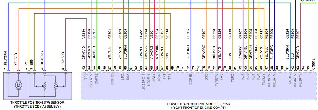

The two H-bridge outputs should be enough to control the DBW throttle, below is the factory ford schematics

DBW motor is generally 5-6Amps and fine - but, as said before, they are usually driven by a full bridge driver not a half bridge. A full bridge has control of both sides of the motor. A half-bridge drive may be just fine - it's just that I have no practical experience of driving them like that.

Isn't the common practice to have two half-bridge outputs designated for DBW control, thus making a full-bridge?
H-BRIDGE #03 / DBW MOTOR +
H-BRIDGE #04 / DBW MOTOR -

And I can't see a way in SCal of assigning a pair of half bridges to a DBW motor. But maybe with the GDi4 that's the way to do it - I don't know - hence the suggestion to ask Syvecs tech support.

The normal way of driving the DBW though from say an S8, IS with two of those outputs, even if only one is specifically assigned.
ie, +ve to HBridge 01, and -ve to Hbridge02 assigned as full bridge.
Or for a positive 12v PWM trigger to something instead of lo-side ( in my case this is a time delay relay that needs a 12v trigger ), I have this wired to HBridge03, and nothing to Hbridge04, again configured as full bridge.

yes, but the GDi4 spec does not mention it having full-bridge capability. It's probably just not written very well. But I still commend checking with Syvecs as these little things are there to bite!

mmm good point. But if it's based on an S8....surely it would have ?
