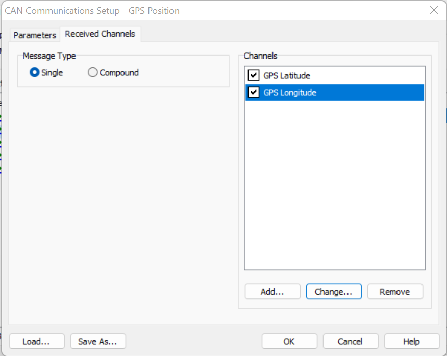

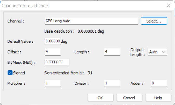

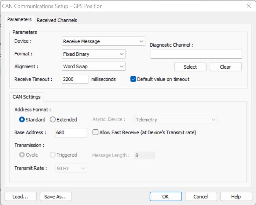

Here are the current C185 Coms parameters which work with a single receiver:

Only way to differentiate between the 2 GPS receivers is they each transmit data using unique CAN IDs. There's nothing you can do at the MoTeC end to magically distinguish data that is received on the same CAN ID from 2 different devices.
I don't think there is a user interface to change the CAN IDs on the 2 receivers so easiest will be to use 2 different CAN busses.
