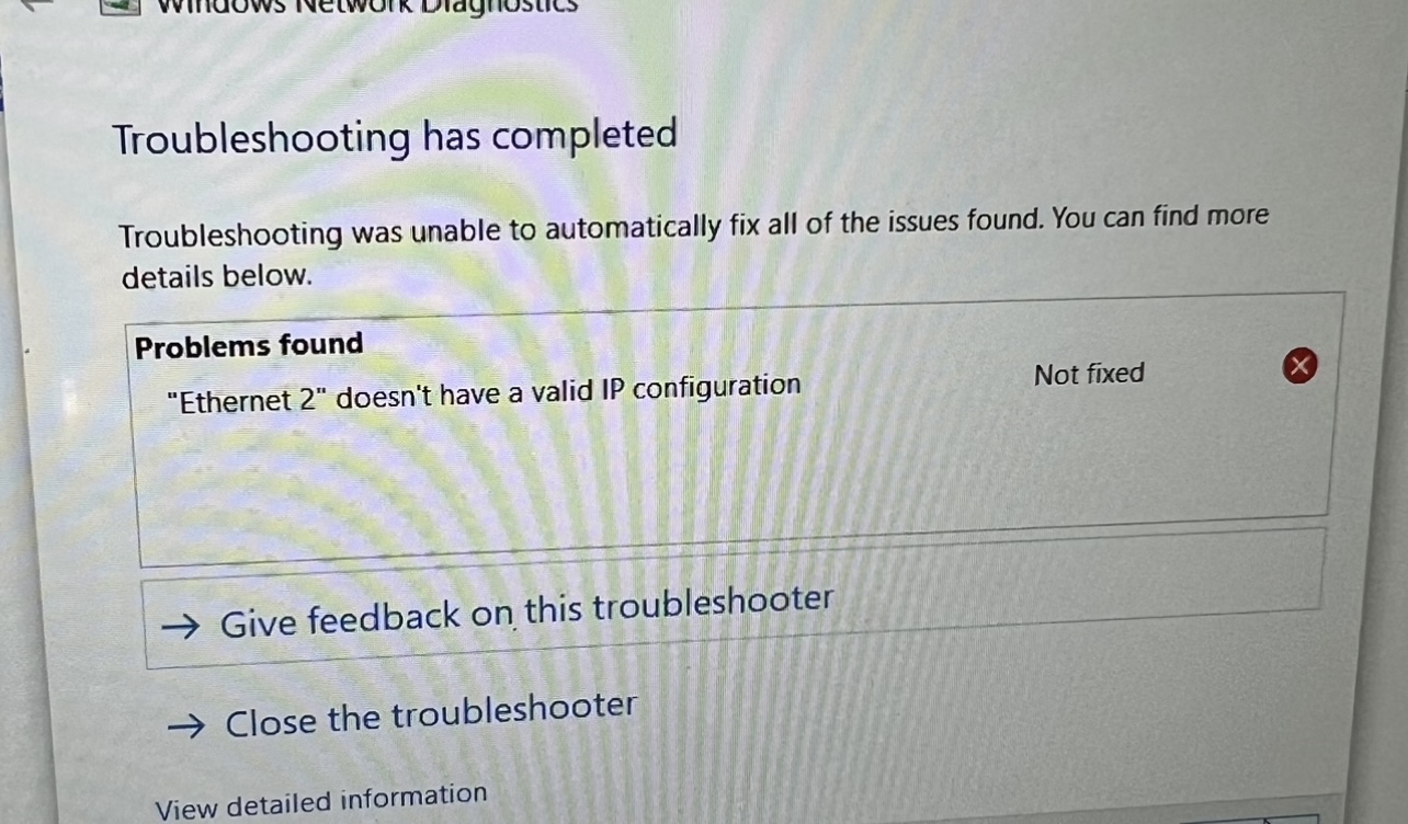

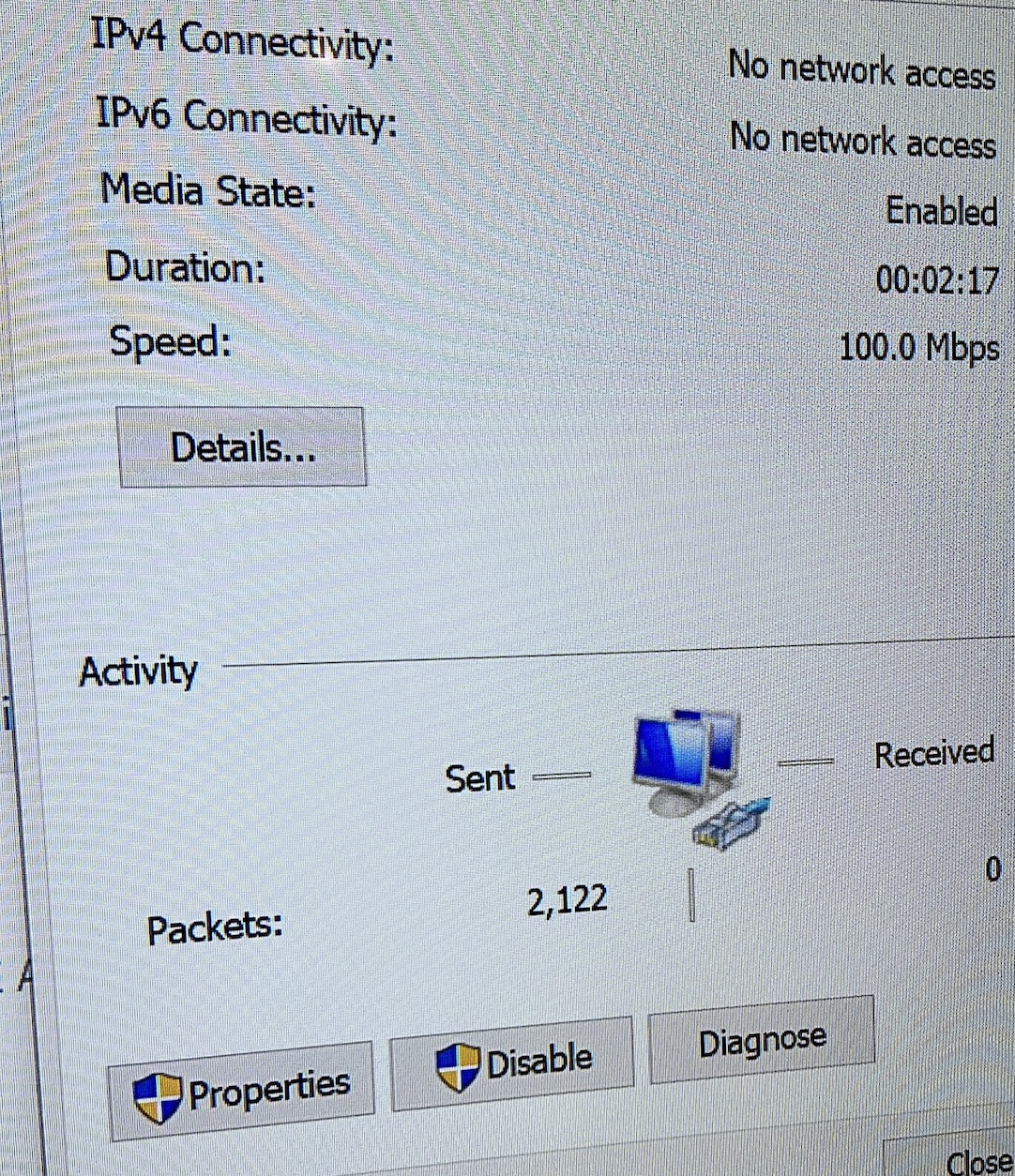

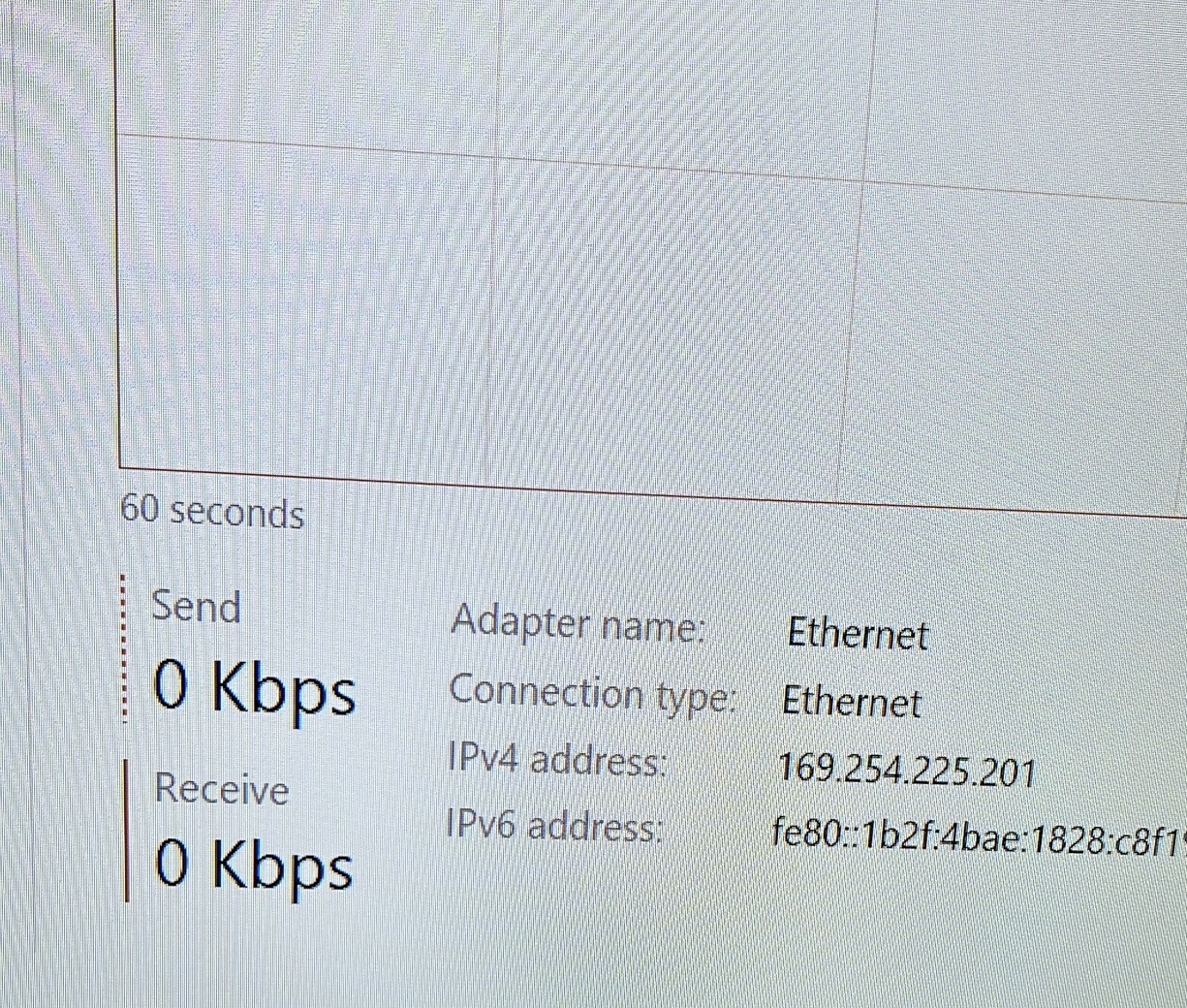

Hey neex help connecting to syvecs
Hey guys So i tried 2 dif laptops and 1 pc to connect to syvecs s12
When i try to connect to syvecs i have it on table all power and ground connected and the 4 ethernet wires
Software says no device found
I am using win 11
My pc shows a network is opened and there is a ip address populated
Please help thank you
I am using win 11

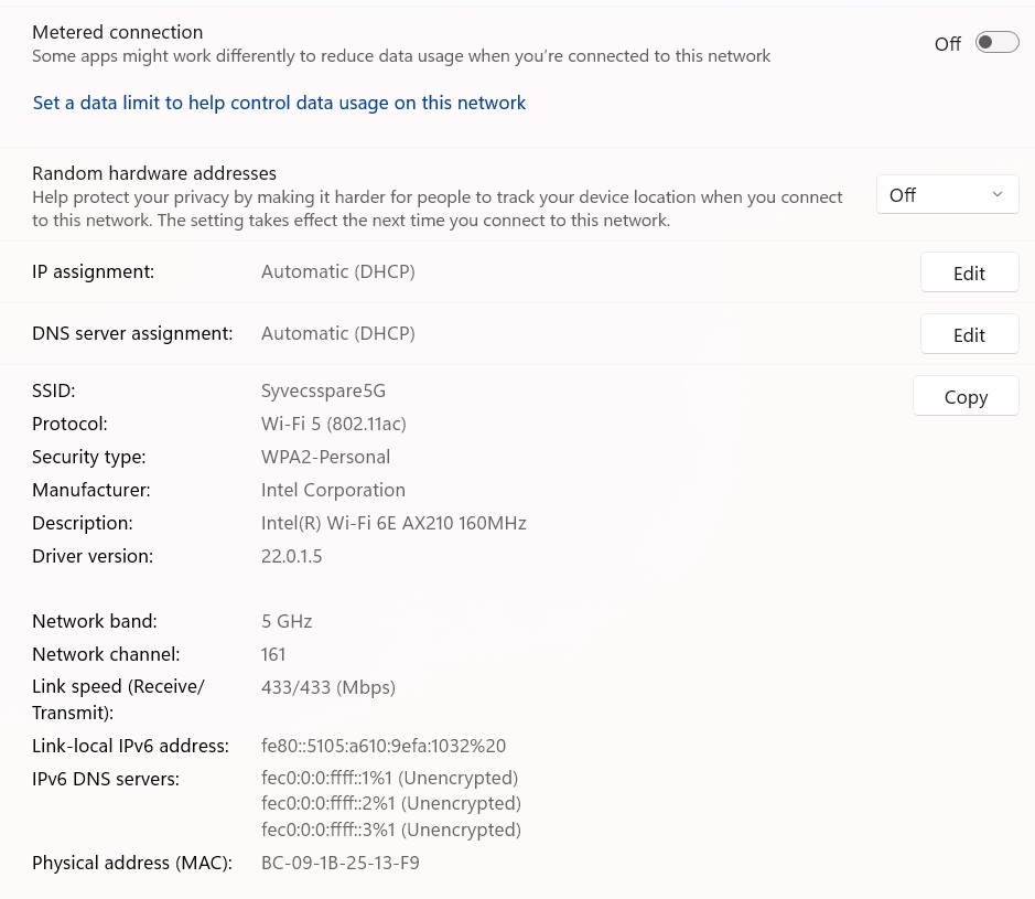

Can't comment on whether it should or should not appear like that.
I've plugged a spare ecu into a Wifi router, and when connected to my W11 PC sitting here via WiFi, this is how my config appears, 5G Wifi connection
And annoyingly...again the RTC clock battery is flat. This was changed only a year ago !

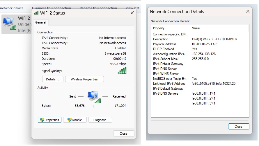

Re: Hey neex help connecting to syvecs
and from control panel info
