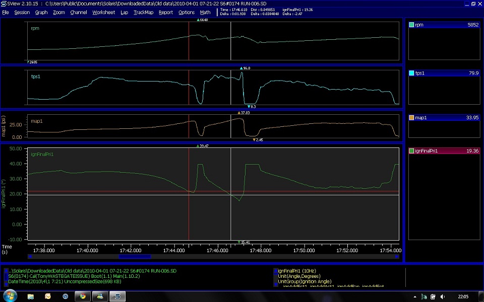

When you create custom worksheets with multiple graphs with selected channels in SView and save it, if you swap to another worksheet and then swap back the channels are still selected on each graph (as you imagine it would be) but the Y axis and it's corresponding title are not shown.
It's possible to get them back by hiding and showing the particular channel you're looking at, but is just a bit of a pain.
I've attached a screen grab that shows what the problem. The top two graphs have the Y axis missing, the bottom two I've de-selected and re-selected the channels to re-show them.

Duly replicated and reported to the PC Software wizard... watch this space :)

Just a quick update, the next release of the PC software should have this fixed, should be ready within the next couple of weeks or so....
