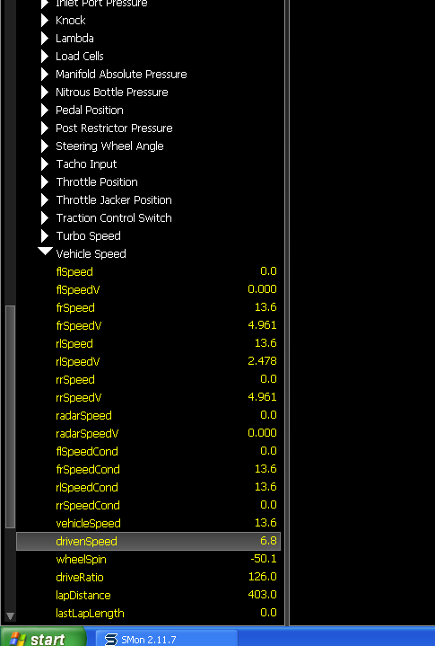

pavlo wrote:So your rlspeed is not working, is that correct?
Yup, rrspeed - shows voltage on rrspeedv, but against rrspeed it returns a zero when the car is rolling and the frspeed and rlspeed is... see pic below (whilst car was pottering in 2nd gear.
Screen Shot 2012-05-23 at 15.00.23.png (21.48 KiB) Viewed 28915 times
so this could well be the missing feed don't you think?

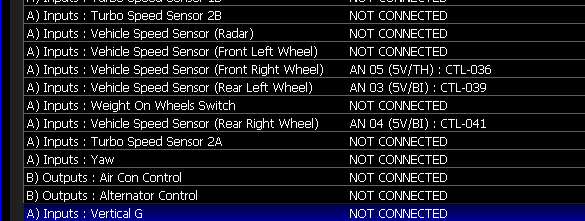

these are the pin assignments for your info...
as suspected the fr was wired in only, fl is not, hence negative values for fl...
Screen Shot 2012-05-23 at 14.50.30.png (13.61 KiB) Viewed 28922 times

The front sensor is on a thermistor input, and I suspect may be connector via a reluctor sensor level converter.
However, it is not enough to look at the a snapshot of an instant in time, you need to either use trace gauges to see the waveform, or log the channel at say 1000hz for short time and look at the results, you will need to use SCfg to config some alternative logging temporarily and Sview to look at the logs. If you can't do those things then you really need to think about getting an expert in to do it for you, or learn quickly how to do it.
You need to appreciate that the wheel speed sensors are giving pulses or some other waveform, not a voltage that only varies with wheelspeed.
But as I have already said, you need to look at what you've done, look for for broken wires, shorted wires, contacts not fully home etc. It worked, you did some stuff, now it it doesn't work, 99.99% of the time that means you done fucked it up! Retrace your steps.

Posted: Wed May 23, 2012 8:32 pm
by pavlo
Have you changed ANYTHING in the sensors menu?
It looks like the rr sensor is configured as a thermistor input rather than a bipolar given that the voltage seems to be a static 4.961.
Re: newbie question on ABS feeds and softwear interpretation
Posted: Thu May 24, 2012 9:22 am
by pat
Gents,
AB04 is not capable of Thermistor operation, BUT it does have a bias pull up and divider which takes the -5V / +5V range and turns it into 0V / 5V for the analogue to digital conversion. If the sensor goes open circuit then the bias resistor, although much weaker than a thermistor pull up, will be the "strongest" element and send the voltage up to +5V. Also note that the anXXV values are not scaled, so AB4 should be sat at 2.5V when there is no signal, although rrSpeedV may / should read zero.
