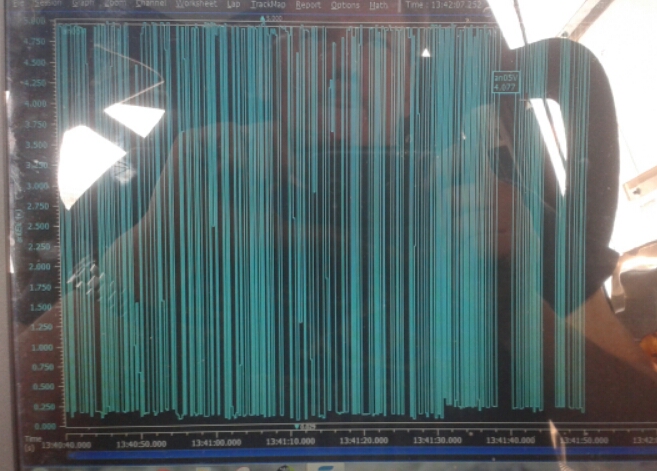

At the track and tested. Speed seems stable with the filtering, but logging on thermister / an05 shows massive fluctuations.
See pic. At constant speed or idle the voltage is flipping from 4.98 to 0.1 for example.

Re: Impreza S6 PnP - Vehicle Speed / Radar - filtering
Posted: Sat Oct 03, 2015 2:23 pm
obviously the voltage at speed will be switching high and low, that's just how the sensor works.
When stationary though it definitely should not be.
