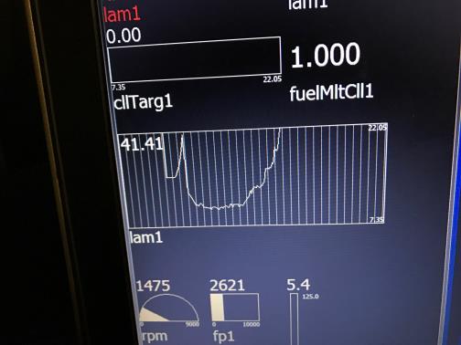

...I also managed to snap the moment the sensor died (prior to me logging) with my phone...
- Lambda failing.JPG (25.54 KiB) Viewed 104095 times

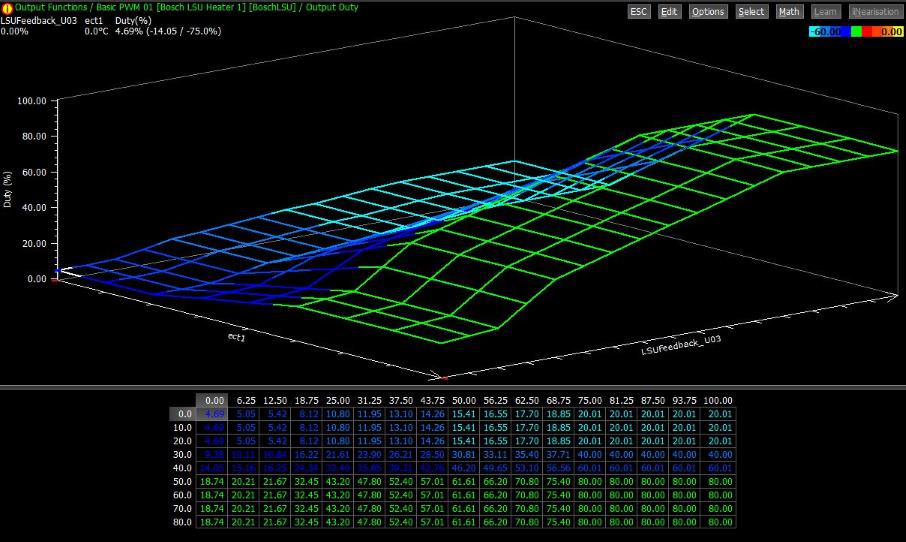

I've spent more time looking at this and found the datasheet relating to the Bosch Lambdatronic LT4 controller to be of help.
I got to suspecting it was no coincidence that my sensors began failing as the weather turned cold.
My theory is that with the colder weather comes additional liquid phase water in the exhaust and for longer so an increased risk of water getting on the cold ceramic surfaces of the sensor and causing premature failure....and to add that increased thermal shock as the sensor is quickly heated from a lower starting temperature.
Looking at the LSU 4.9 control I have on the S6Plus it does not look like there is any sort of dewpoint delay at all. So as the ign is switched on an the engine
fires the sensor's heater receives full heating voltage and starts rapidly heating immediately. I looks like a typical dewpoint delay for the LSU sensors is around 30s (and typically this delay is triggered below ECT of 50 degs) - during this persio the sensor is heated but at a lower voltage (rate) - what I don't know right now is exactly what that reduced voltage should be.
I can't readily see that I can modify the heater control output duty table to runTime (or indeed ad an ECT trigger) but I see that I can swap out vbat for ECT and so create a calibration that heats the heater at a lower rate as ECT is low and does not allow full heating power until the engine is warmed and so hopefully reduce the risk of water ending up on the hot sensor.
So the heater output duty table becomes something more like this:
- heater_control_ect.JPG (81.09 KiB) Viewed 104032 times

Not sure it's a good idea to omit the VBat correction, otherwise the heater volts will be wrong.
LSU4.9 heater should be ramped up at 0.4V/s and shouldn't really be started until the engine's running; and limited to an effective 2V during the condensation phase...so the critical question is how long that is. I've used 8s in my expander, but maybe 30s is more realistic and not a big deal for a performance car where start-up emissions are less critical.
Probably best to speak with Pat as he may be able (and maybe even willing!) to rework the GP+ firmware to sort this.

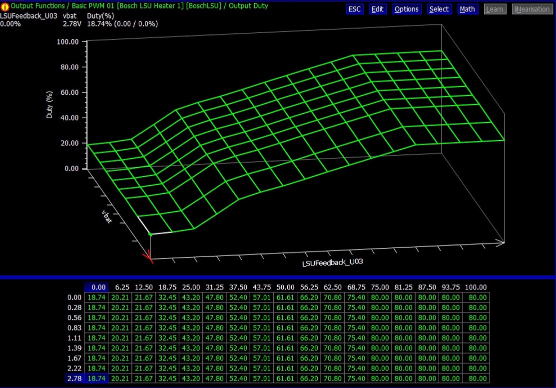

Thanks Tim - thats useful info on the heater initiation - I'll have a word with Pat and see what f/w related possibilities there are
I'm not sure I actually ever had actual working vbat correction - I should have really posted a before and after - but below is the **before** showing the vbat against LSUFeedback_U03 - I had assumed vbat was only in there are *something* had to be!
- heater_control_vbat.JPG (299.32 KiB) Viewed 104018 times
