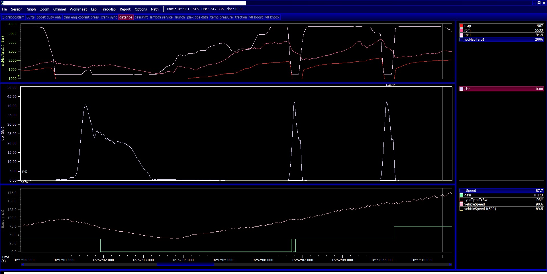

I was thinking of the same thing regarding the pressure sensor in the clutch line, how well does it work?
Do you have a log of a full clutch displacement vs pressure? I'm interested to see how non linear it is to displacement. I understand that you probably won't have a log with actual displacement displayed, but just a graph showing a full stroke of clutch pedal to the floor over time would be cool to look at.
I saw a video on youtube of somebody testing a clutch lines pressure (pretty terribly) and it seemed to peak and then drop again, which made sense, but ultimately put me off the idea. My next idea was to use one of those cheap landrover air suspension height pots to measure the pedal displacement instead.

The graph will vary depending how fast you operate the pedal really.
So from a point of view of triggering a flat shift....it should be pretty reliable as you'd trigger the open loop cut on the up-voltage somewhere....where you decide.
But at least it is something you can easily adjust, whereas a switch on the pedal would require more trial and error.
On the S6 I had it configured as the gearcutvoltage input, the S8 seems to be more configurable as you can tie the clutch switch input to an analogue signal and set the threshold that way.
Although havent actually looked if you can then use the clutch switch input as the trigger. Either way, there are options and it can trigger via a pressure sensor.
Short glimpse a section of a hillclimb, going 2-1 into a chicane, then 1-2, 2-3 so 3 clutch operations, logged at 50hz. Latter 2 approx 0.4s duration from rest to rest.
Most of the falling edge side of things would exhibit the little step on the way down. As to how far my diaphragm goes over centre etc...no idea.
Initial 2-1 downshift, clutch operation is much slower.
No flat shifting etc anywhere here

Brilliant, thanks for sharing that buddy that shows it perfectly.
That's a lot more consistent than I thought it would be too, to be fair. The 2-1 being much slower than the 1-2 and 2-3 are still all within a reasonable range regarding peak pressures, I'm liking this idea again now. Interesting on the little blip bit on release, must be the pressure plate landing back on the friction disc?
