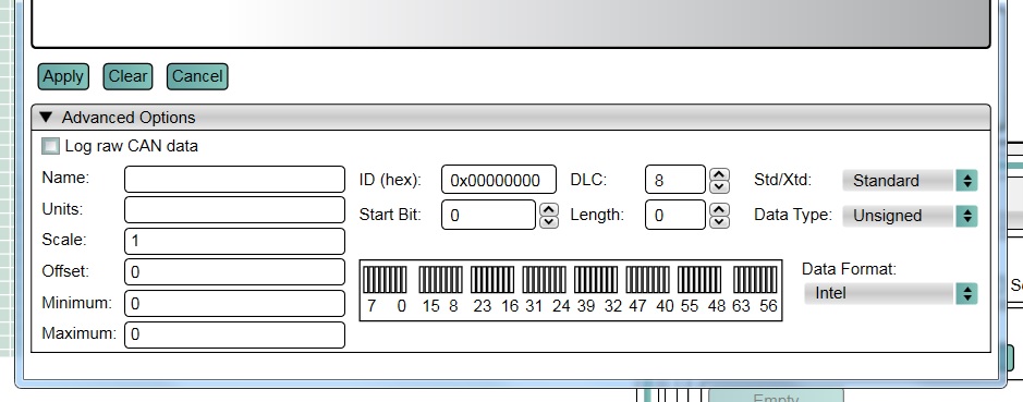

vbox can.jpg (86.61 KiB) Viewed 16563 times

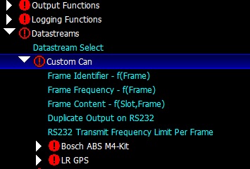

SCals settings are all within this area
Syvecs CAN.jpg (30.5 KiB) Viewed 16561 times
And actual content is in the frame content selection from the above menu.

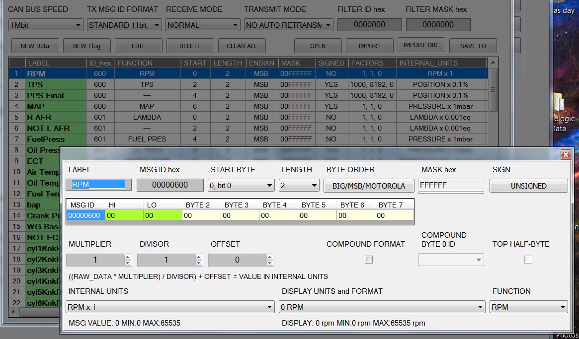

What might be a little more helpful, is the CAN config Plex Tuning use for their SDM dash displays etc. Here is the first item RPM and how it is configured, it shows more data but they will all follow a similar pattern.
Plex CAN.jpg (259.23 KiB) Viewed 16559 times

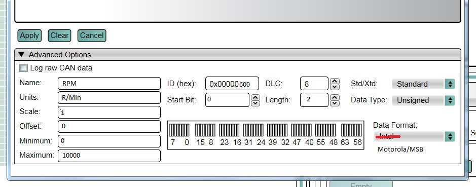

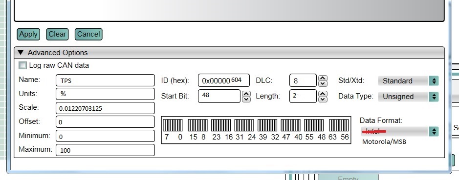

I quickly edited the screenshot Stevie posted with the correct values, based on what you reported from SCal. It should give you an idea of how to get the values you want from SCal into the vbox software.
Scale is a multiplier, so if SCal reports x/81.92, the vbox software wants x * 0.01220703125, which is equivalent.
vbox RPM.jpg (88.99 KiB) Viewed 16540 times
vbox TPS.jpg (88.23 KiB) Viewed 16536 times
