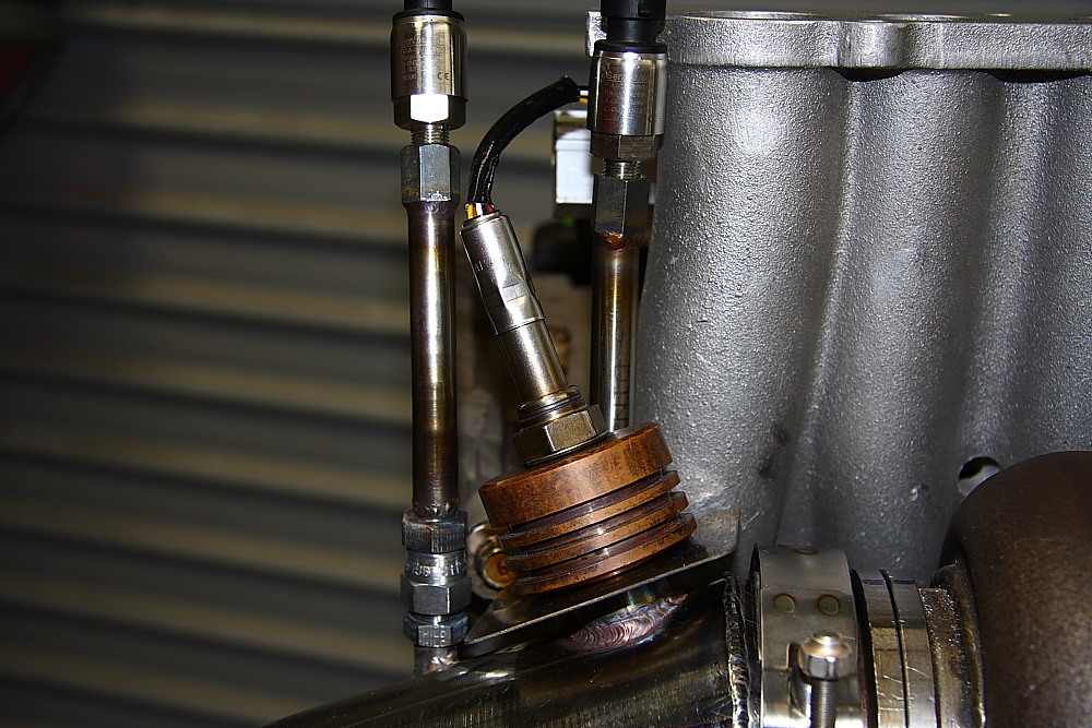

Your EGT is very low on the run you sent me so no reason why you could not run the sensor closer to the turbo outlet (right on it) like this below.
This is using a racing quality NTK sensor with special heat sink I made. NOTE: This uses one of my self made internal 347SS remote sampling chambers using venturi effect inside a solid copper heat sink. I tested this to constant 1150deg C for 2 hours straight on the sample probe end and the hex temp was never over 550 deg C :D
