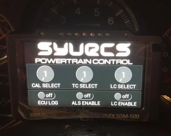

The new Plex firmware combined with the S8 is really a treat. We now full implementation of all 3 trim switches and 3 digital switches through the dash. The S6 and S6Plus are limited to a single trim switch. All of the switches are now user definable as well.
Re: Connection to Plex
Yea, that screen never did work correctly with my S6.
That said, I would never want to use that method for actually changing cal anyway. I like the simplicity, speed, reliability of a rotary mechanical switch I can always get a visual on.
So I dont even use that screen at all now.
Although it's handy that the Plex does a pop up when you change Cal too.

I run a Syvecs S6+ with a SDM-500 GPS Syvecs Edition in my Mitsubishi Evo and this combo seems no to work like advertised. :cry:
The cal-switches on the dash and the datastream back to the syvecs are not working properly. I can’t dial the maps via the Plex and the syvecs cant receive, for example, the GPS Data.
My mechanic contacted both Plex and Syvecs and it seems, that the firmware of the S6+ Is the problem.
The Cal/TC switching via the dash has never worked as far as I am aware.
It can work for the S8 I think though, but the S6 CAN is the limitation. But TBH....a nice mechanical switch really is a better option.
