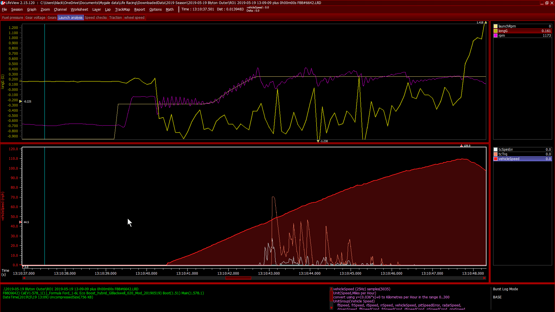

Q) What key do I need to press to get the data to appear inset in the graphs, like it shows on Ryans's Syvecs training videos? (see attachment)

Re: Launch Control Settings
Options, All Toggle Options, Show items in graph.

Thanks I'd never have found that.
