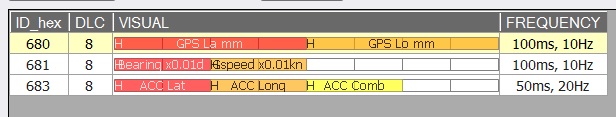

I'm looking for the can bus details.
So what the frame IDs, and payloads are for all the GPS and g values.
Any help is appreciated

I have another device which I can confgure to output CAN frames, I would need to know the frame IDs to use and how to populate the payload.
So yes, I want to try and use a third party device if possible.

Re: Broken link to GPS manual
From the Plex config
plex syvecs can.jpg (29.46 KiB) Viewed 35334 times

Thanks Tim,
That's exactly what I need :)
