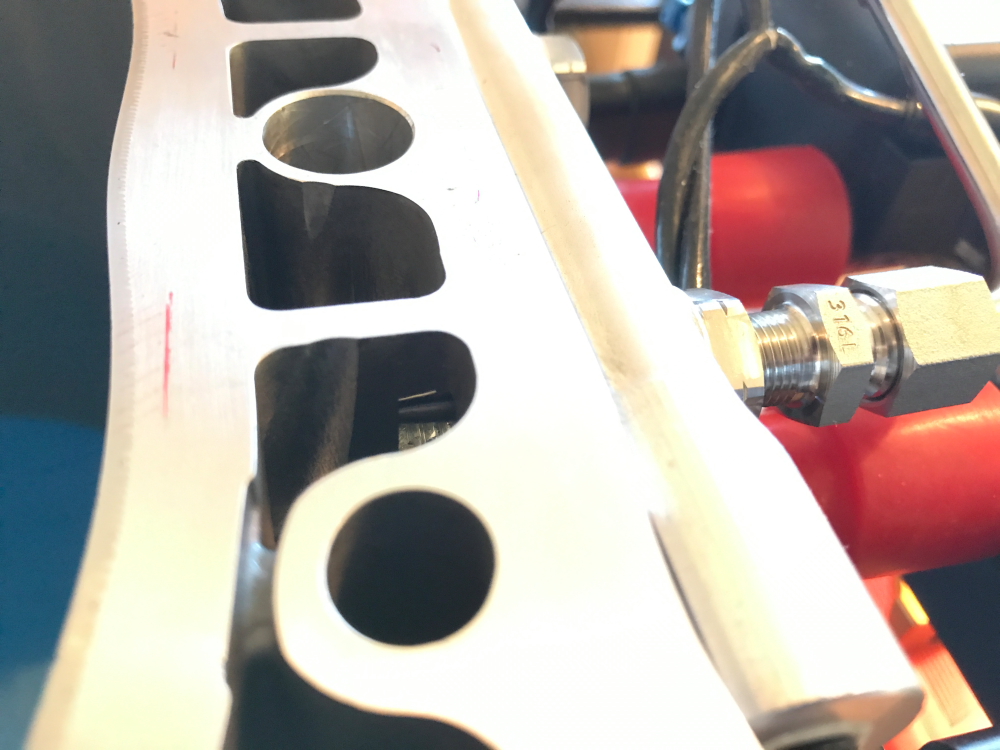

Finished RHT fitment

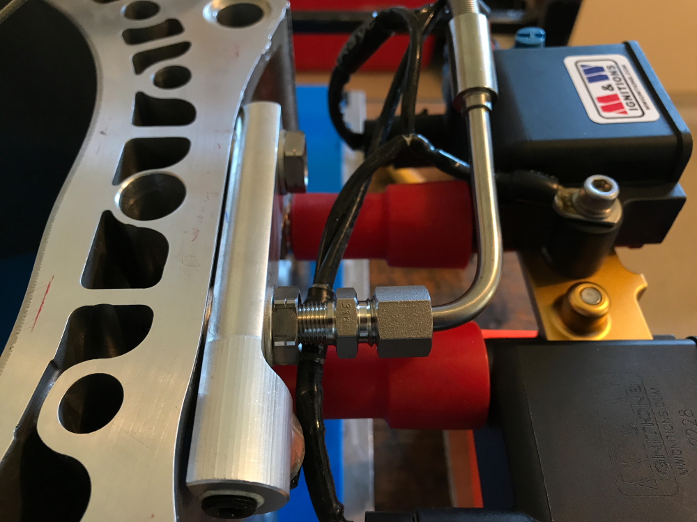

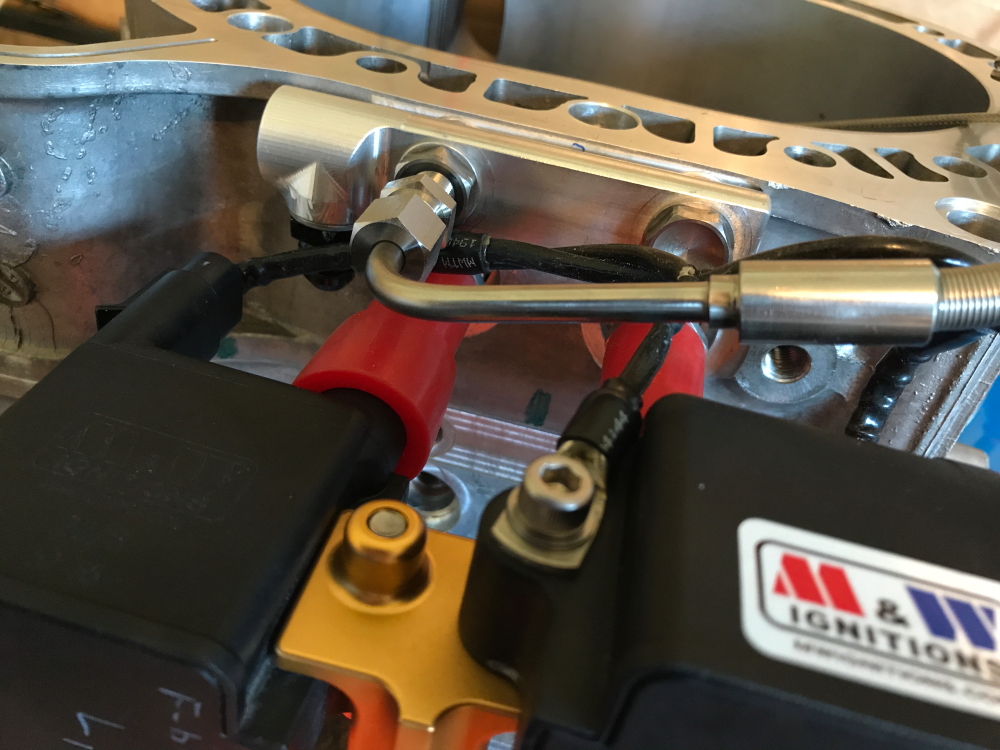

very nice work! that's exactly what I was up to (CHT)... decided to not bother with it for now but might go back to it one day.
out of interest, are you using a thermal paste or similar between probe and head?
Re: EGT probes
rac wrote: Sat Apr 18, 2020 2:38 pm very nice work! that's exactly what I was up to (CHT)... decided to not bother with it for now but might go back to it one day.
thanks.
I've got it as a slightest clearance fit at the sensing tip and outer jacket on the necked down section if I put anything in there it would cause hydraulic and not allow it to be pushed in. Will see how it goes, I know already what it will read and it will show up rotary turbos fundamentally as the total shit box's they are known to be :lol: thus no one uses them in any 'endurance' form at high specific power to be competitive against a normal engine :lol: :roll:

yeah I was thinking smearing the side rather than the tip and rotate it gently in to allow excess to be pushed out
the data you get will be interesting with and without WI, might help optimise WI volume. and also will be interesting if you can get a decent AFR character curve out of them (CHT v AFR) in steady state conditions, something similar to which I assume you did with the egts for cylinder trimming purposes. that's what I had in mind for them anyway.

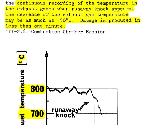

Damage produced in less than one minute ?
Well yes....I'd say less than a second or so lol
Presumably their tests are on a static low speed motor ?
Re: EGT probes
stevieturbo wrote: Fri May 01, 2020 3:34 pm Damage produced in less than one minute ?

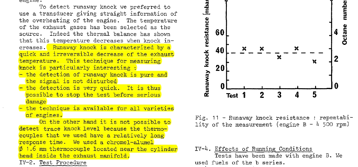

Their test is 5000rpm constant speed, pretty good test actually. They use rotary encoder pressure transducers in cylinder along with acceleration sensors on head and EGT probes.
In my own case using same set up minus the pressure transducers I have seen same drop in EGT, no noticeable loss in engine power, but an increasing 'average knock' but not enough to trigger the normal threshold as average is increased, with resultant drop in exhaust gas temperature. Seen this in very quick time (see previous tests by me of latency) and over a time sample ranging from a second to multiples on a transient WOT test in real world acceleration.
This pattern of increasing average knock but not enough to trigger an event threshold with this hindsight is something I found on a raft of different engine types (all recorded on these ECU's) and something I struggled to explain before but with the EGT probe it is now backed up. Glad I found this as it makes it nice to see someone else found the same things!
In the same report they do go on to say that the trace knock is sometimes hard to differentiate but it always shows up quickly on the thermo couple fitted in the exhaust. I did re read it a couple of times and they fitted the same probe to do CHT but it was not as fast however eventually it did show the pressure waves modifying the thermal exchanges at the walls of the combustion chamber and thus the heat carried away but the cooling system.

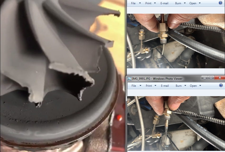

Here is what 1160 deg C pre turbo EGT does to a Garrett turbine wheel :)
All 6 donmega Type K thermocouple probes are still working as new, despite small bend from the abuse :shock:
Great way to test durability though :lol:
molested EGT 1160+deg C.jpg (322.32 KiB) Viewed 40835 times
