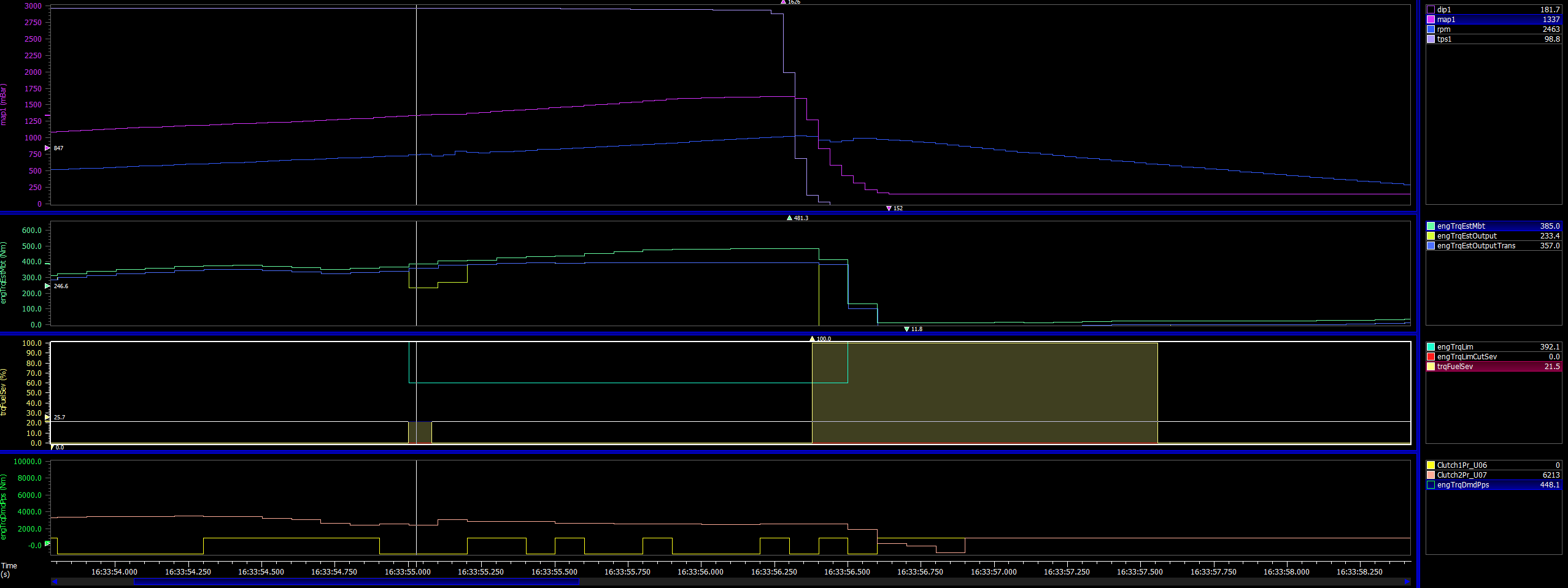

Thank you for your response. I need to figure out how to shorten the clearing time because during that time trqOutput to the trans is ramped back in too slow.
Here's a screenshot if it's helpful at all:

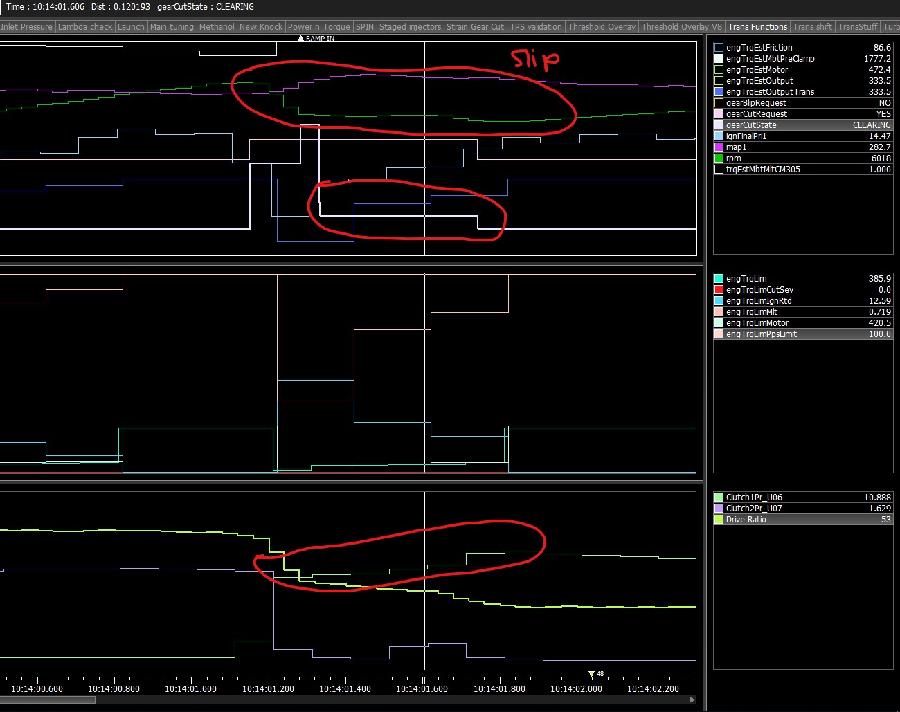

Upon further review, it's looking like there might be something wrong/flaky with the gearCut/blip request. I have a log earlier showing a gearCut request during a pull in 2nd gear.

The gear cut request is a flag that comes from a Message on the TCM (Trans control Module) with DCT plug and play kit for when Torque Reduction request is Active. If the TCM is wanting to reduce the Torque this will come active and the Engtrqlim will drop also which is the parameter from the TCM to telling the torque control on the Syvecs what amount of torque the tcm wants.
The Clearing state is when the gearcut time has gone past the amount set in Scal but request is still active.
The EngtrqOutput ramps in slowly as the syvecs is doing as the TCM wants based on the Engtrqlim. You need to either pull more torque to get the TCM happy and see no clutch slip or your cluch is not man enough for the actual Engine Torque you have.
If you are making more actual engine torque then what the OEM TCM was designed to see then you need to modify the torque reduction amounts or have custom tables to pull more to keep it happy.
