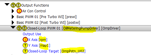

i just got a S7+ from Chris and i also want to keep the OMP in my 93'. Can you share your Cal and IO Pin assignment?
I tried to come up with some sort of Functionality that is already in the ECM to cope with OMP Control but i still struggle with the outputs.
The OMP Position is basically a Custom Sensor (OMP_Pstn_U02 in the Screenshot) and i added a CL PWM Table on top to Control the Bipolar Stepper within the OMP.

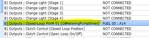

In the Pin Assignment though, i can only add one output as a H-Bridge to Control the OMP but i would need at least 2 to run it as a Bipolar Stepper and i think 4 if i want to run it as an unipolar stepper like the factory ECM does.
Also Question to the Syvecs Team: Is there any plan to implement this feature permanently? Chris told me that he used a custom firmware to get the desired functionality but i guess this would make any update to a newer firmware quite difficult because you would need to patch this in for every update.
Thanks in advance.
Best Regards
Felix
