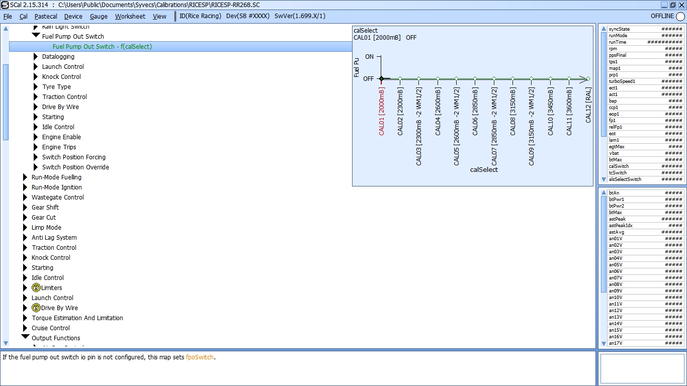

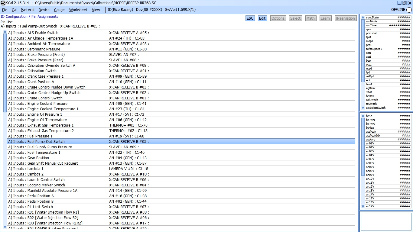

Trying to drain my old fuel, how do you manually activate the fuel pump?
Re: How to manually activate fuel pump?
You have a couple of options, either assign it as below (to an actual switch, physical or over can etc) or do it via cal switch position.
