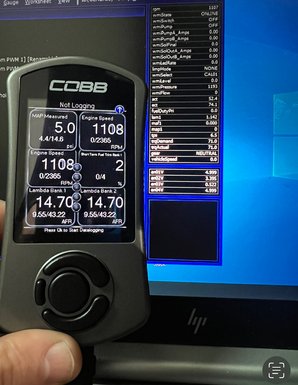

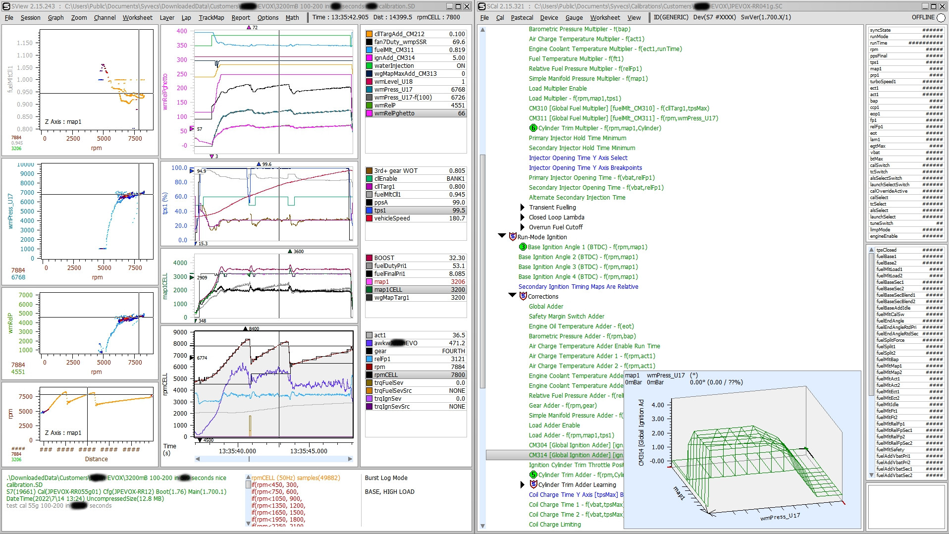

Not sure if I found a bug or some other issue - but when installed in a Porsche 991 with the 991 canbus receive, the map1 value is always zero. I’m getting both rpm and tps correctly.
Attached a screenshot and confirmed on my data logger than map single is being measured there.
Hopefully this is a bug and resolvable.

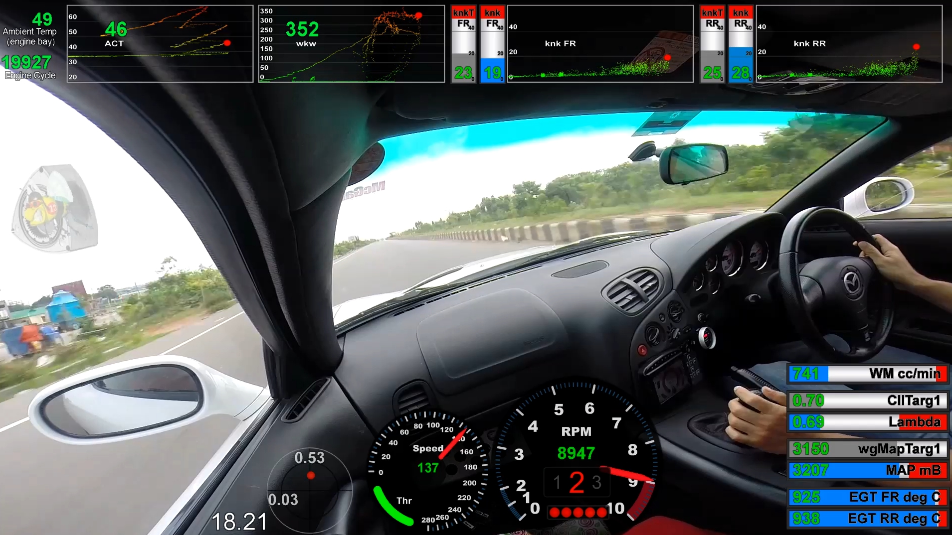

Here is a video link below showing WM integration with a couple of channels overlaid, maybe makes people more aroused than looking at squiggly lines on a data log view ?
Video > https://youtu.be/-oIOE4VBFaU

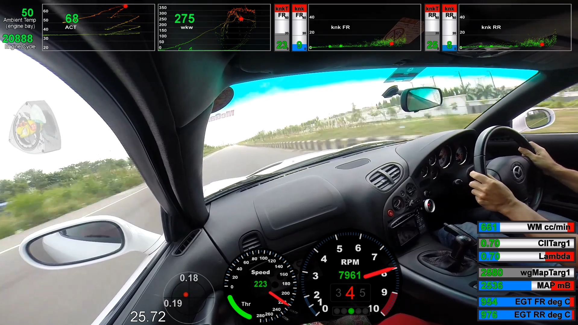

Here is a car we are doing some durability testing on, it might get people 'wet' who are thinking of doing a WM integration using just the Syvecs ECU only. This uses a variety of suppliers parts and ideas garnered over a long time but shows what you can do and it does work very well.
Do all kinds of permutations of these, on this example it makes more specific power than E85 cars with non of the well known drawbacks.
It runs low grade pump petrol (gasoline) and WM, the final solution.

I think it's quite common for MAP to be missing from the stock OBD stream. Worst case you can always wire directly to an analog inputLqqk wrote: Mon May 16, 2022 1:21 am Not sure if I found a bug or some other issue - but when installed in a Porsche 991 with the 991 canbus receive, the map1 value is always zero. I’m getting both rpm and tps correctly.
