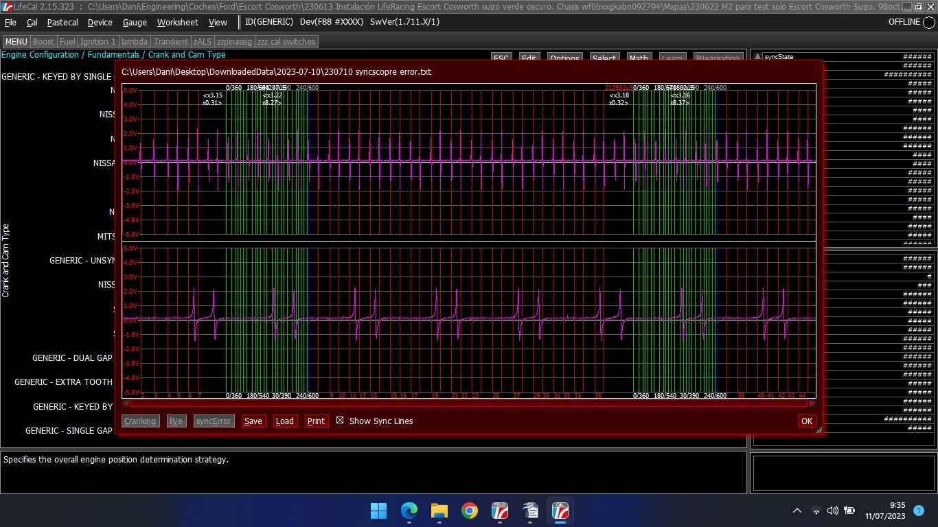

I am triying to use the standard crank and cam pattern of the Escort Cosworth to work with this ECU that has 4 equal spaced teeth in the crank and 2 teeth in the cam. I sent attached the synclog. In the past I worked with a car that uses 4 equal spaced teeth in the crank but 1 tooth in the cam, this car is working well.
I am using the option of keyed by single cam in the crank and cam type, but the car doesn't syncronice, and it appears the message of critical cam error, I tryed to use the manual cam check list but I underestand that It doesn't work with the keyed by single cam option (I can't program the ECU with this option active). I see that the syncronization is lost always in the same point.
I think that the problem is that I have 2 teeth in the cam and there isn't any option in the crank and cam type that I see that it works with this pattern.

- SyncLog Escort.jpg (375.85 KiB) Viewed 16357 times
- 230710 syncscopre error.txt
- (203.72 KiB) Downloaded 1069 times
- 230710 1614 sync scope.txt
- (199.3 KiB) Downloaded 1114 times

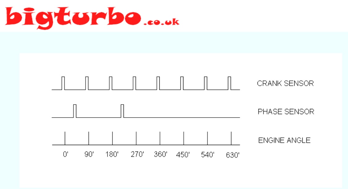

a scope trace with crank, cam and cyl1 pressure is handy so all trigger points can be referenced properly.
Although this from bigturbo.co.uk gives some idea where cyl1 sits in relation to the triggers.
4 teeth is just crap.
Not sure if it can be done or not though, I'd think it should be able to.. Have you tried the Facebook group ? It does get a bit more interest than here. Failing that email LR support, or contact some of the guys who could do it for a few quid.
