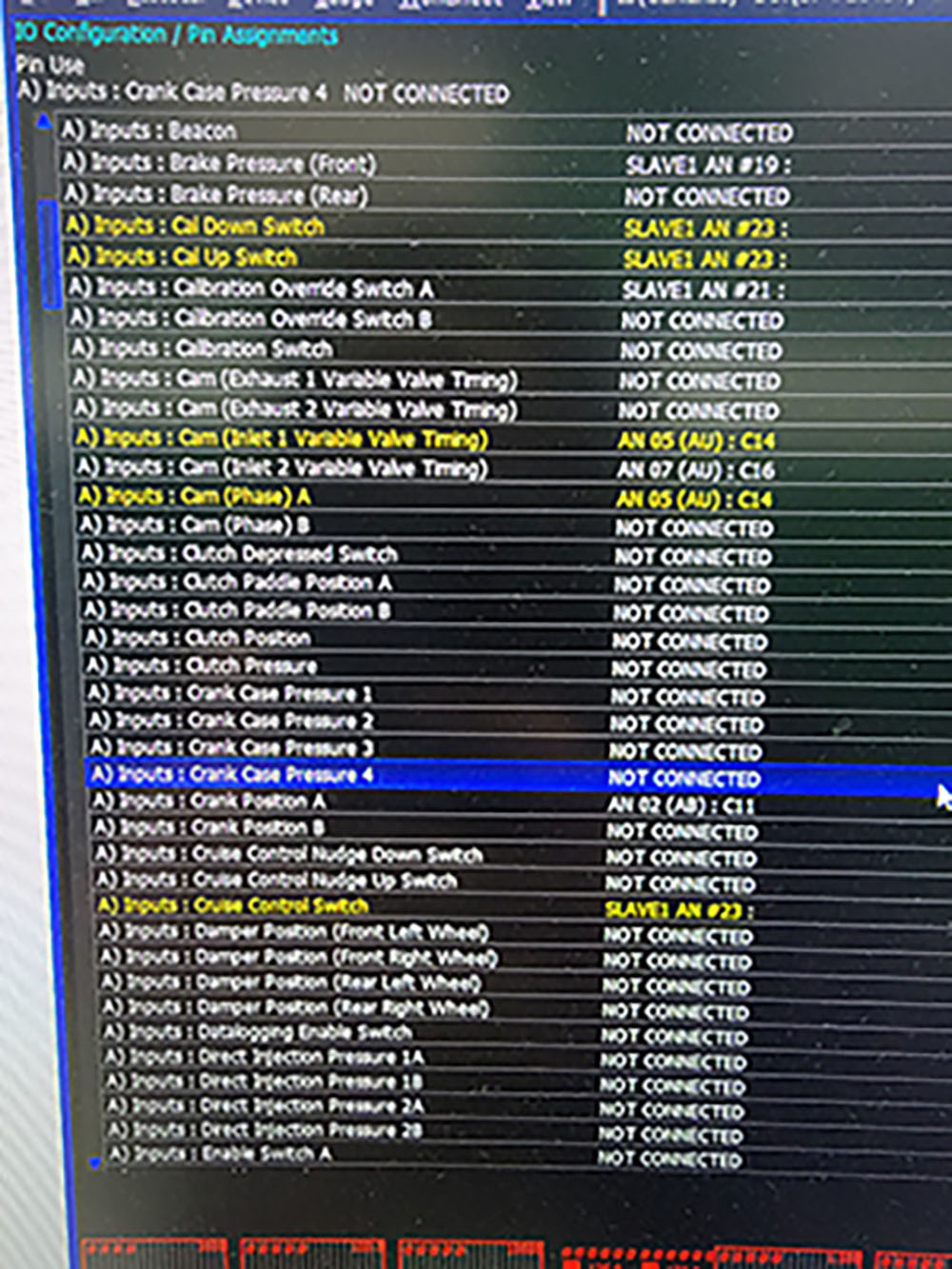

So you're right yellow is signifying double assignment. So i have a few things that are double assigned. I definitely did not change any pin assignments, and have just been running this how it shipped out of the box being a plug and play kit. I have double checked assignments with the Syvecs manual pinout. Crank sensor is assigned correctly to AN02. And cam is supposed to be AN05. I am leaning on the fact that the Cam (Inlet Variable Valve Timing) is not supposed to be assigned at all as i don't see it depicted in the manual. There are two other outputs for variable valve timing. (FUEL15:A24, and FUEL16:A25) which are correct.
Seems beyond strange, but could the ecu have reassigned pins while it was running? I doubt i could have fat fingered a shortcut that would have caused this...

Crank is fine, not doubled up
Cam looks ok too seeing as it's used for main cam sensor and the VVT aspect. If the ecu was not happy with it, it would be reporting a problem in the messages in the bottom right.

And no, there is no way the assignments will have changed themselves whilst driving. They all require manual device/programming which involves a brief engine kill for this to happen

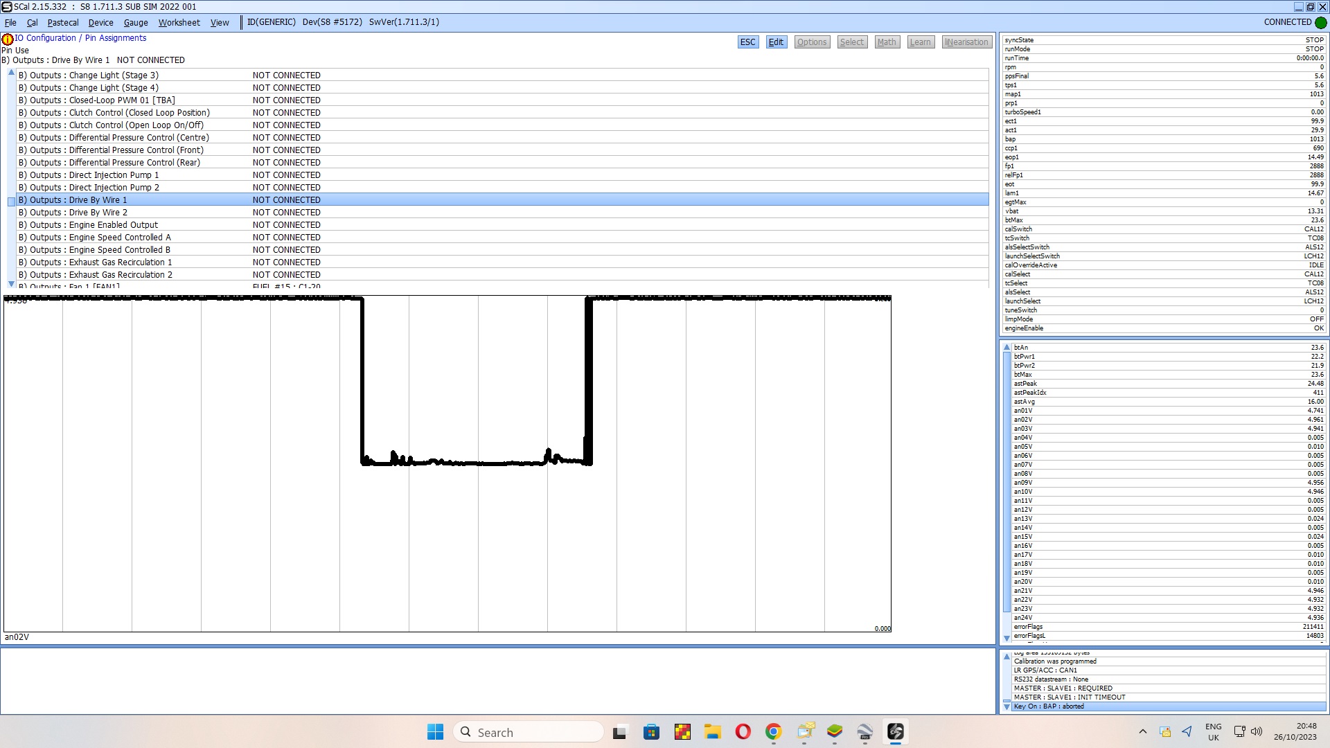

No matter what i do i cant get the syncscope to show live data. No matter if i click cranking or live. Nothing new is appearing in the log. I don't have any errors either. The syncstate remains in STOP and doesn't switch to TURN. Still seeing no feedback from AN02. I have checked the wiring and connector and all look fine. When i unplug the sensor and crank i get the exact same voltage reading of 4.961 constant, same as when its plugged in. I am going on the premise that the sensor has simply failed internally. The car is a 2007, original sensor.

As said before, either short the two sensor wires together and see what AN02V does on the trace, or apply 5v to the signal wire. DO NOT apply 5v to the sensor ground wire.
That will at least prove continuity of wiring to the ecu.
Sitting open circuit it will be close to 5v on AN02V.
If you short the two together, it will drop to around 2.5v on the trace. This will prove your wiring is intact, and of course that the ecu input is working too.
I've just done it sitting on a bench test here on an S8. That's with AN02 configured as bipolar as it would be for a VR sensor as your trace appears to be
Re: Porsche 997 Turbo - Engine stopped while highway tuning
voltage high, nothing connected
voltage mid way, the two pints shorted together, AN02 to sensor ground. Then release again
