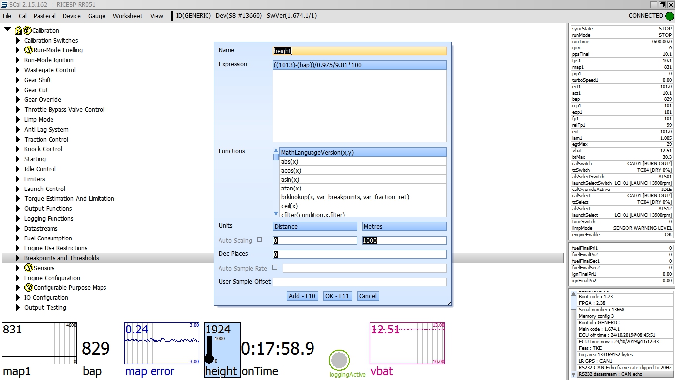

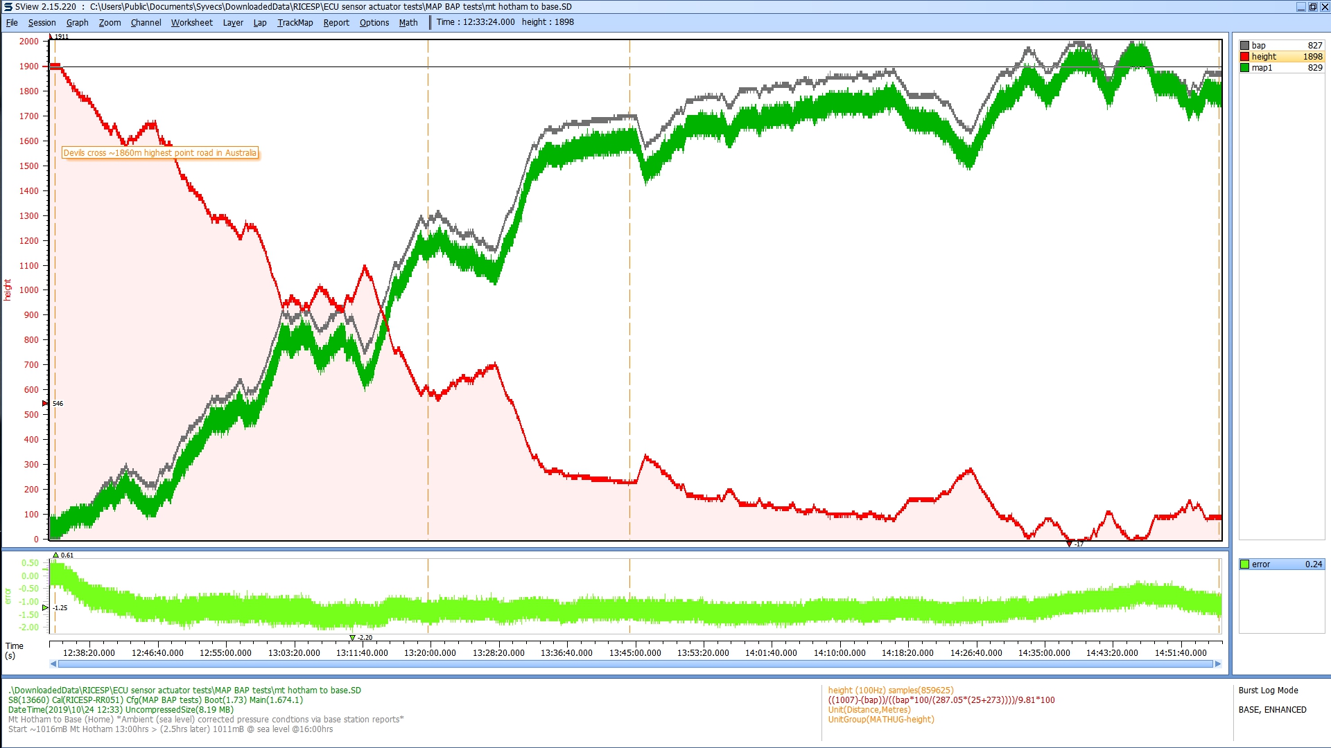

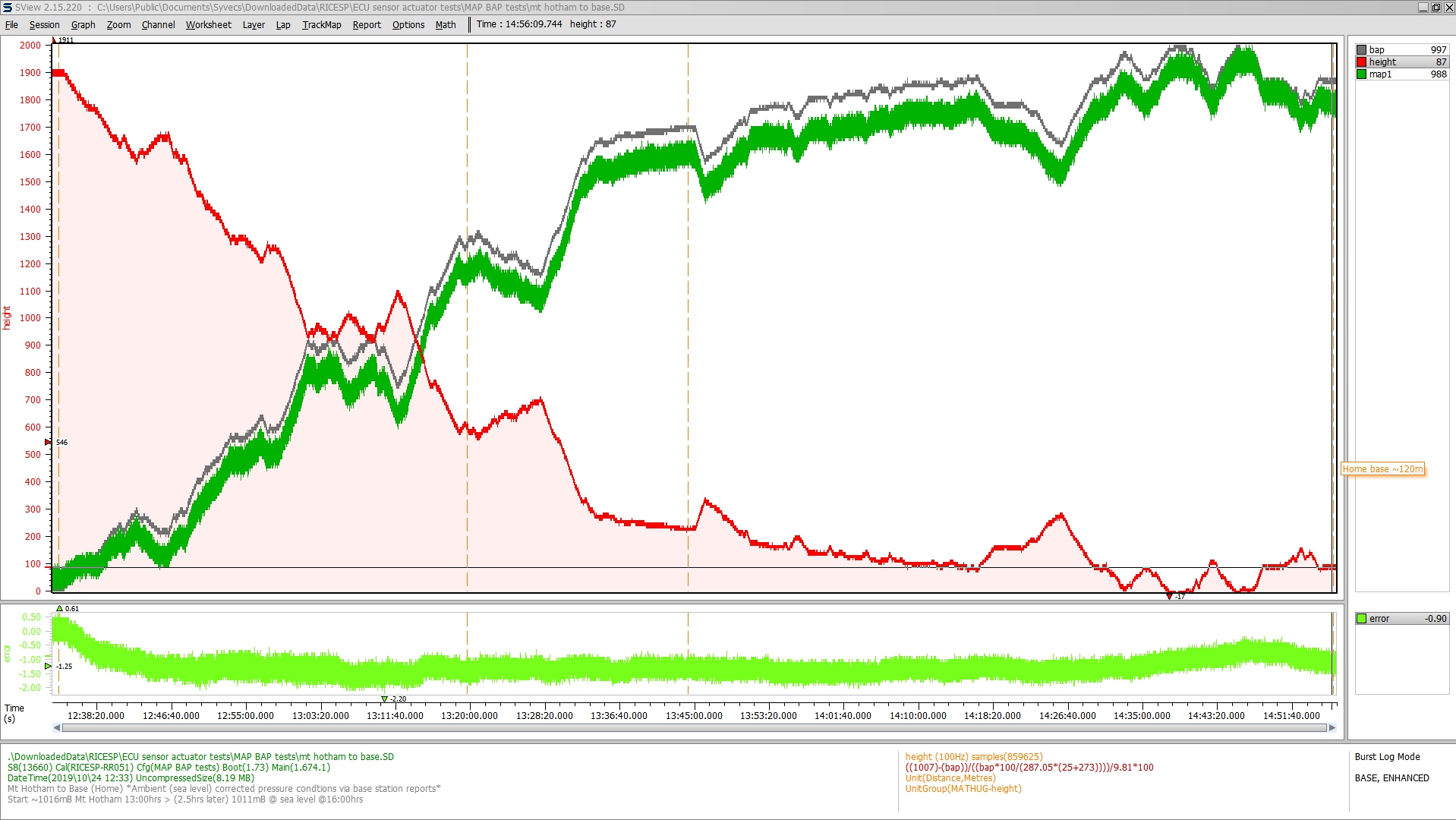

and yes I have driven from sea level to 1850m in two hours to check these things and derive my own altitude to height formula

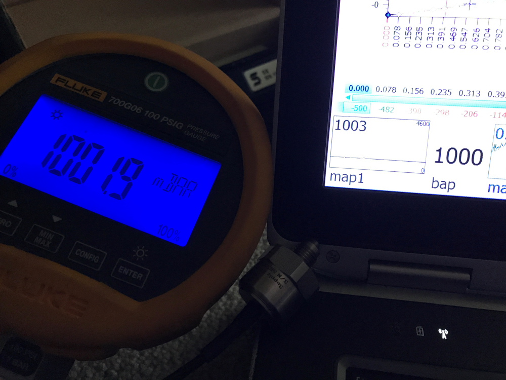

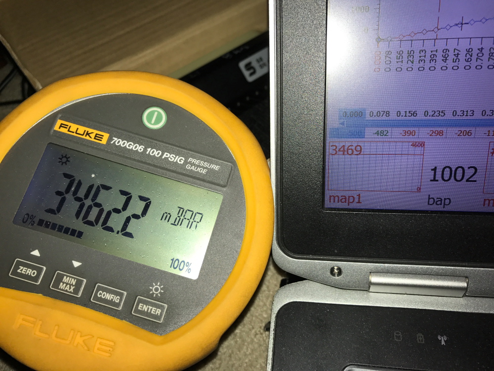

if you have nothing else a penis pump and a reference gauge will suffice as I use to do a long time ago below
