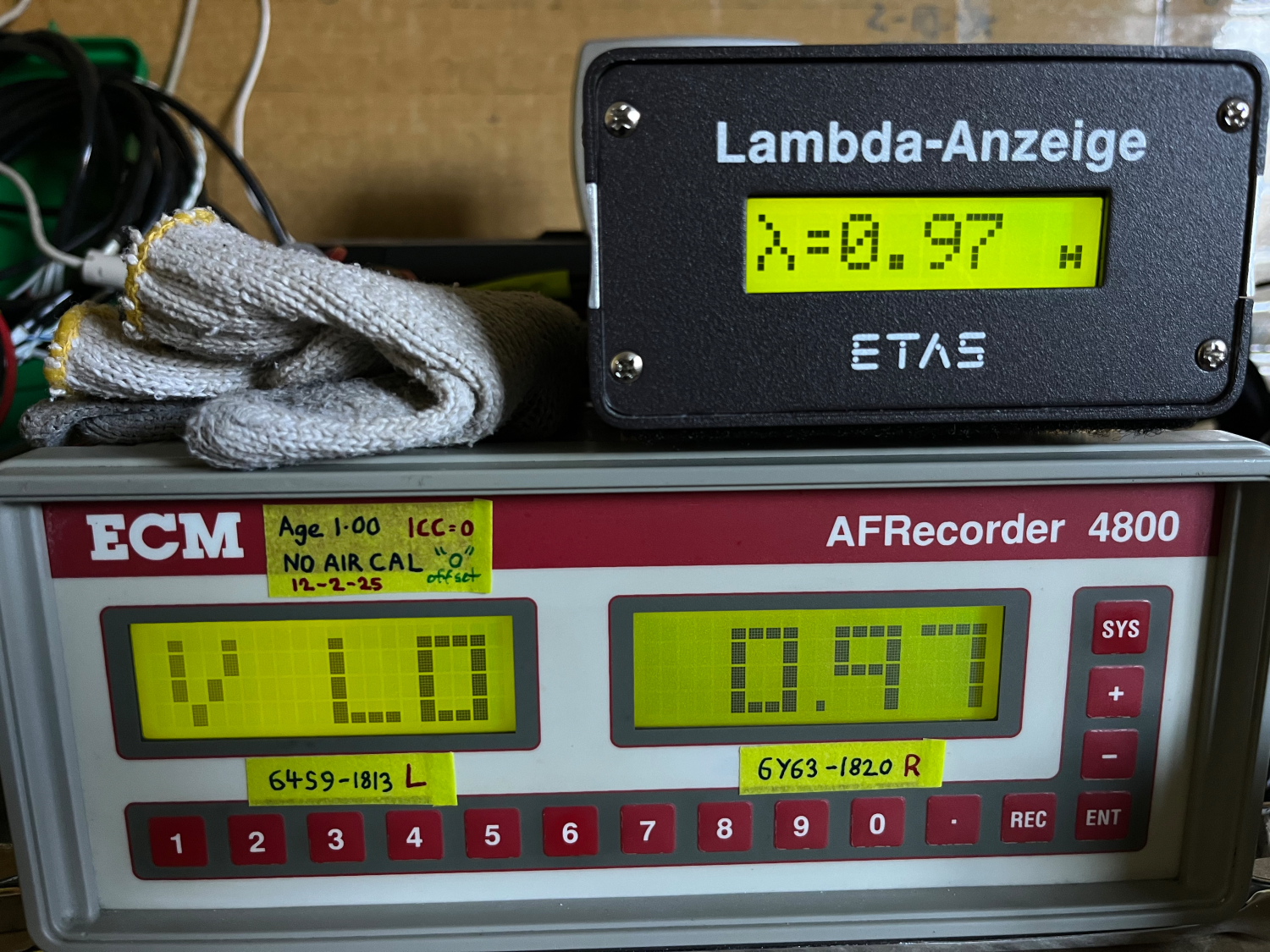

ECM 4800P (on left)
ECM AFM1000D (on right)

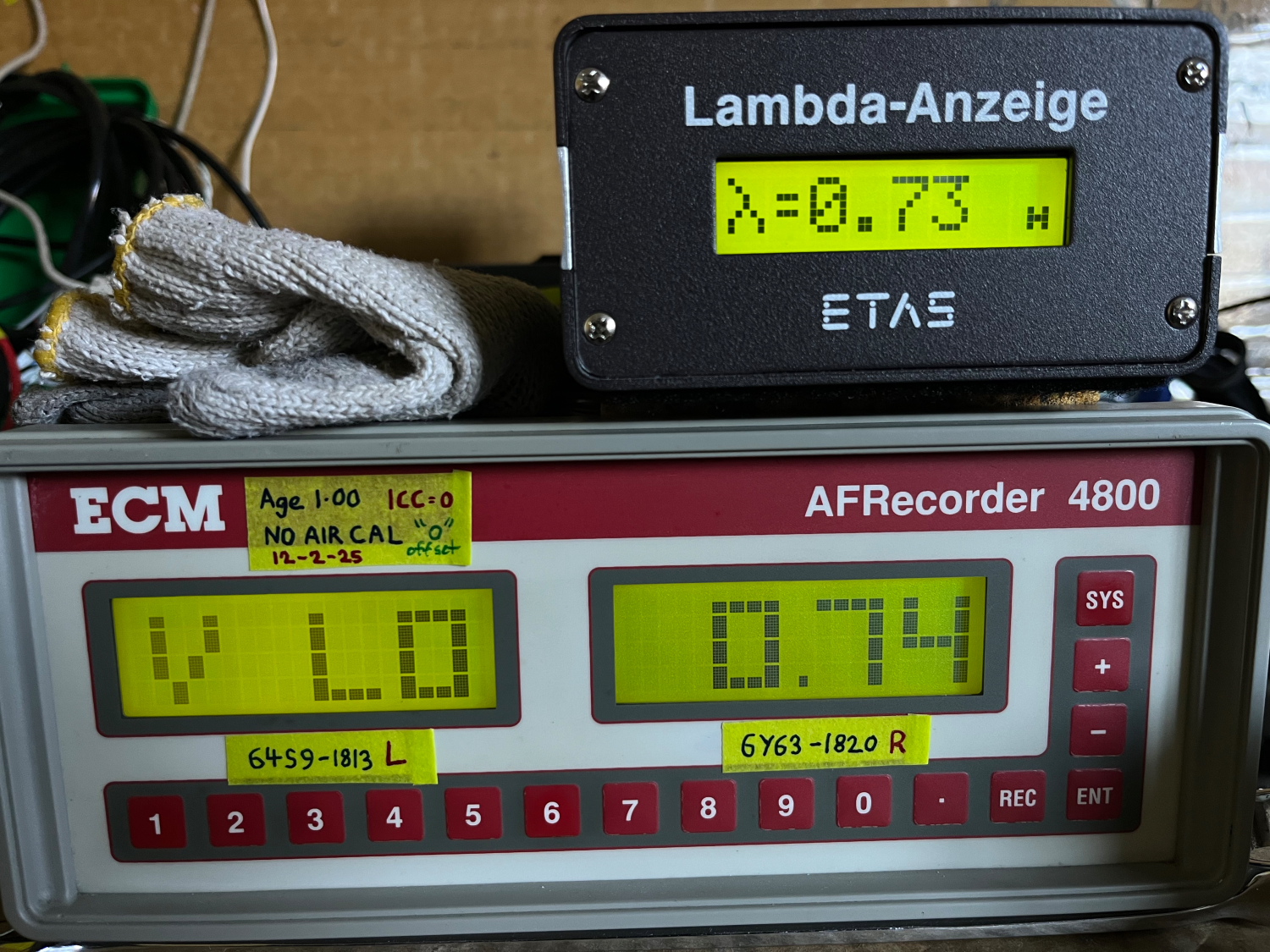

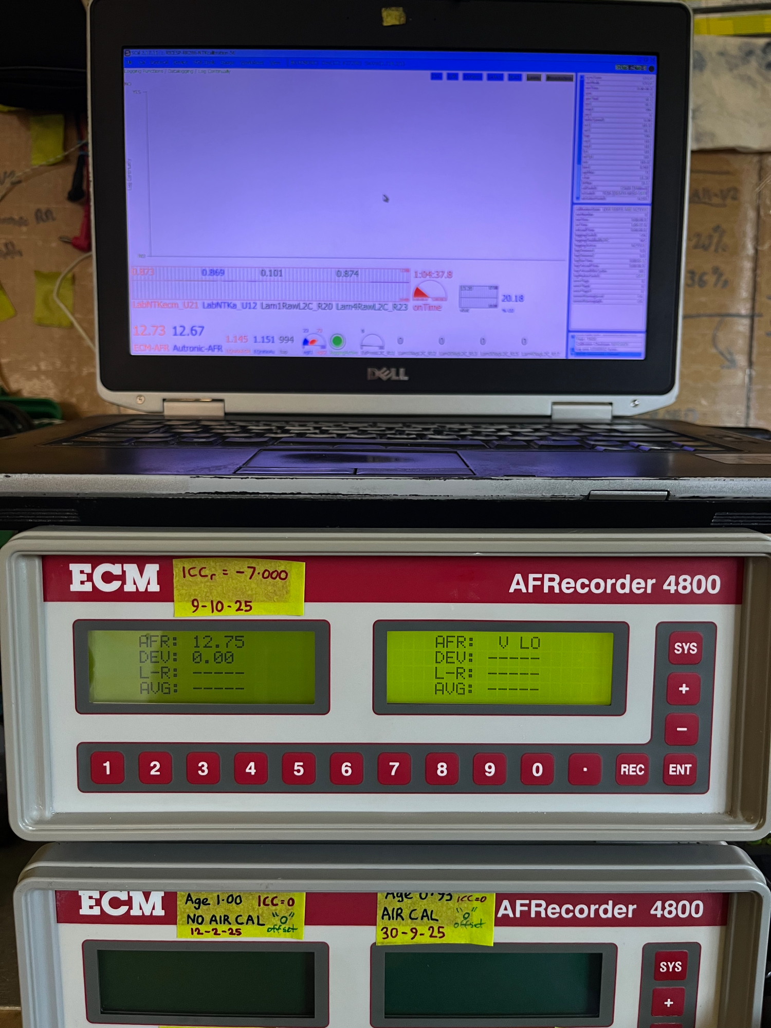

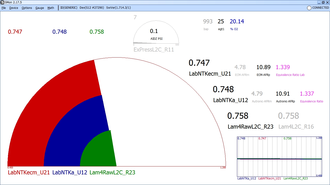

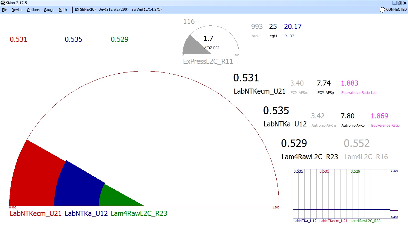

same (new) sensor into both unitz........... gave different readingz
refit old used sensor totally different (reports below)
all set up as per instruction - no indicated fault on either sensor
was going to try another new sensor but seen enough and packed it up to return to customer :)

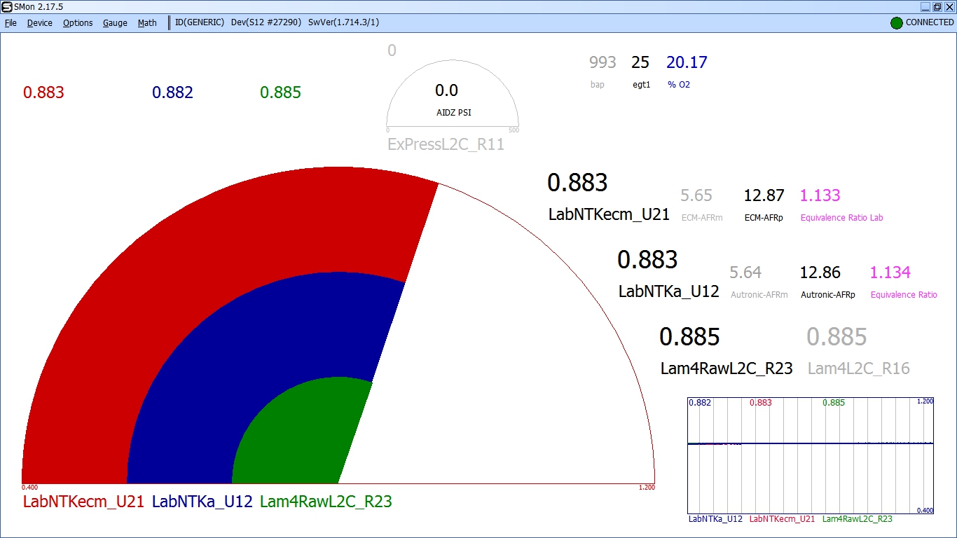

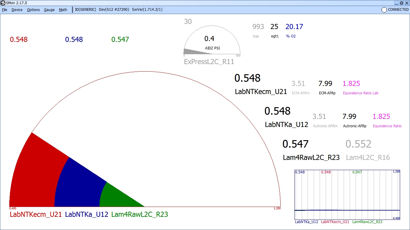

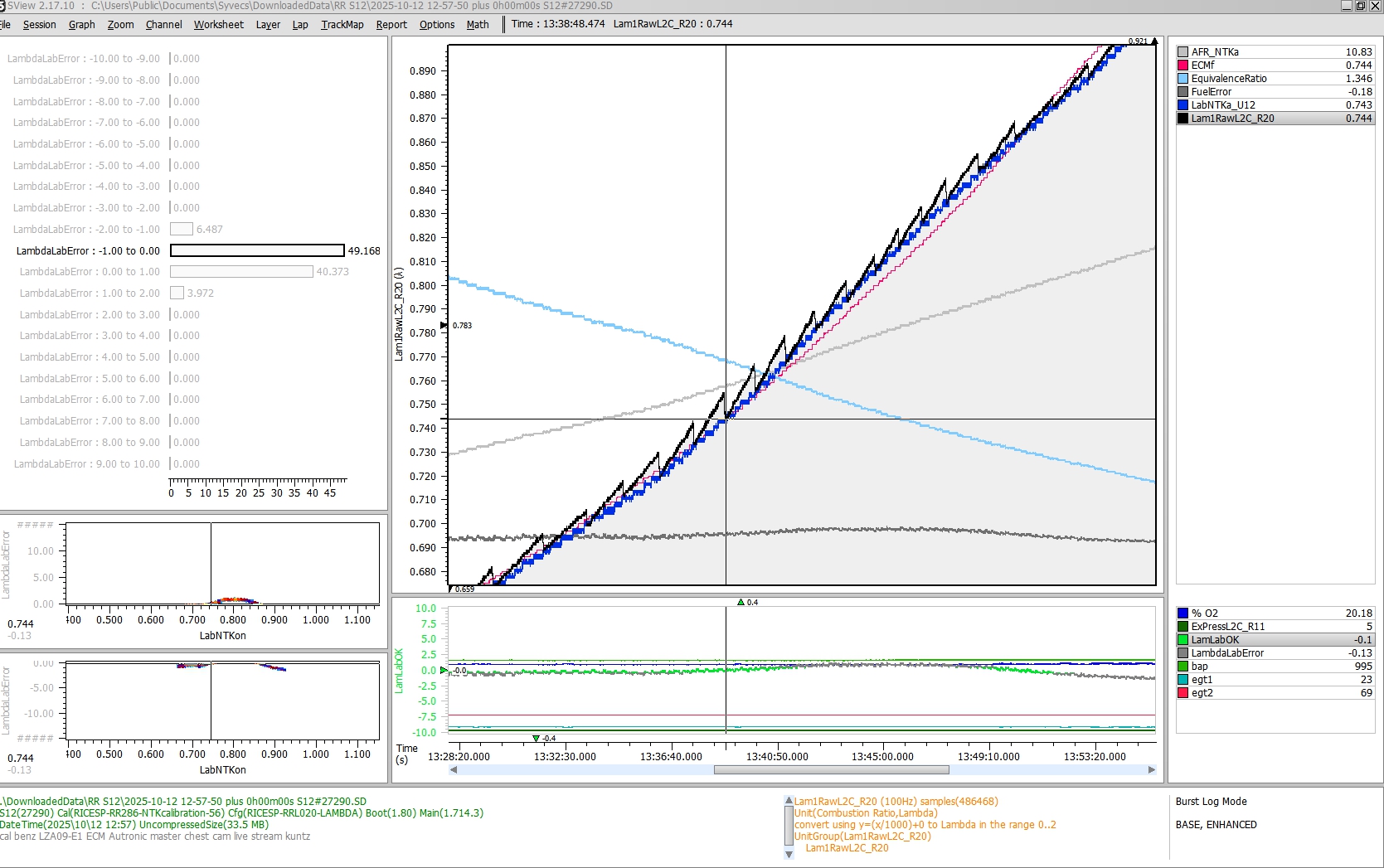

My std report format which shows clearly the errors in common use ranges, full rich its basically fake newz

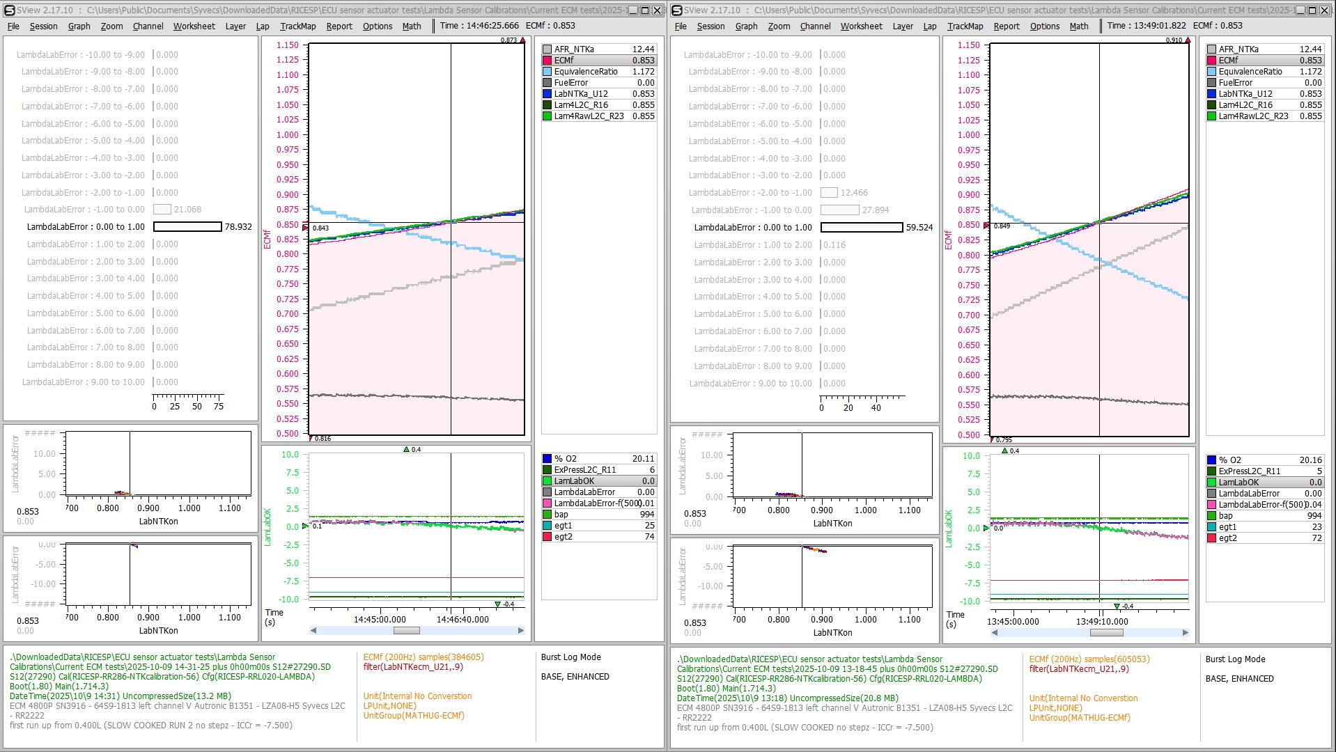

same sensor tested over two different days
and my new sensor fitted to the AFM1000D V it running on my 4800P

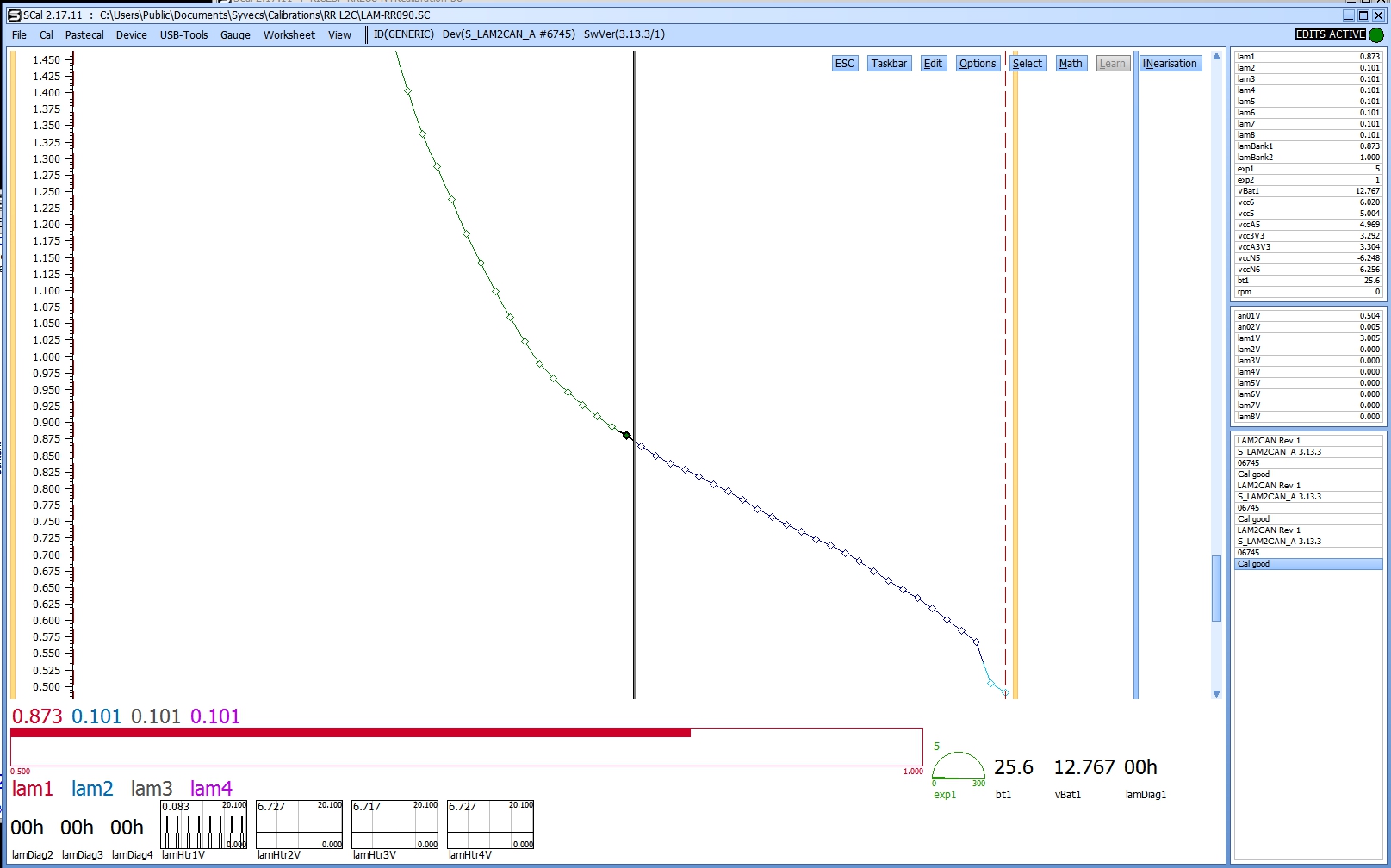

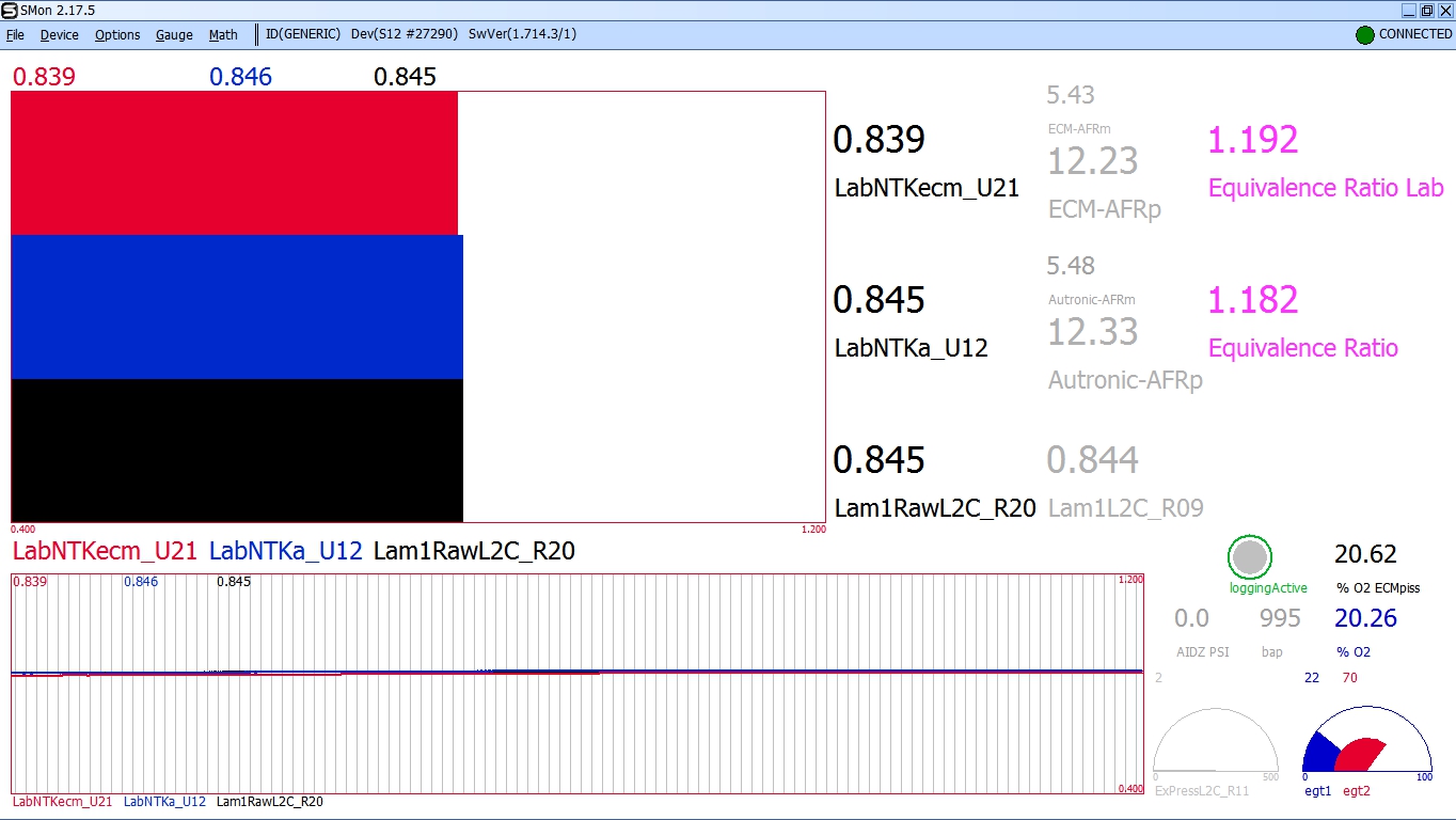

How good is the syvecs lambda to can 8 channel unit?
when fitted with a RR calibrated sensor its the don, especially when you factor in that one of the largest sources of error is the pressure that ALWAYS!!!!! exists in the exhaust system of every car.
