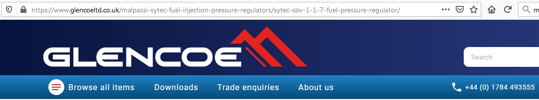

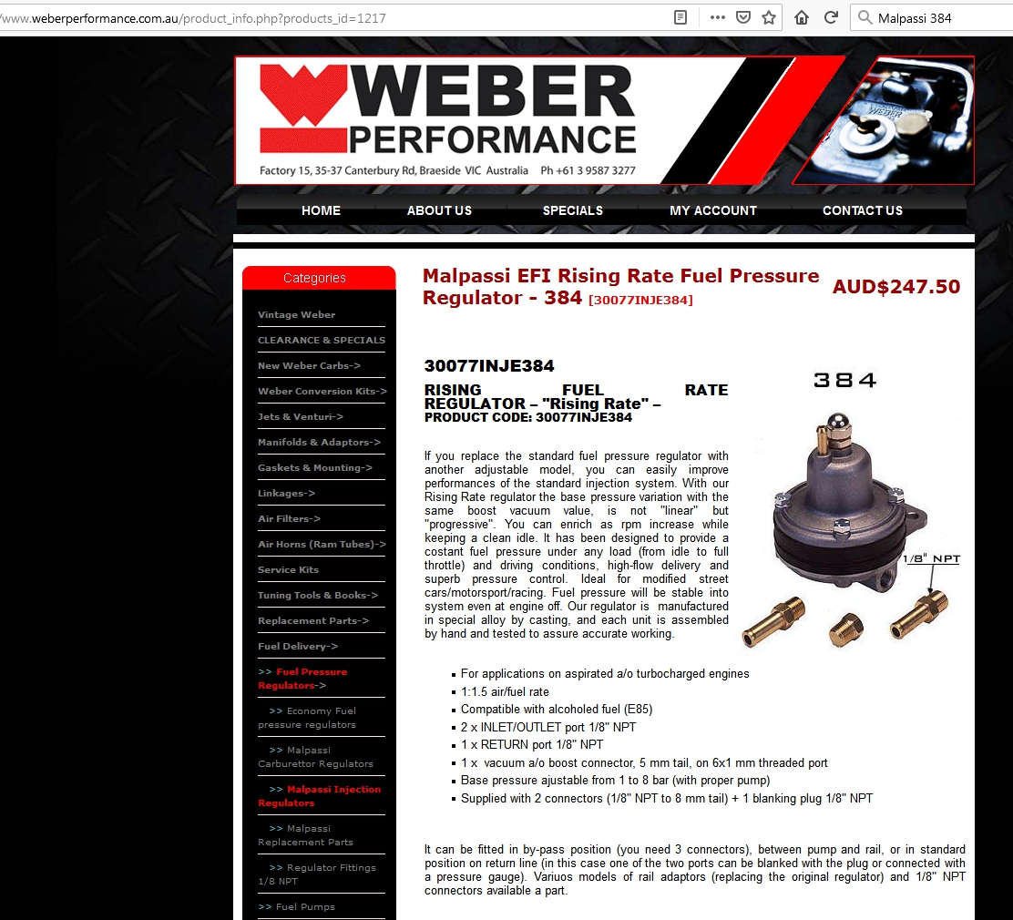

I am pretty easy going, been dragged by the nose over this for weeks nothing from them at all admitting they stuffed up. A mate of mine in UK ordered another 1.7:1 and tore it down (this is a Malpassi unit) and its as different as you can imagine internally, single disk, different configuration on bottom assembly, inverted disk orientation, you get the idea.
So I say I will just send him a link after he says I should have contacted them to supply the right part :roll: cause their own web site listed it as 1.7:1 then they told me on email it was 1.7:1 and been supply for years and I am the first one ever to report otherwise (that old classic) last thing I wanted to be doing is wasting my time on FPR testing :lol: Anyway I digress, go to look on their site https://www.glencoeltd.co.uk/malpassi-s ... regulator/ just now to send to my friend and just like that "it gone" :lol: but they are still all over ebay so took a few happy snaps for history sake ;)
Moral is Stevie not so much that they look cheap but I guess I had to prove the function of it. The principle has merits, just need a unit that does the rising rate as per the advice and all will be good. Will get some of the right part number to test no doubt, don't think it will come from these people at a guess............
Just putting this here for others information cause I guess in time there will still be some kicking about or being sold on E-Bay, just don't get it expecting that it will be a 1.7:1 enrichment rate, hope this helps.

Re: Port Injection Fuel Pressure Regulators

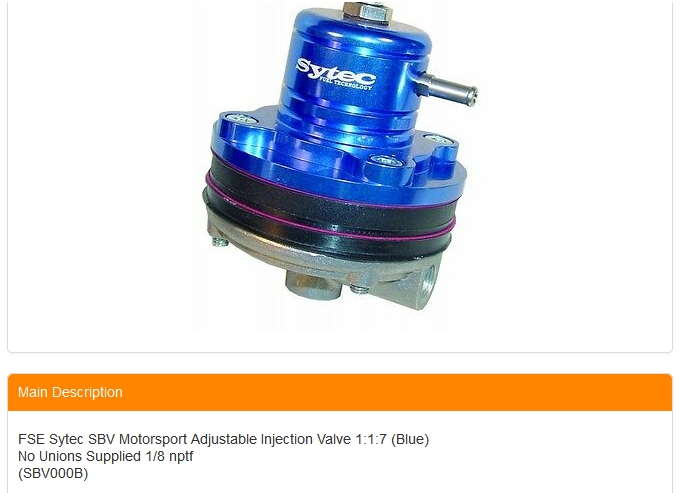

The advert says 1:1:7 whatever that even means.
I think some early adverts said it responded 1.7x faster. There were lots of advertising over the years, but other than n/a cars, I don't think I ever actually used one, and I never measured fuel pressure with one.

stevieturbo wrote: Sun Mar 21, 2021 1:16 pm The advert says 1:1:7 whatever that even means.

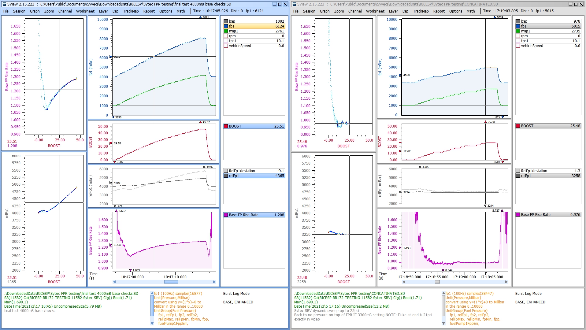

Boxes for the Sytec SBV units I have are printed 1.7:1, you can image my shock when they tested at 0.97:1 once on boost :lol:
They are talking about rate of rise
IE: 20psi gauge boost would give (20*1.7) = 34psi increase in fuel pressure
But is it a flat rate of rise or even increasing rate of rise, when does it happen, all of these details are sadly lacking from the current crop of vendors/makers as I am finding out. Does it apply in Vacuum? is that flat or curved? I have found out on the as delivered unit and the RR enhanced versions which work pretty much what I think is a good fit. There are many permutations though.
The way I have it currently is a almost identical to what you see on a large cam driven mechanical fuel pump fitted to a high power density single turbo drag type engine. They roughly give a 1.3:1 rising rate at ~50psi gauge boost 8000rpm (rises based on engine speed in this case), the (un) intended? benefits of this are many like an effective variable injector size based on power demand.

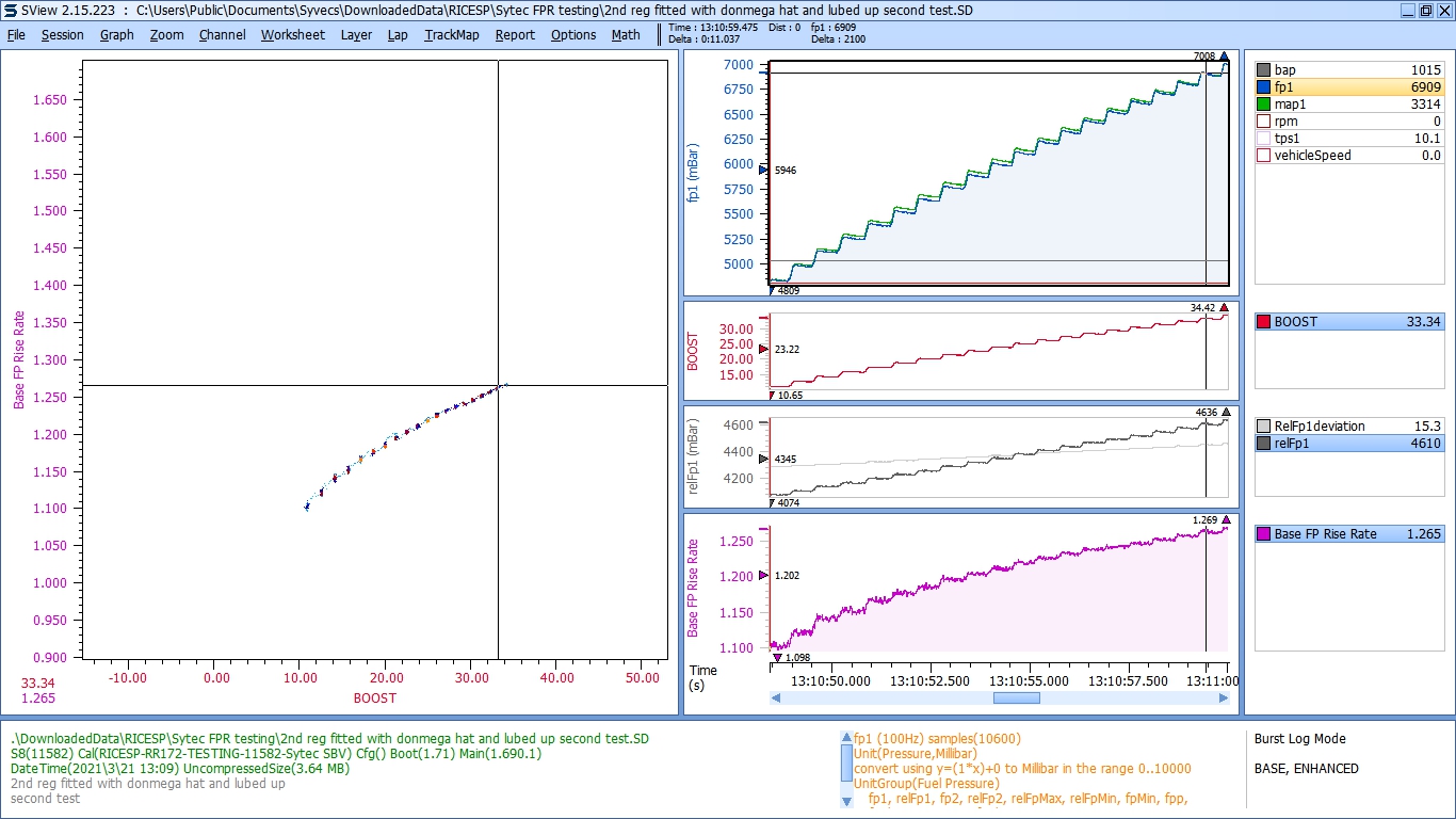

My 'gut' feeling is that all of these in stock form maybe are only applying a rising rate in vacuum, and on boost are 1:1 (or there abouts)
See the original test (on boost) clearly 1:1 rate, in video I show its only rate change happens in vacuum region, maybe this is what they intended? wont know till I get other models and test them an plot the curves.
25psi 1 to 1 V 1.2 to 1 YO.jpg (910.14 KiB) Viewed 85820 times
Here is a close up of my modified reg, very smooth in response to step changes, and is true rising rate in boost, picked normal levels of boost people use typically as example range.
10psi to 33psi don.jpg (434.44 KiB) Viewed 85820 times

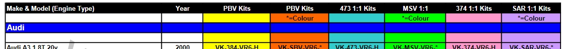

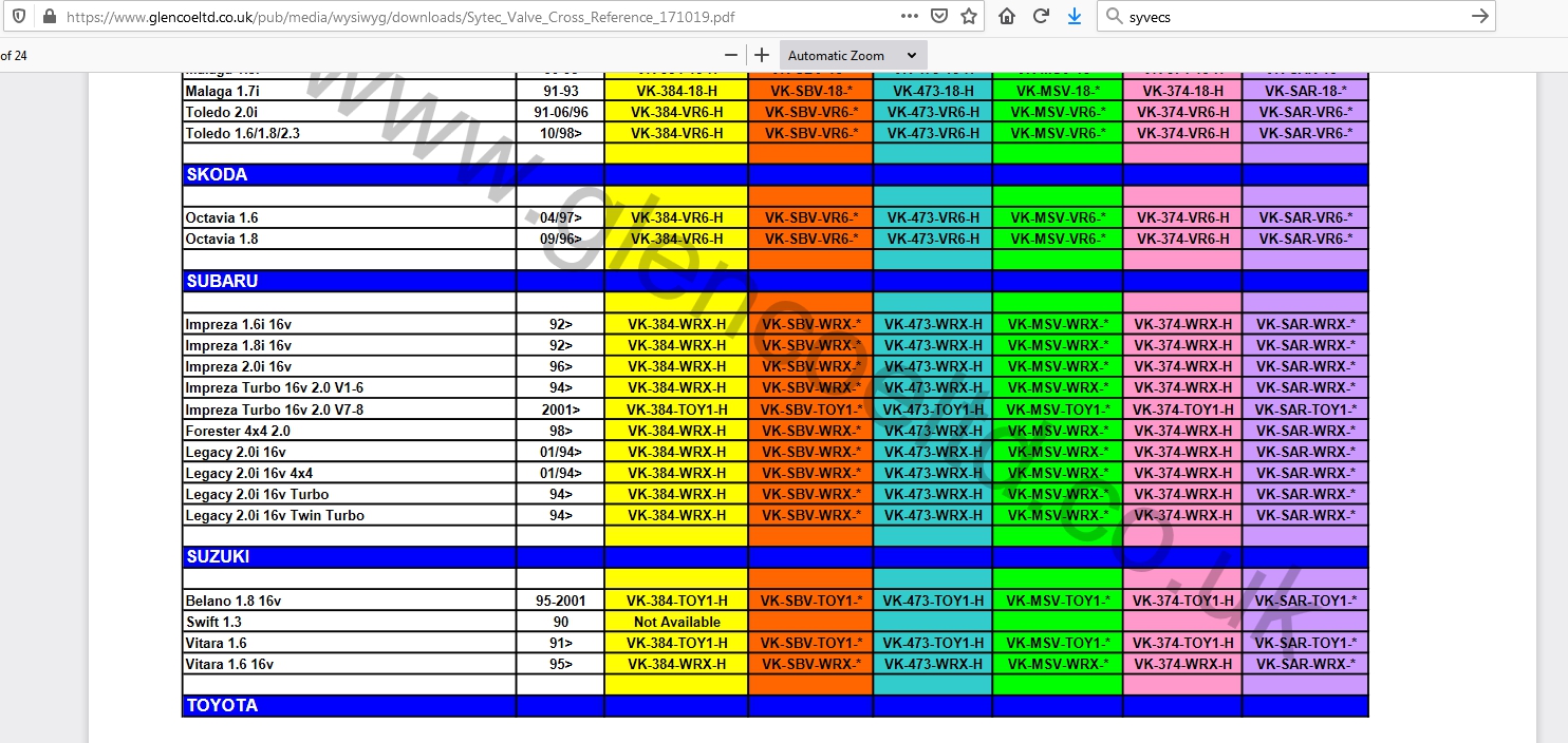

My friend I was telling you about who told me I should have rang them to get the right part (lol) seems like he has the wrong part as well !
https://www.glencoeltd.co.uk/pub/media/ ... 171019.pdf
Regulator 1 2021.JPG (109.05 KiB) Viewed 85786 times
FYI a "power boost valve 384" and Sytec "SBV" is the same shit only difference is a changed top hat some longer bolts and nuts on bottom to hold it together all else is identical, listed as 1.7:1 rising rate :lol: which we know is bullshit cause I tested two of them and they showed 0.97:1 rate in boost.

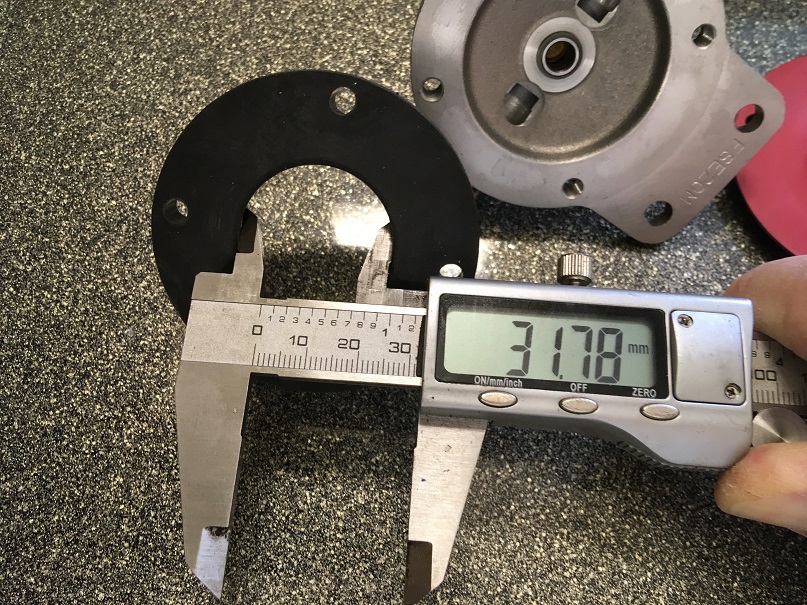

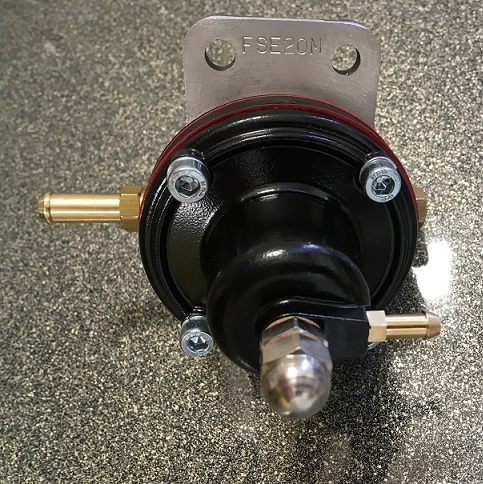

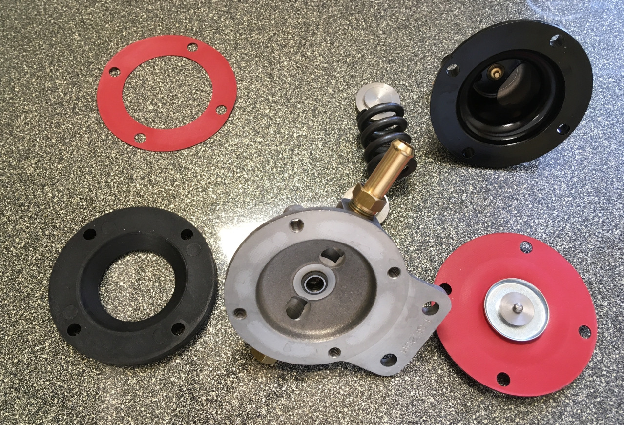

Here is what my mate ordered pulled down.
Little technical explanation there is no way in hell it can be a rising rate in boost cause as assembled the larger area of the disk points down and matched the area size on the fuel chamber side so any imparted force cancels out the fuel side, there is no multiple so indeed it will be 1:1 (as they list on their own PDF) but they still sold it to him as a 1.7:1?????????
Stevie is seems was right about this company :lol: lucky for me I made my own after working it out myself with zero help from them or Malpassi :roll:

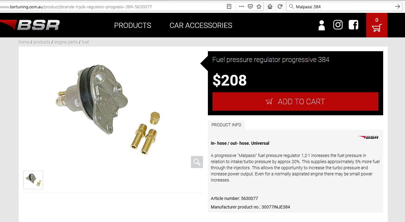

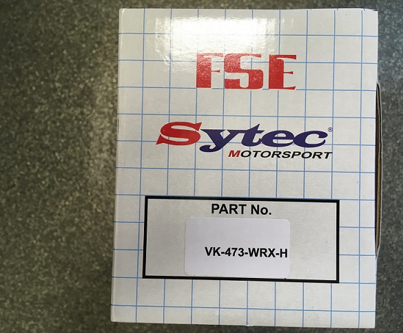

Some more comedy gold below
384 type is not 1.5:1 or 1.7:1 (or 1.2:1 in one ad)...... just pick a number out of thin air and sell it lol
473 type is 1:1 not 1.7:1
