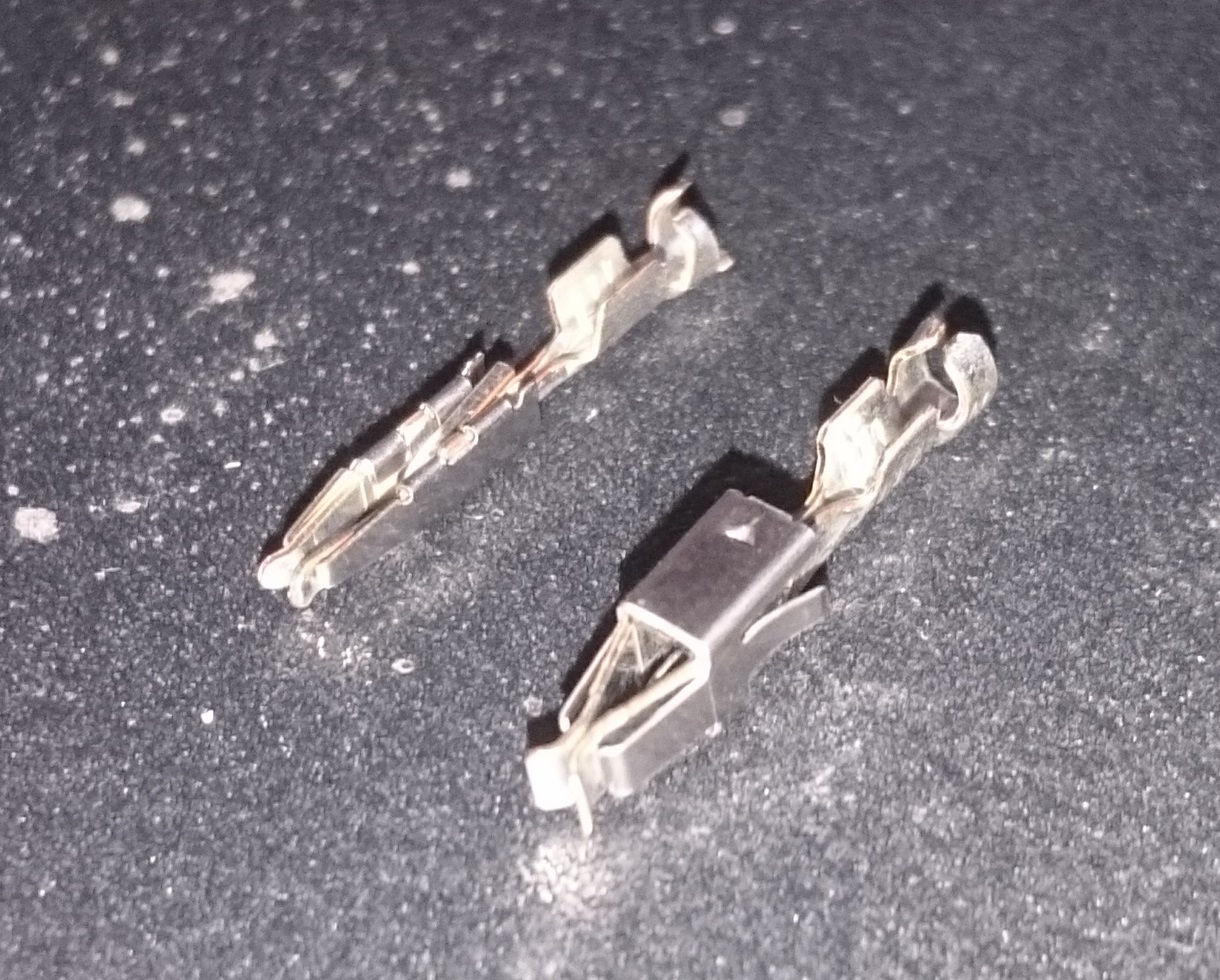

- S8 Pins.jpg (430.92 KiB) Viewed 34289 times

S8 uses microtimer terminal as per Stevie's photo. S6 uses microtimer II (or can be III I believe) terminal.

TimH wrote:S8 uses microtimer terminal as per Stevie's photo. S6 uses microtimer II (or can be III I believe) terminal.

Once you have the terminal block (the cream-coloured part) separated from the black cover, there is a portion of the block that slides to one side by a few mm. You need to do this to either extract terminals (still needs a tool) or insert them. It's part of the slightly wider section of the housing.

If you pop the entire white section out of the black housing, you can release without any special tools...
But bare in mind you're effectively releasing all the pins, so make sure none move that you dont want to move !! lol
