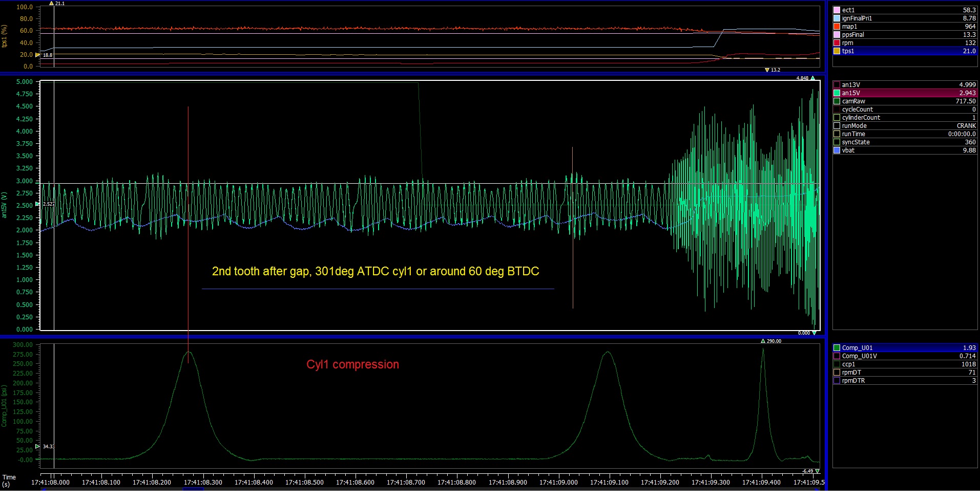

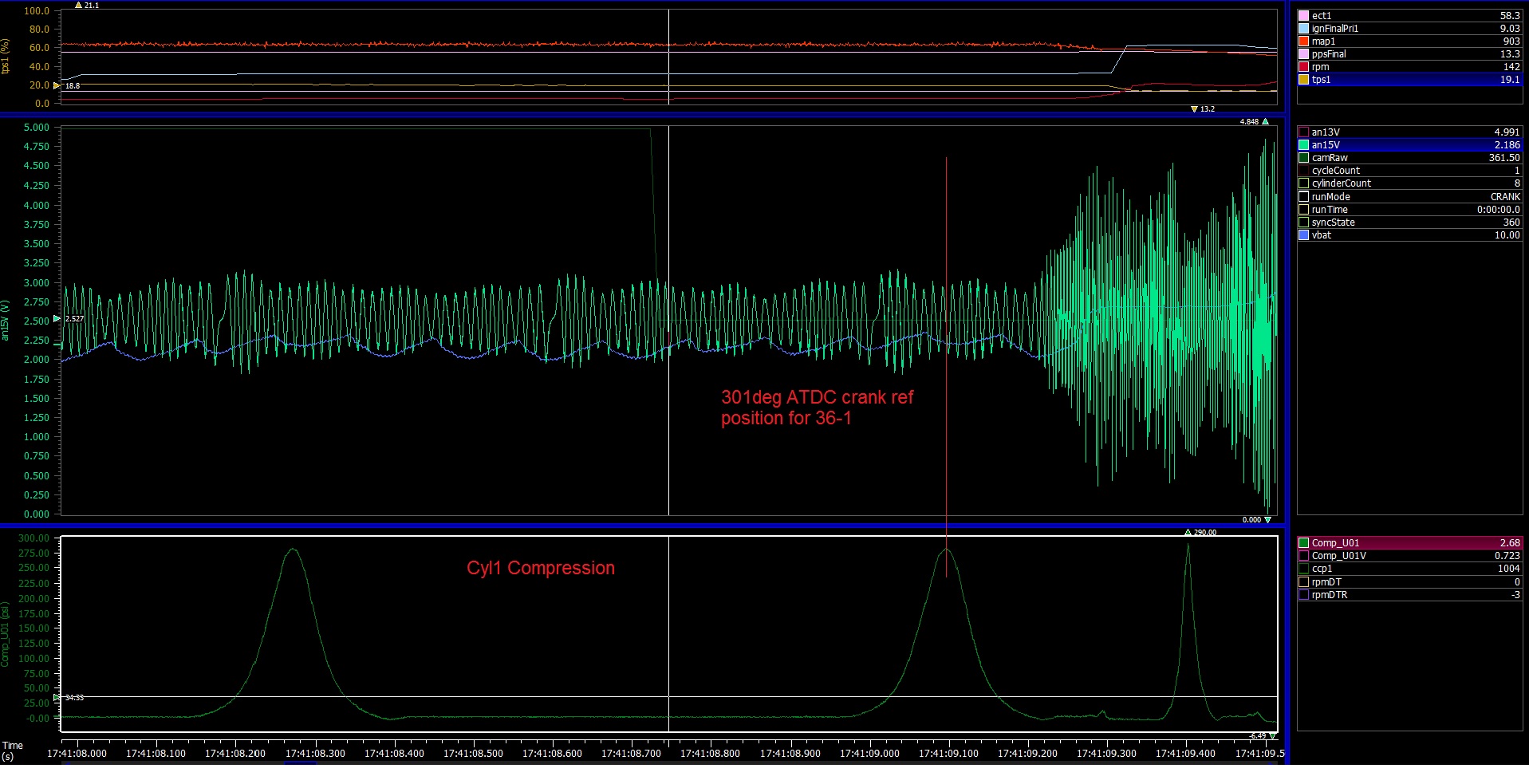

Timing references are setup after TDC in Scal, so factor that in. Some ecu's do seem fussy about where the gap is etc, but have never heard any Syvecs info to say it's a concern.Trickster wrote: Wed Aug 28, 2019 12:44 pm I am trying to get this right first time around.
My sensor is roughly fitted 135 degrees before TDC
Does the gap have to go 90 degrees after the sensor when the engine is at TDC?
I have a 4 cylinder engine, and I thought the gap should be away from any timing events, I will have a cylinder firing every 180 degrees of crank rotation so as long as I have say 5 teeth either side of the sensor at TDC that's 100 degrees leaving 80 degrees of space the gap can be in or does it have to be accurately 90 degrees?
And in scal, you set the reference tooth to the 2nd tooth from the gap?
Or am I getting this totally wrong? Haha
Thanks
Graeme
36-2 is becoming more popular where the gap becomes more defined though.
This is mine for a visual reference, 36-1, with the DTA this had a tooth ref of 67 deg BTDC for the first full tooth after the gap.
Same setup on my Syvecs I have it around 301.5degATDC, using the second tooth after the gap as the reference.
As graph shows, cyl1 compression is on the bottom graph to show you where TDC occurs, relative to tooth count. If we could overlay a 720 graph on View...would could examine the various events much easier. But we cant lol ( and I've asked )

Re: 36-1 Trigger wheel fitting
edit, notations on my first pic pic probably didnt make so much sense, so have amended it here
