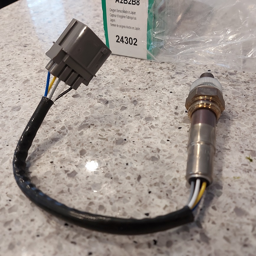

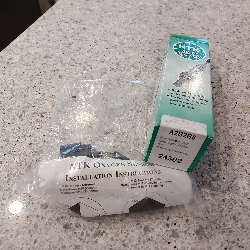

I have a spare brand new sensor sitting on my shelf. Part number is 24302 which I don't think is the L2H2 and not sure if that would even work with the Syvecs. I believe the L2H2 is a 24300 part number.
Thank you for your reply and help.
Re: Wiring in S6 GP
Sometimes it can be the same sensor, slightly different numbers might just be a longer wiring harness or connector or something.
But if the plug is the same, the colours are the same, the colour locations are the same....it may well be the same.
The 24300 seems to relate to older cars, so might claim to be the L1H1 replacement ? even though they havent really existed for years...and were different colours. The NTK site just seems to show the wire itself just being slightly different...so the 24302 probably is the L2H2 ok, the more expensive one the L1H1 replacement, even if it isnt really a replacement

The links didn't work but if I'm understanding what you're saying correctly, the sensor I have (pictured) would work and is potentially a L2H2 sensor?

The links do work,
But it may or may not be the same...Safest is to buy the correct one known to work.
