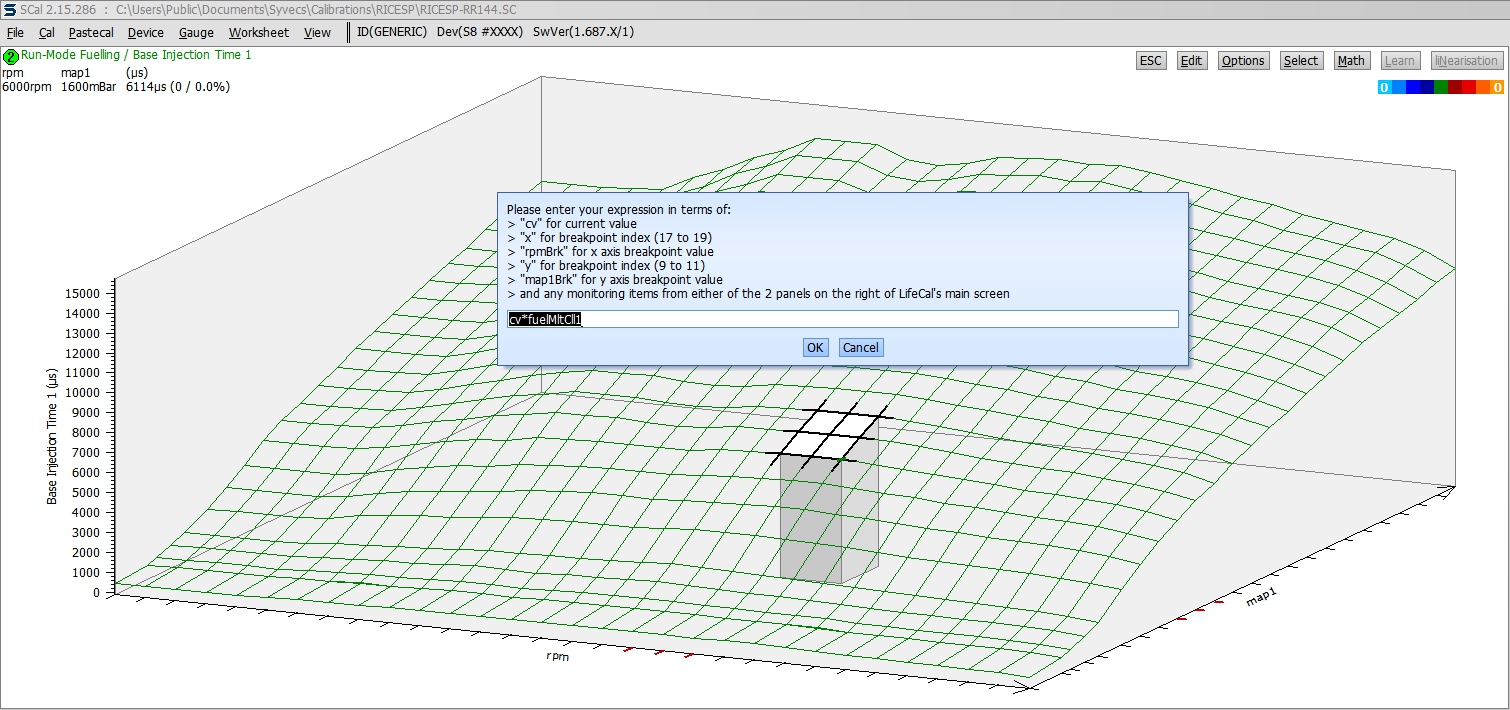

So for tuning live on dyno, be really fast to hit a key and have the base fuel cell auto adjusted rather than using incrementing or hard type in of a figure as per Motec "quick lambda".
Re: Auto Adjust Base Fuel cell w/Closed Loop Fuel Multiplier
rac wrote: Tue Nov 17, 2020 9:52 am So for tuning live on dyno, be really fast to hit a key and have the base fuel cell auto adjusted rather than using incrementing or hard type in of a figure as per Motec "quick lambda".
All ready exists mate.
Press F10 key and type in your maths expression your want to execute on each F10 key press, as below. Simple.

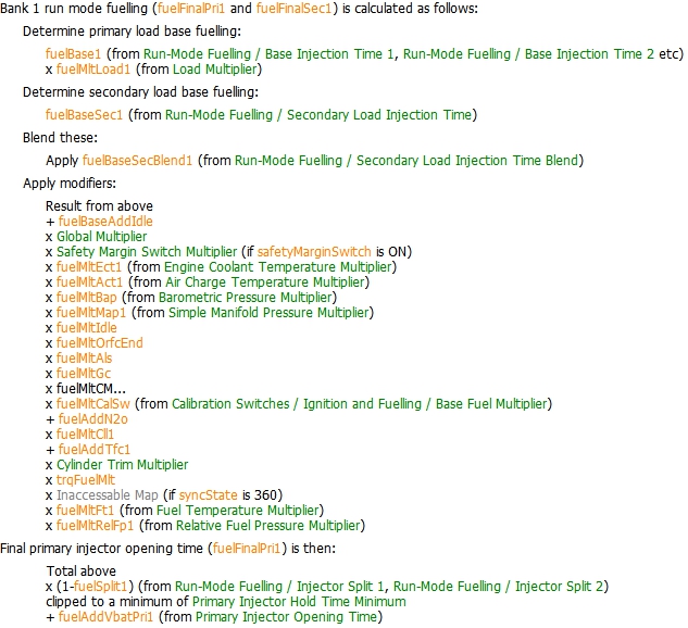

Can this be used to alter fueladdvbat correctly?
secure wrote: Fri Nov 20, 2020 5:34 pm Can this be used to alter fueladdvbat correctly?
Short answer = NO
Reason is look how the fuel final time is made up (under modifiers).
